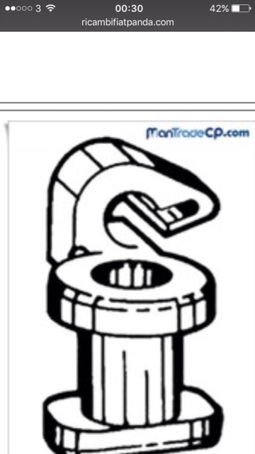

Unfortunately no. The red circular ones shown in FDNY21's photo is the best image to demonstrate what they're like. They're available with circular or square exposed heads (the bit you can see) whilst the rest of the 'plug' is behind the steel door.

here, they are out of stock at parts world - but there is the part number - 4484838
http://www.ebay.co.uk/itm/Pack-Of-F...-Pocket-Retaining-Clips-4484838-/271512494676
EDIT: These style of square retainers are not uncommon on lots of cars - has anyone measure the size of the hole?
8mm and 8.5mm ones seem to be the easy to find common sizes...
these are 8mm ones

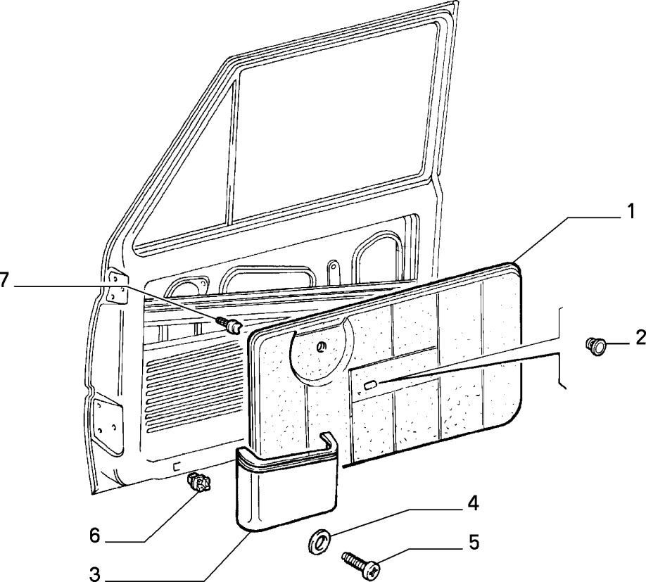

Firstly, many thanks to FDNY21, lukmek and blu73 for all your assistance; it's all been beneficial.(y) I still, despite many attempts, don't know how to send a 'thanks' rating to members that I see on members' posts. I'm sure it's easy and probably staring me in the face. :bang:
I only need four of them. I measured the square holes in the door and they're 9mm, possibly 10mm (due to paint thickness) so I know now what to be getting, pity Partsworld is out of them but ebay looks like the next port of call.

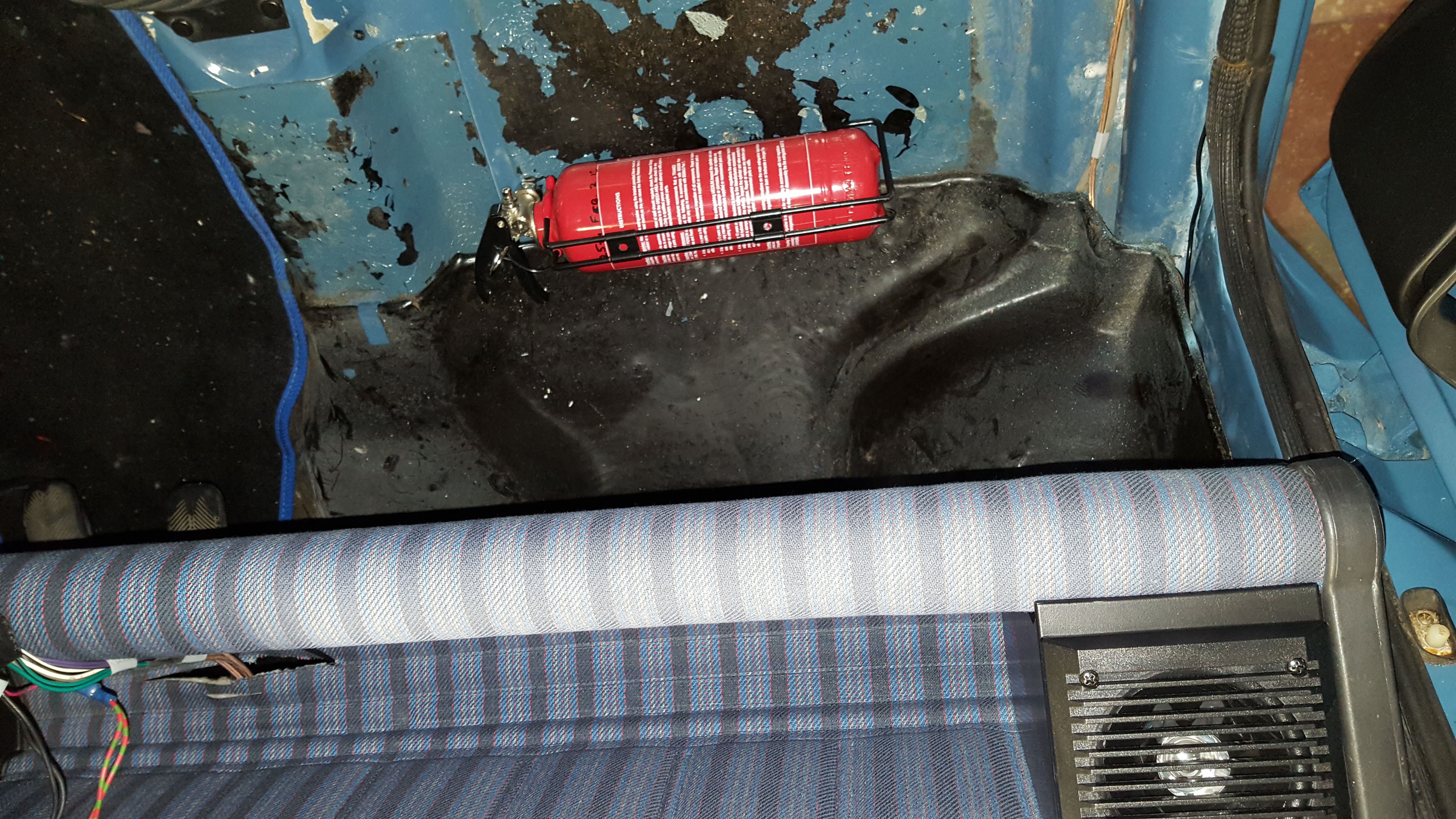

I recently obtained a fire extinguisher and I was wondering where would be the best place to mount it. I tried to mount it under the front of the seat but it ended up pushing up the seat adjuster, so right now it is mounted under the rear of the passenger seat. It works really well actually! Perfect in fact, until I sat in the back and put the chair back down and realised that it was crushing my toes. Back to the drawing board, but seeing as how I rarely take more than one or two other people at most, it will be fine for now... if anyone gets any ideas, let me know, but I wouldn't like to drill any holes :p

Believe it or not I'm looking to install an extinguisher too. I haven't got it yet but I plan to fit it behind the fabric dashboard on the passenger side, with the bracket self-tap screwed into the underside of the flat (table top like) section of the bulkhead that can be seen within the engine bay after the sound insulation that goes across the engine bay is removed. This will mean the extinguisher will be mounted upside down, but should be easily removed when required by pulling it downwards (towards the floor) out of its bracket whilst leaning across from the driver's seat.
A photo of what I'm describing would be better and I'll try and do that tomorrow. I think it's the best place to hide it without having it taking up space, and putting it in the boot's no good as you'll end up wasting valuable seconds getting out to unlock the boot; having it to hand when your driving is what you want when smoke starts rising from the bonnet.
I'm thinking a 2kg powder will fit in nicely which is a bit bigger than the usual but seeing as there's the space under there to accommodate it, I may as well. Pity halon's no longer available (green coloured) as it being a gas left no mess, unlike powder which really gets everywhere.

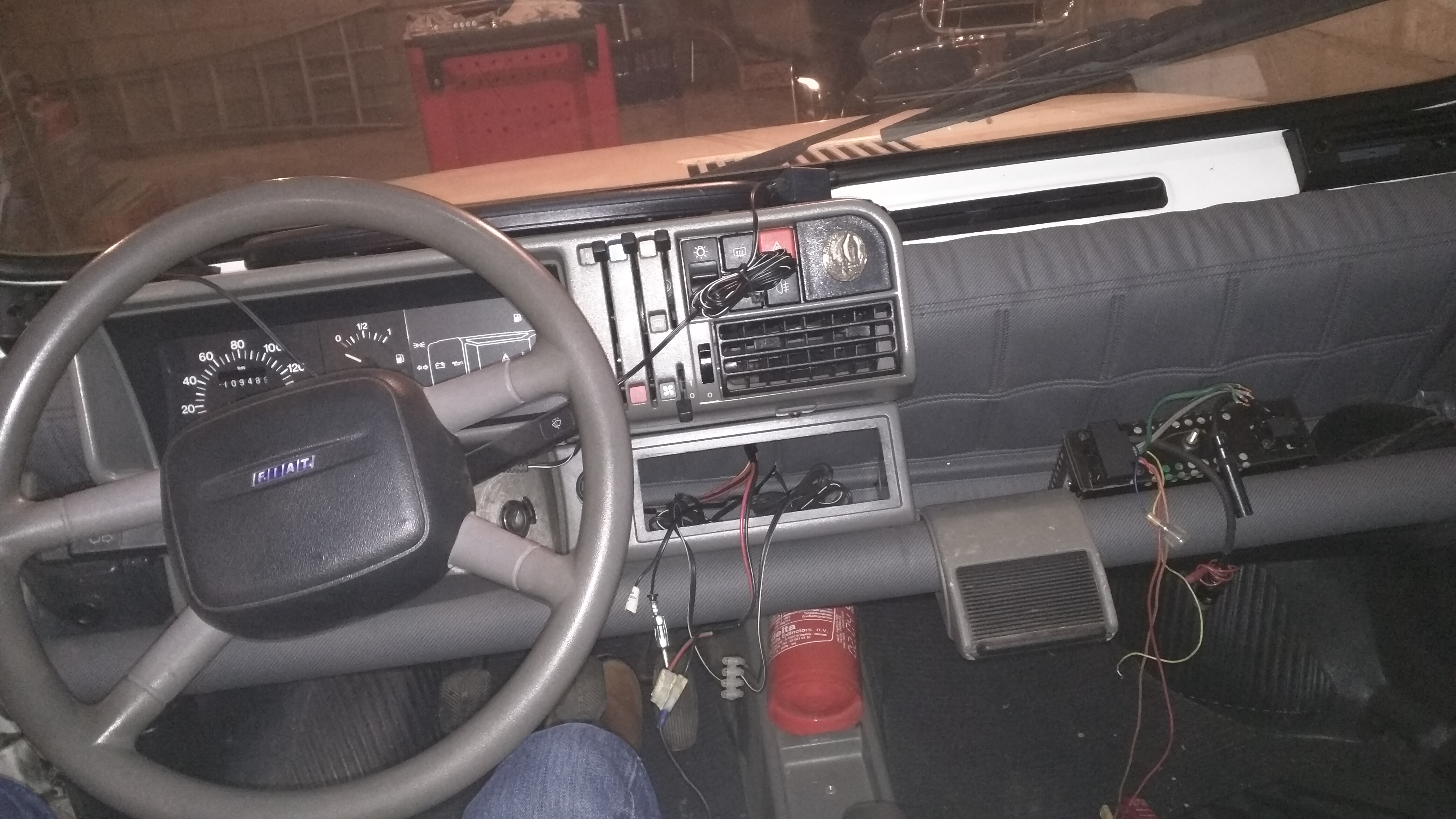

Mine came with the extinguisher in the "center console" under the dashboard, fits ok there and you wouldn't notice it's there when using the car.

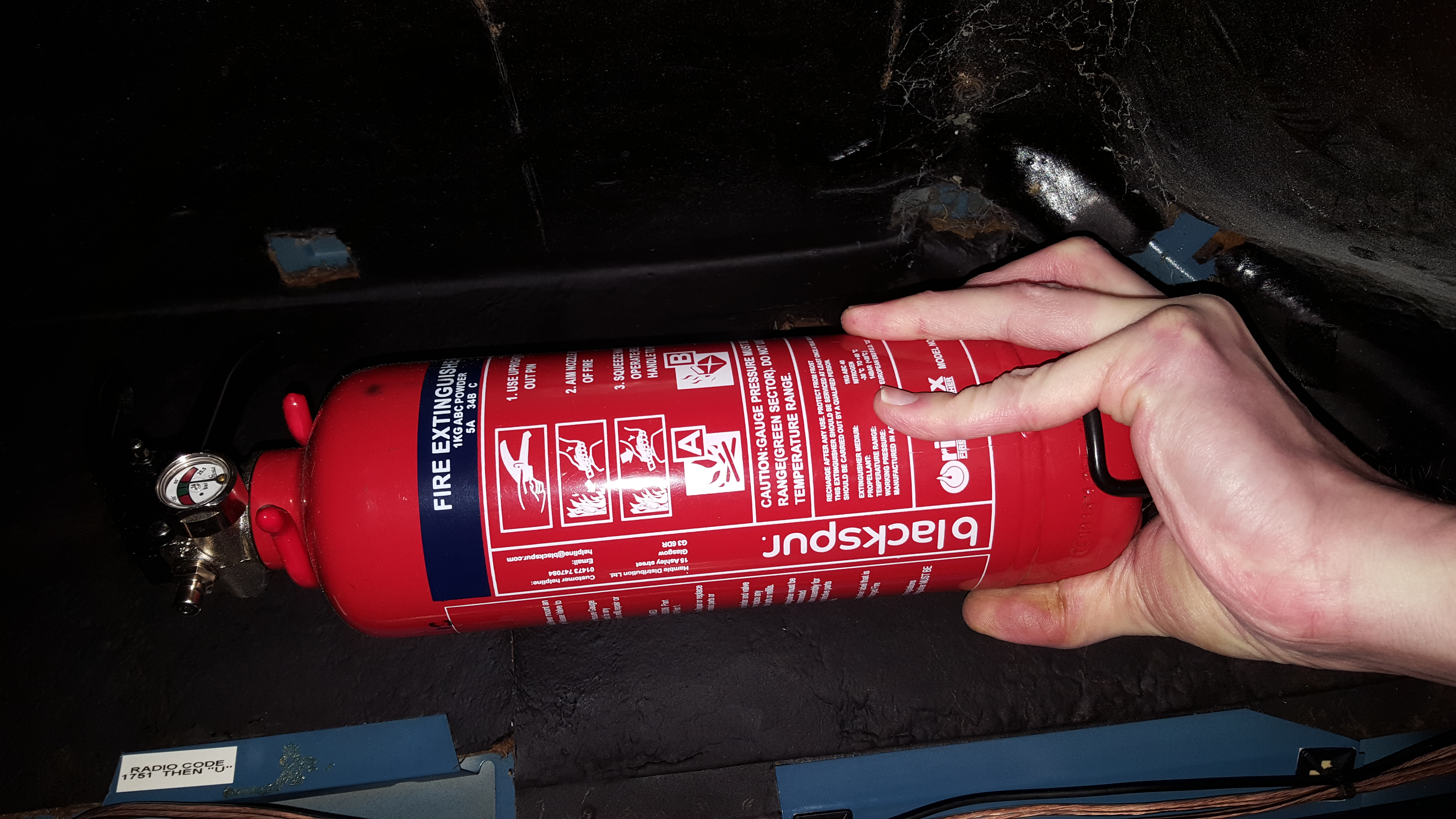

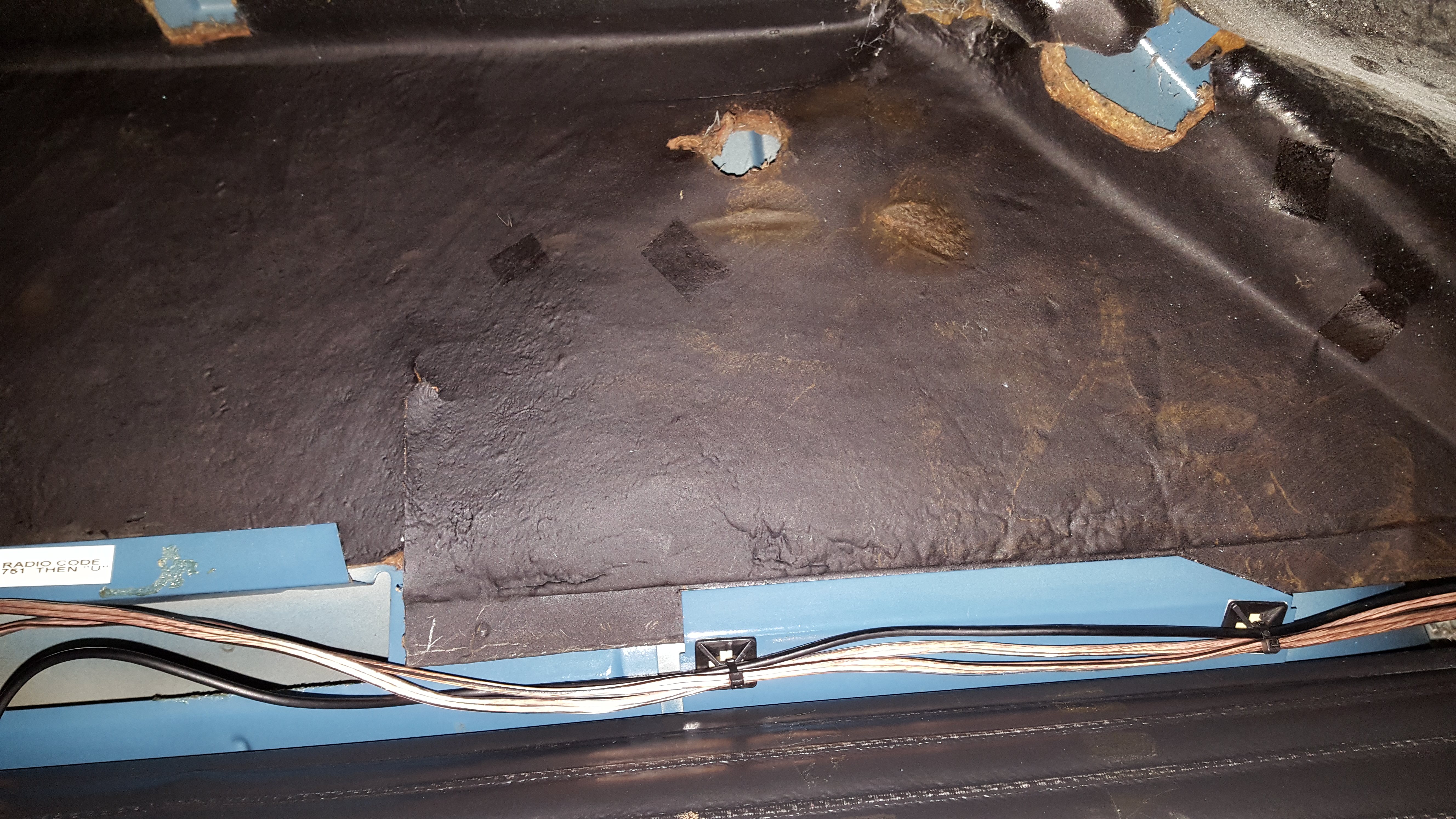

I've attached a few photos of the area I'm talking about and how intent to fit mine. I know you previously stated you didn't want to be drilling holes, but it's probably the only way you'll fit the extinguisher in a place that's handy in an emergency and at the same time isn't rolling about and in the way. I'm using the one out of my Alfa to illustrate as I've not yet got one for Pandani. The Panda's actually quite good in having this void below the dashboard, a lot of modern cars are too well stuffed with things to enable anything else to go under there.
This is the flat area of the bulkhead within the engine bay below which the extinguisher bracket will be fitted.
This is the underside of the above mentioned area, its to this the bracket will be secured by two nuts and bolts after drilling through the black sound deadening and the flat area of the bulkhead; was going to use self tappers but think nuts and bolts are better job to avoid sharp end of screws poking out into engine bay.
This is the extinguisher held in the position it's proposed to be installed under the bulkhead.
This shows the orienation of the extinguisher (laid on floor as not yet fitted) with the bracket uppermost as if it has just fallen from it's fitted position, the extinguisher's operating levers will be closest to the driver seat so I can easily lean across and pull it downwards out of its bracket should the need arise.

It's just occurred to me that maybe your Panda may have an ECU on the passenger side that may prevent you fitting yours in this position. Am I correct? In any event just double check there's no cables or anything behind the sound deadening before you drill.
Also, you should maybe drill the bracket's hole that will be closest to the passenger door before drilling the second hole nearest the heater matrix, that way you can measure/gauge where the second hole will penetrate and avoid drilling into the heater matrix or it's casing.
