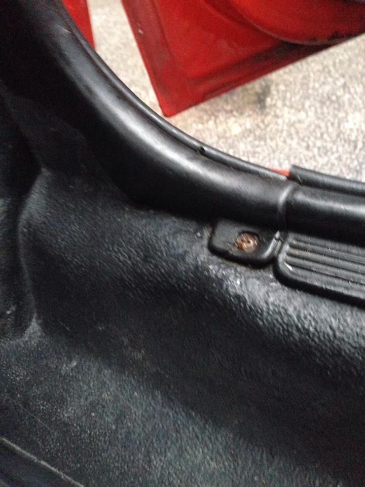

Uh oh? Not sure how this happened, going to be keeping an eye on it...

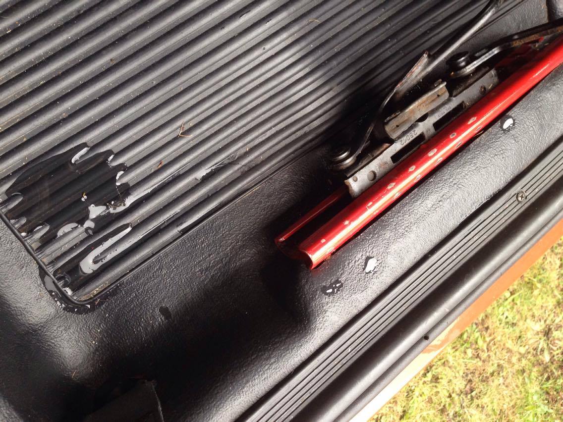

Found some water behind both seats, where driver's feet are and just next to the mount nearest the door of the driver's seat. No water is on any of the seats, so that's good I suppose. I'll go check it out some more later. :bang:

Re water ingress have a closer look on the bottom edge of windscreen seal from inside. If no signs of water there use the old fashion talc (or flour) method to trace the source.

Checked the car a couple times since, and it has been raining, yet now no water in the car is building up. Seals seem to be okay and keeping out the rain, but I'll keep checking to make sure it's still alright. Might only happen in stronger rain! :rolleyes:

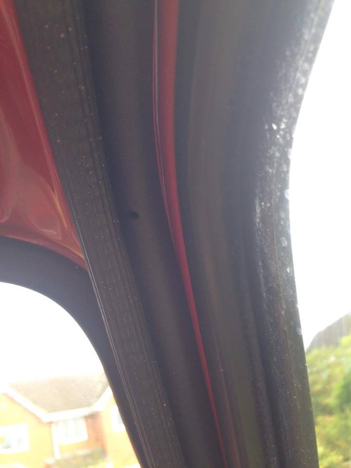

Just attached an image of a potential water leak culprit. I left the car for a while when it was raining. While I found no sign of water inside the car this time, I did see a few water drops from here on the driver's door seal. Will have to look into it some more tomorrow as well. Could need a new seal, or at least some sealant/silicon to stop water coming in from there? :rolleyes: We'll see :p

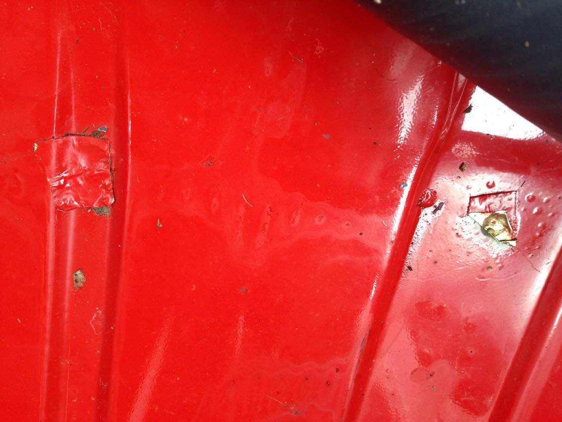

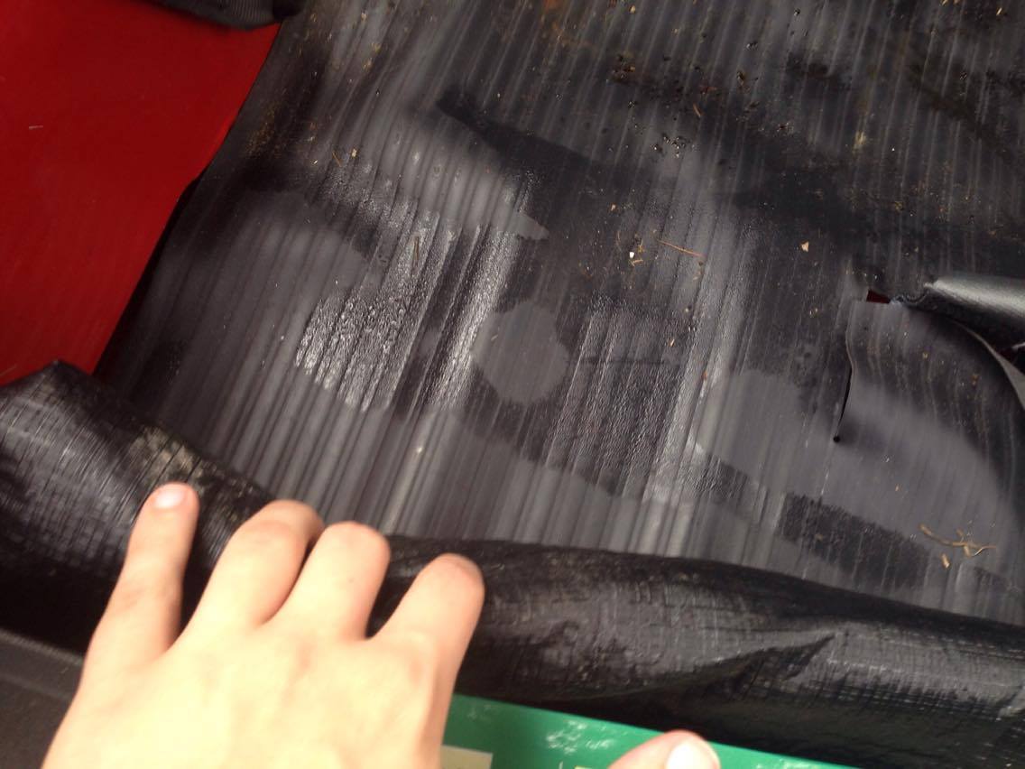

Left my Panda overnight and I've got some more water now. Here are the pictures of the back, I put the seats up as it felt very slightly damp on either side of the rear seat, it looks like there's some sort of oil under the seat, I'm not sure how this one is happening... also attached a picture of some tape type stuff over some holes under the carpet. Not sure if that has to do with anything, probably not. A little wet near the rear of the seat (underneath rear, nothing on top of seat) too, near to where it joins up with the boot, but the rest of the boot is bone dry.

Continuing on from the last post (pictures of rear above), here are pictures from the front as water has got in by the driver's seat again. I'm suspecting the door seal, as the windscreen seal looks good. Any suggestions? Going to have to look at it some more, going to be trial and error I think!

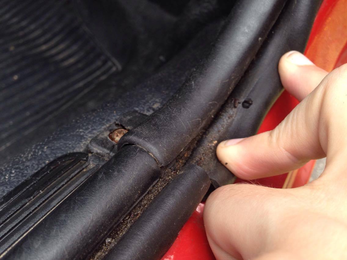

Does the window/door top frame seats tight against the A-pillar and roof?
Have you got one key for all doors/ ignition? or different?
Rather than spending £ on door seals if you can find any, you can buy a length of neoprene cord 4-6mm dia and thread it inside the seal section.

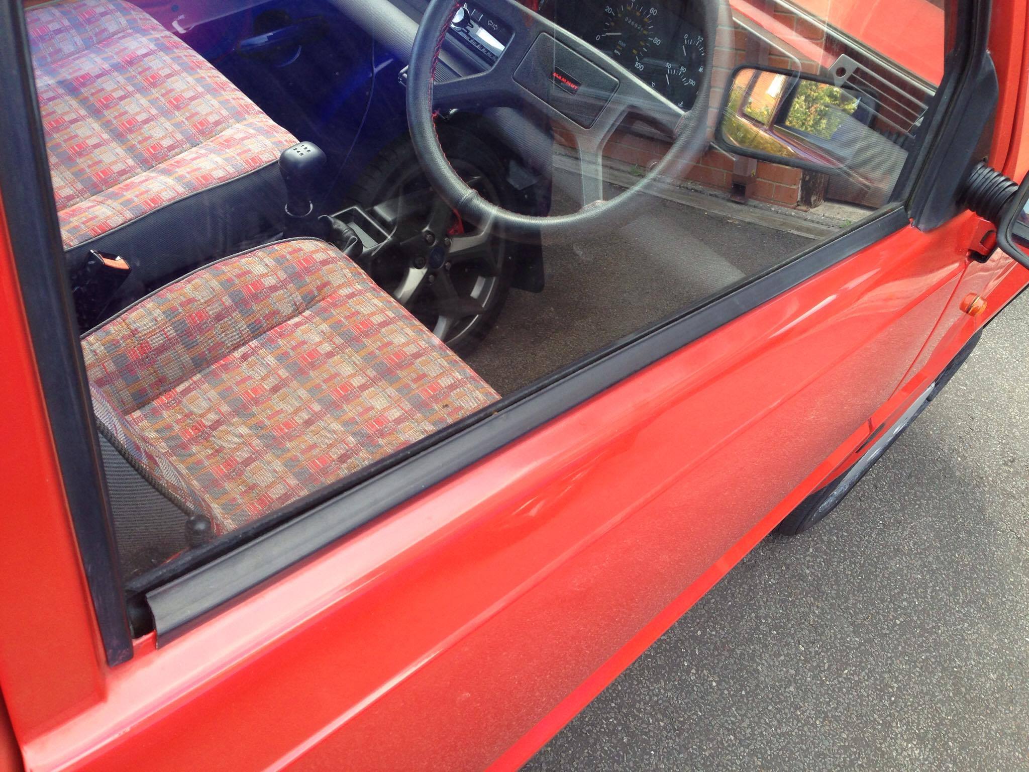

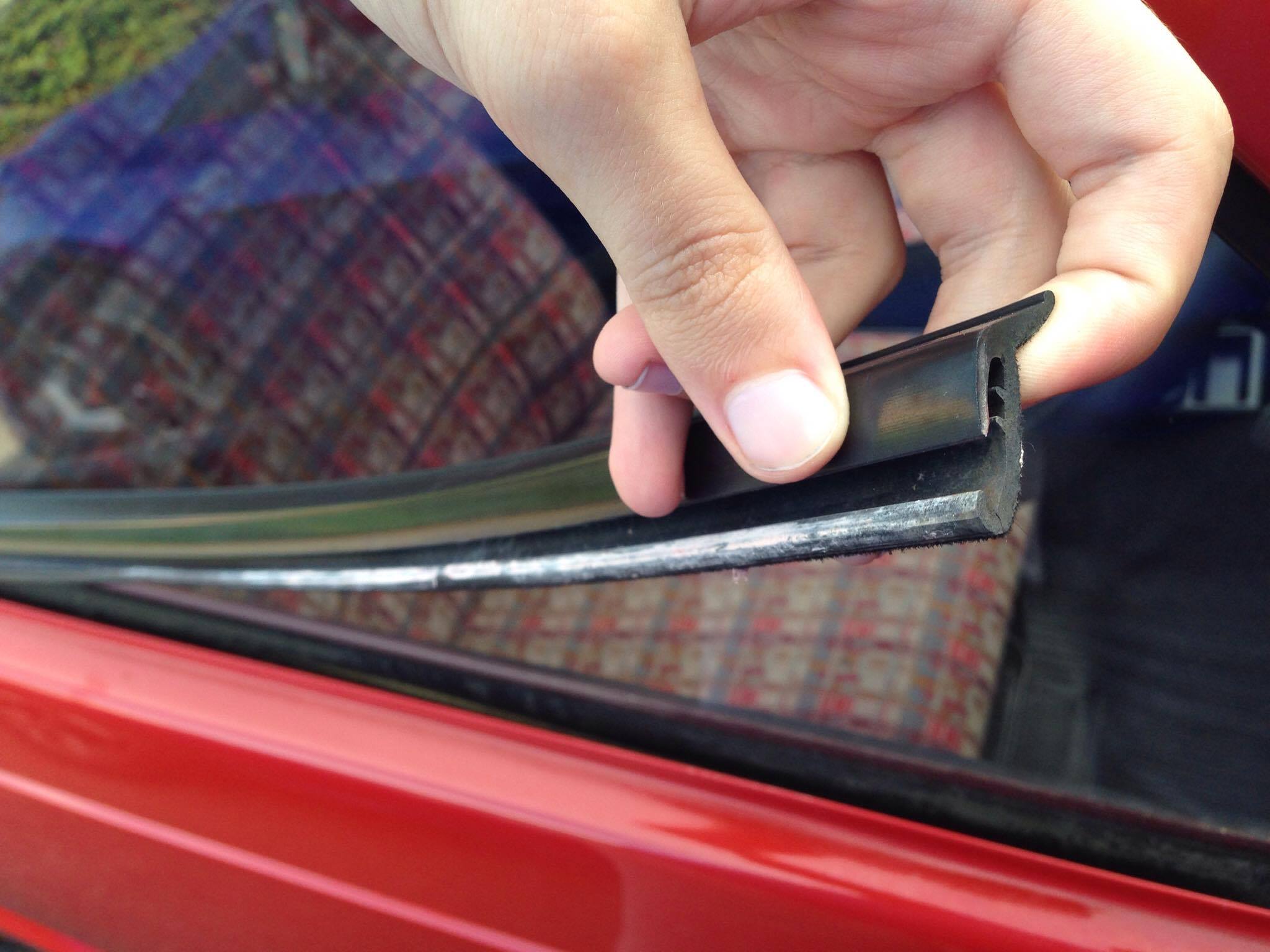

Ding ding ding. Window/door top frame does NOT sit tight against the seals on the roof, but it does start to line up when it's going down the A-pillar... it's almost as if the door is not on properly. At the bottom, I can see marks where the door grinds slightly on top of the top of the floor, and it's a harder door to shut than the passenger one.
Take a look at the pictures, you can see the seal isn't pressed by the door, and that the door (only at the top) isn't actually in line with the car at all. That's really odd. Might need to take it off and put it back on right? :rolleyes: Guess this still doesn't explain the rear but I've got some roll in the back to see if it's the plastic covers next to each seat letting in the water... we'll see on that one.
