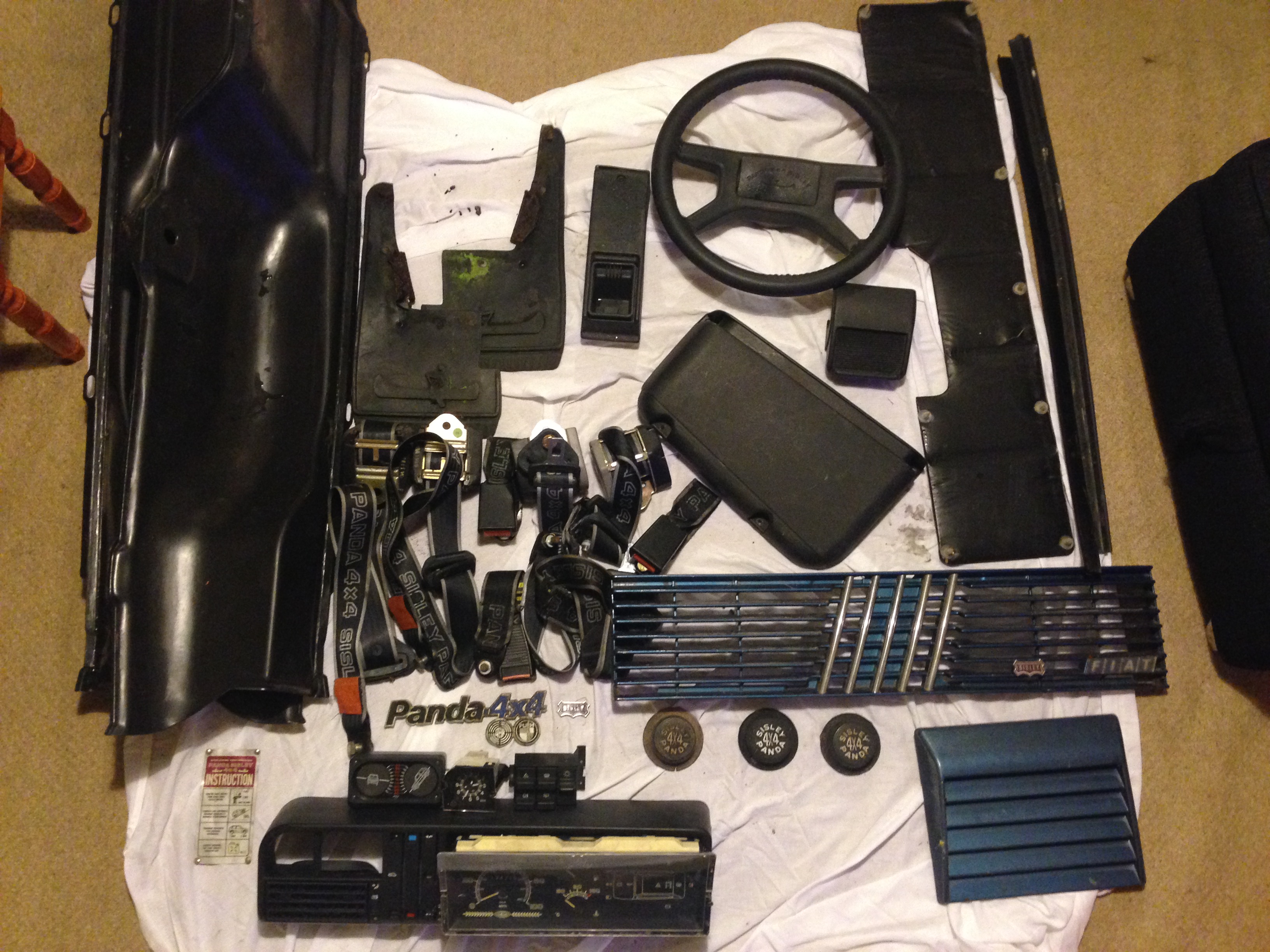

Sisley Bits
As some of you know, I've obtained a lot of Sisley parts, more info on that in the following thread: https://www.fiatforum.com/panda-cla...panda-sisley-parts-panda-sisley-breaking.html
Some of this Sisley stuff will make its way onto Pandino. The boot interior trim, seat belts, ashtrays, door pocket and window/door seals can go straight on without too much hassle after a good clean. The dash is tempting though I'd want to switch the clocks...
Little bits to keep on the side for now are the badges, hubcaps and the neat little Sisley instructions. The grille and the bonnet vent may both be used in the future but they would both need refurbishment/repainting before going onto the car, especially seeing as how they are blue right now! As for the steering wheel, I don't really need it, so I'll see what happens.
I'd like to put the mudflaps on the car but my issue there is that all of the metal mounts are rusted. The mudflaps themselves will clean up well but I'm not sure how I can mount it as I don't want to re-use the rusty mounts really.
Does anyone know how I'd be able to mount them without reusing the old rusty mounts? Need new mounts/cleaning up or?
Picture of bits attached to this post.

For your mudflaps I would think making new metal parts and riviting them to the rubber would be a straightforward job.

Probably the best thing to do. I'll look into doing that when I get some time, thanks :)

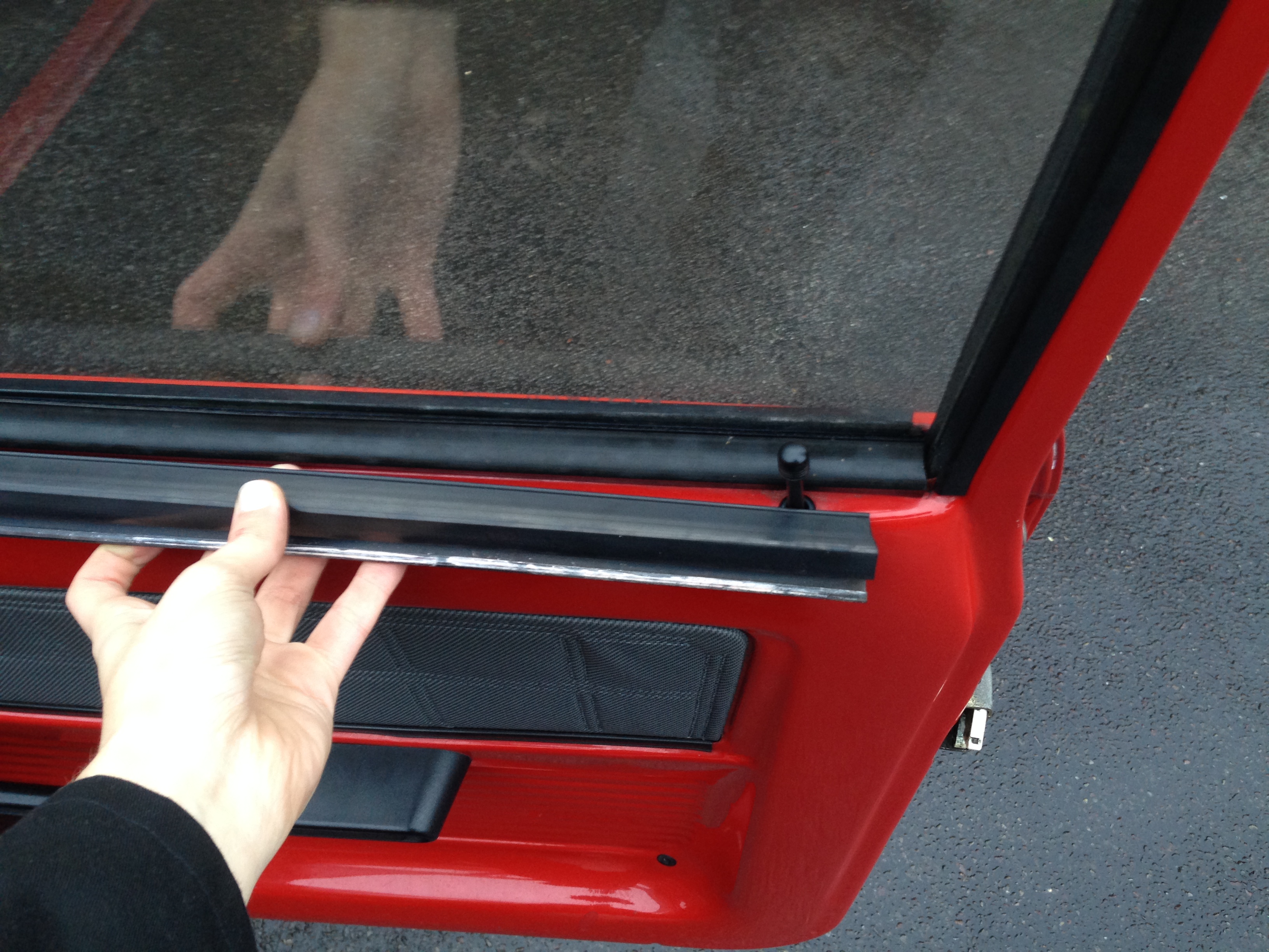

Next up, I took the full length Sisley door/window seals I nabbed to replace Pandino's old shrunk ones...

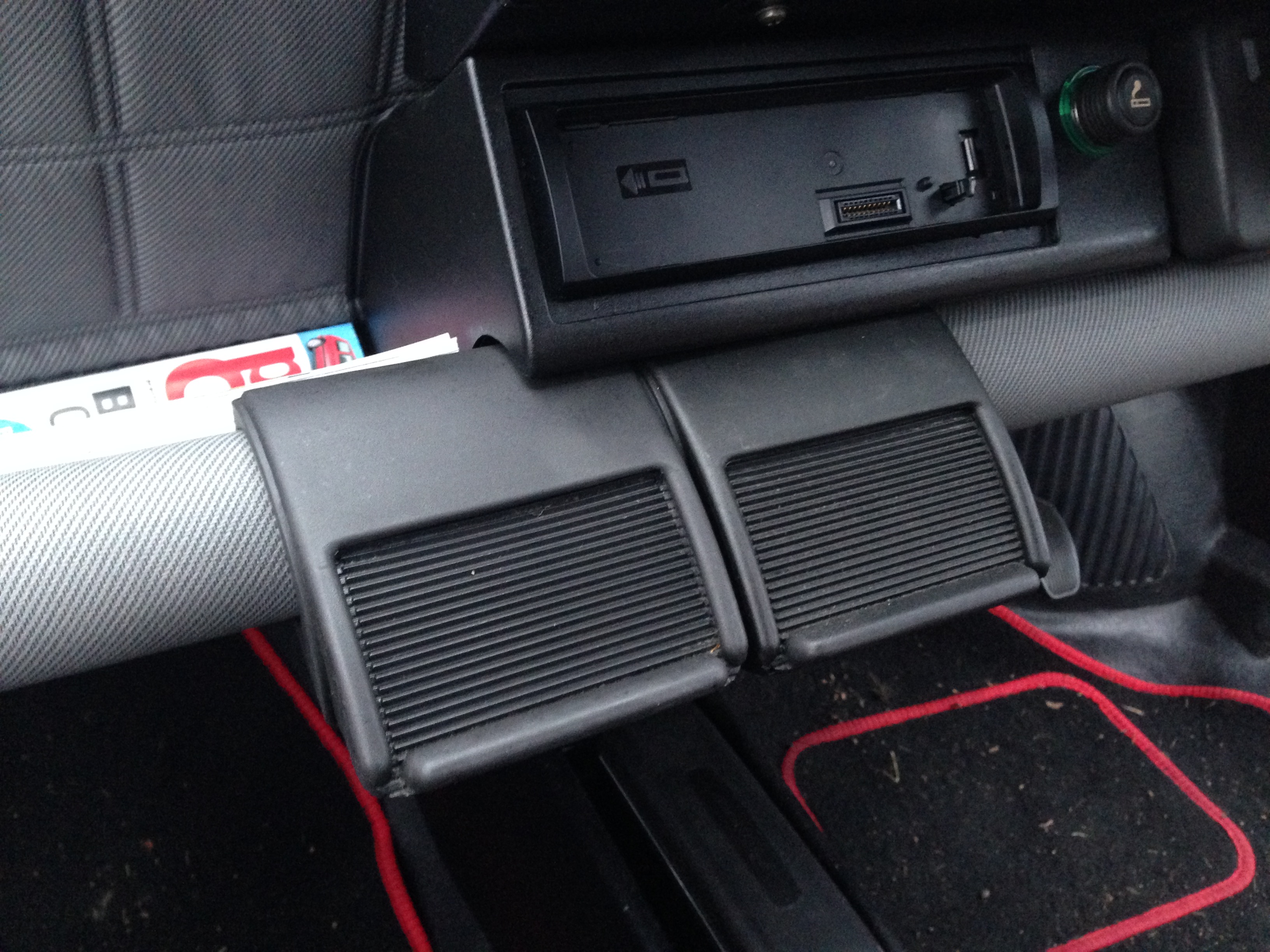

And you can never have too many front ashtrays!

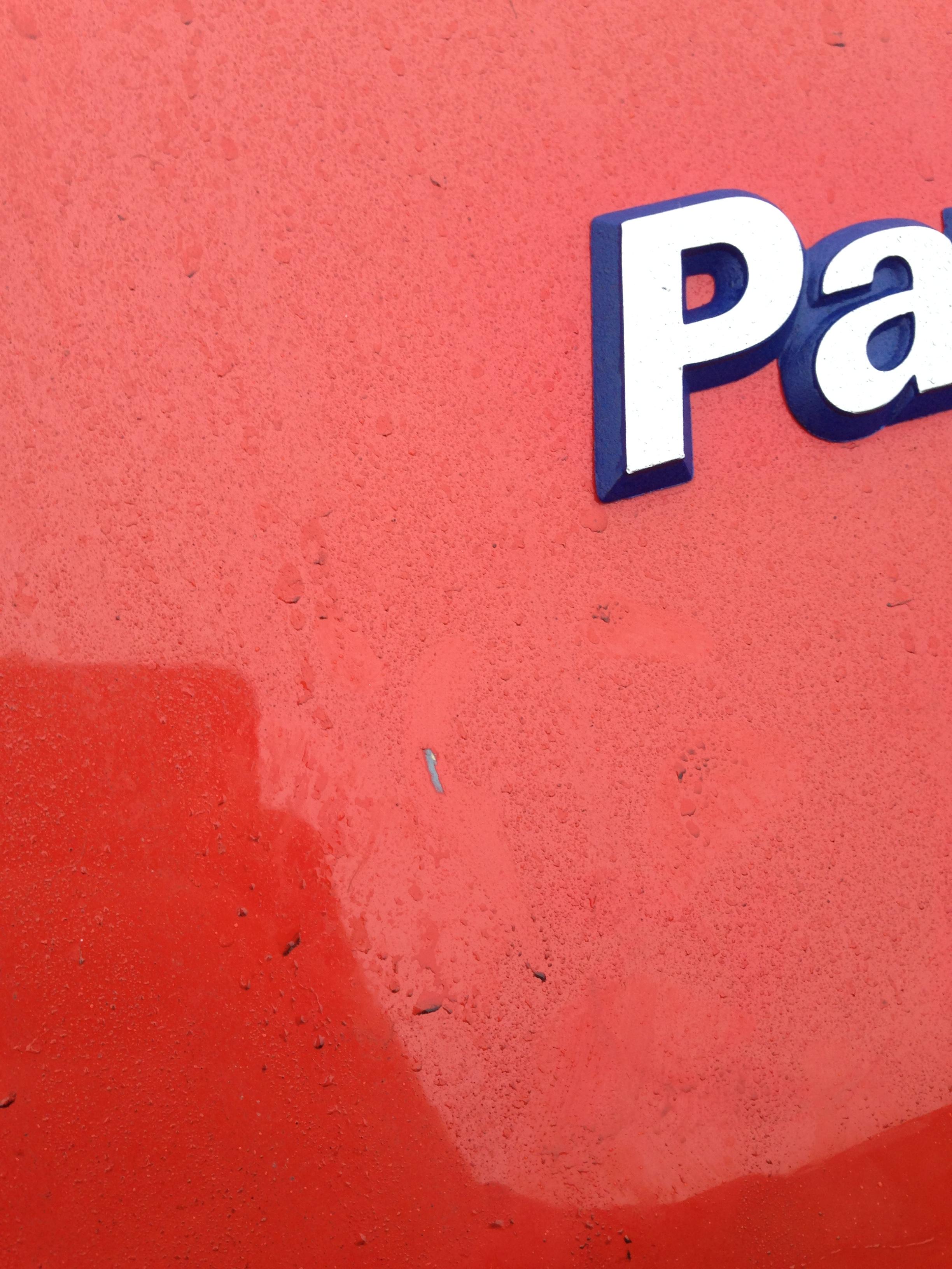

Unfortunately, I do have a scratch on the boot. I'm not sure how it got there, but I suppose there's no point sulking about it and I should just get on with it... I need to get around to touching up paint anyway. Onwards and upwards :eek:

... one of the screws has red paint on it. Strange, because when the boot is fully open, it doesn't touch the garage door.
I bet that scratch occured while you was banging in boot lid to push them clips holding the back trim.
