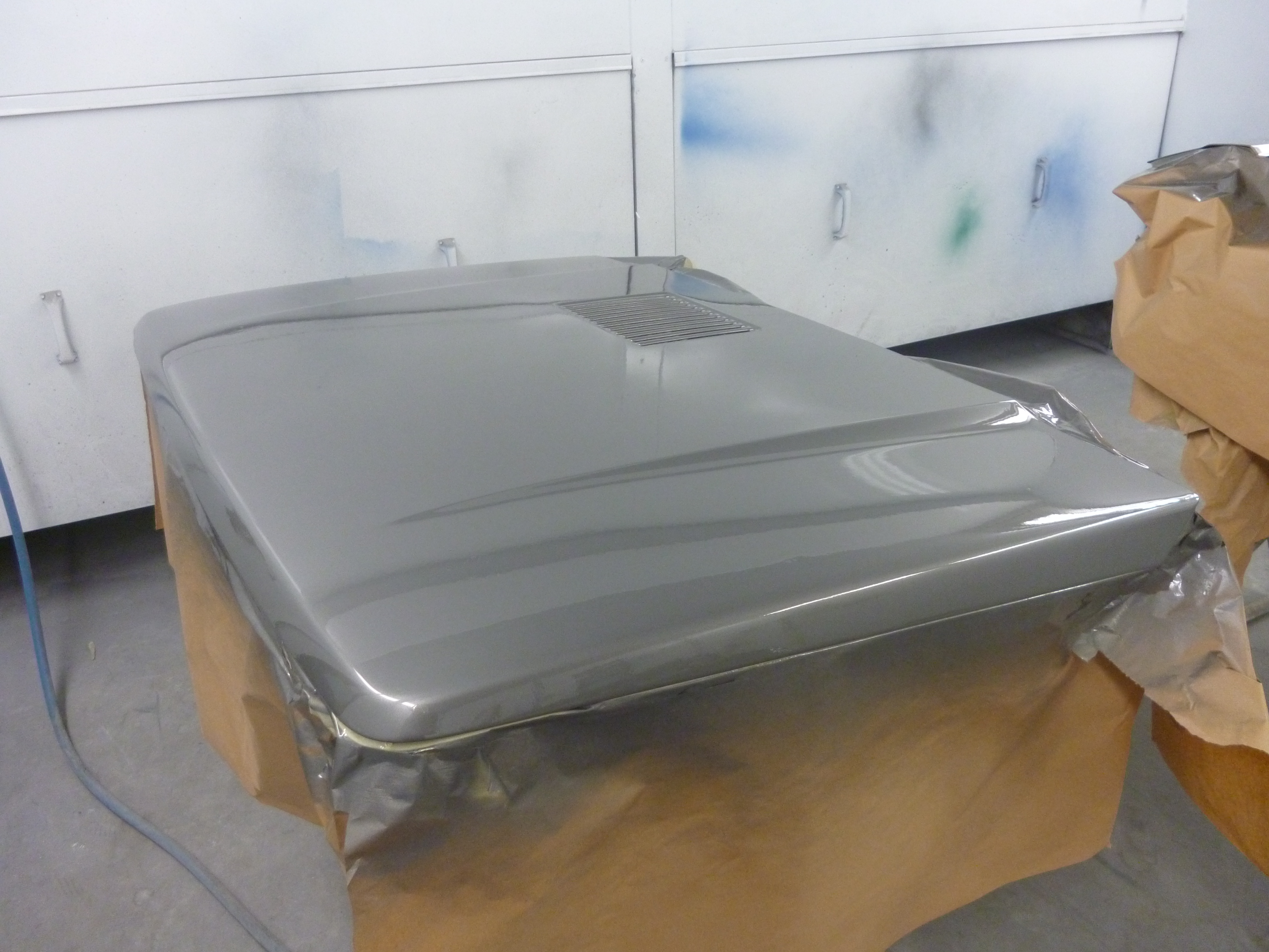

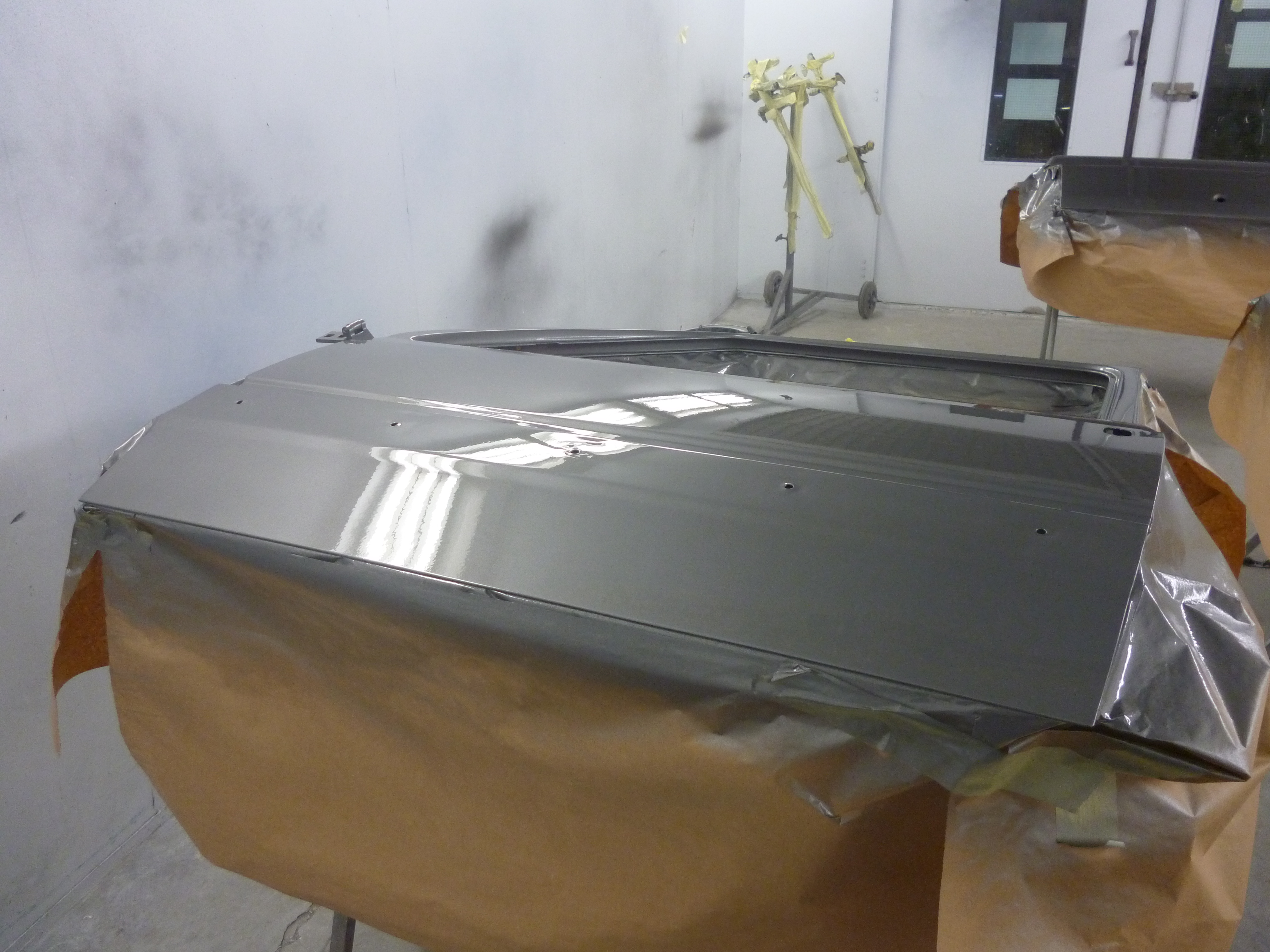

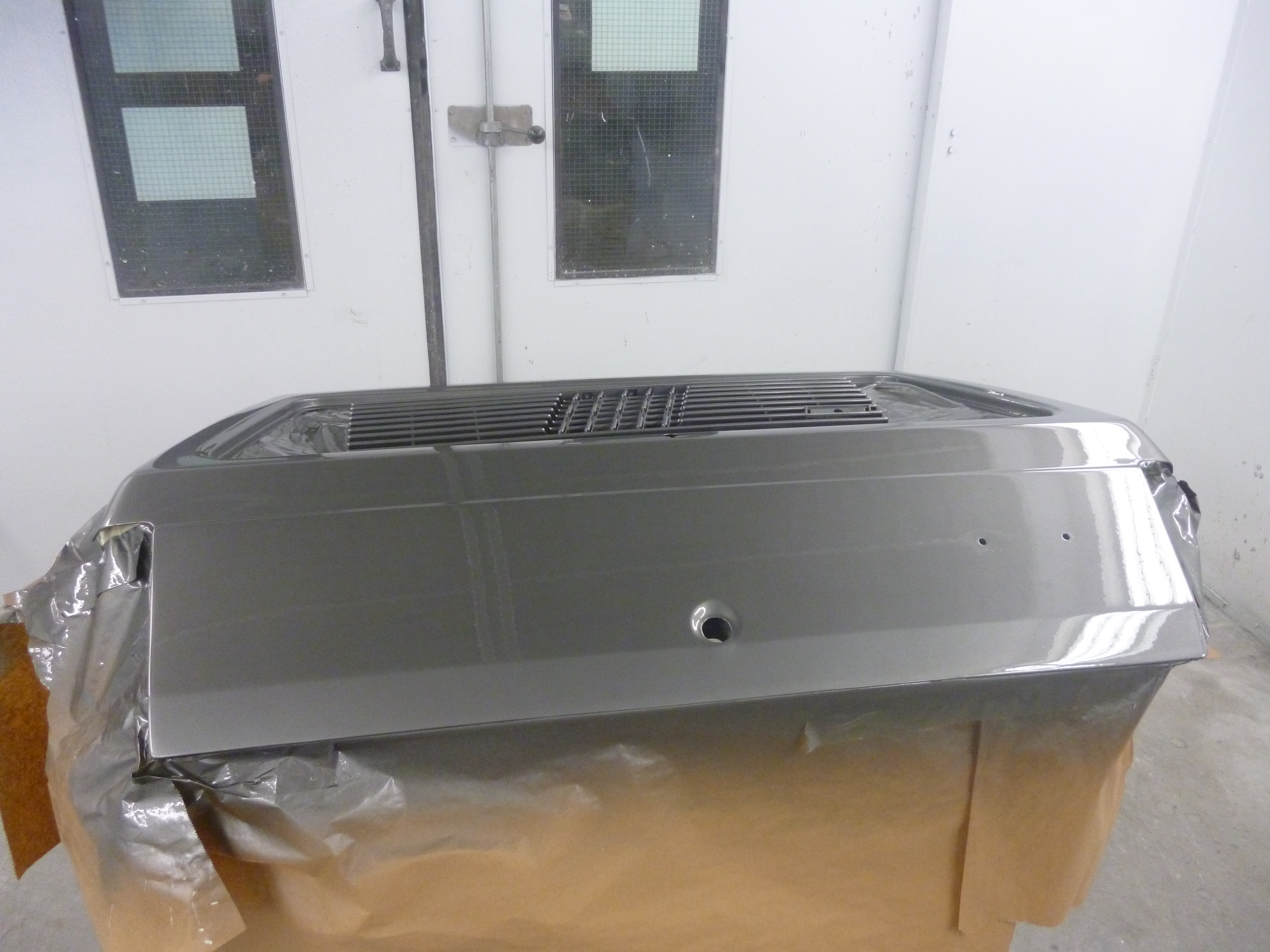

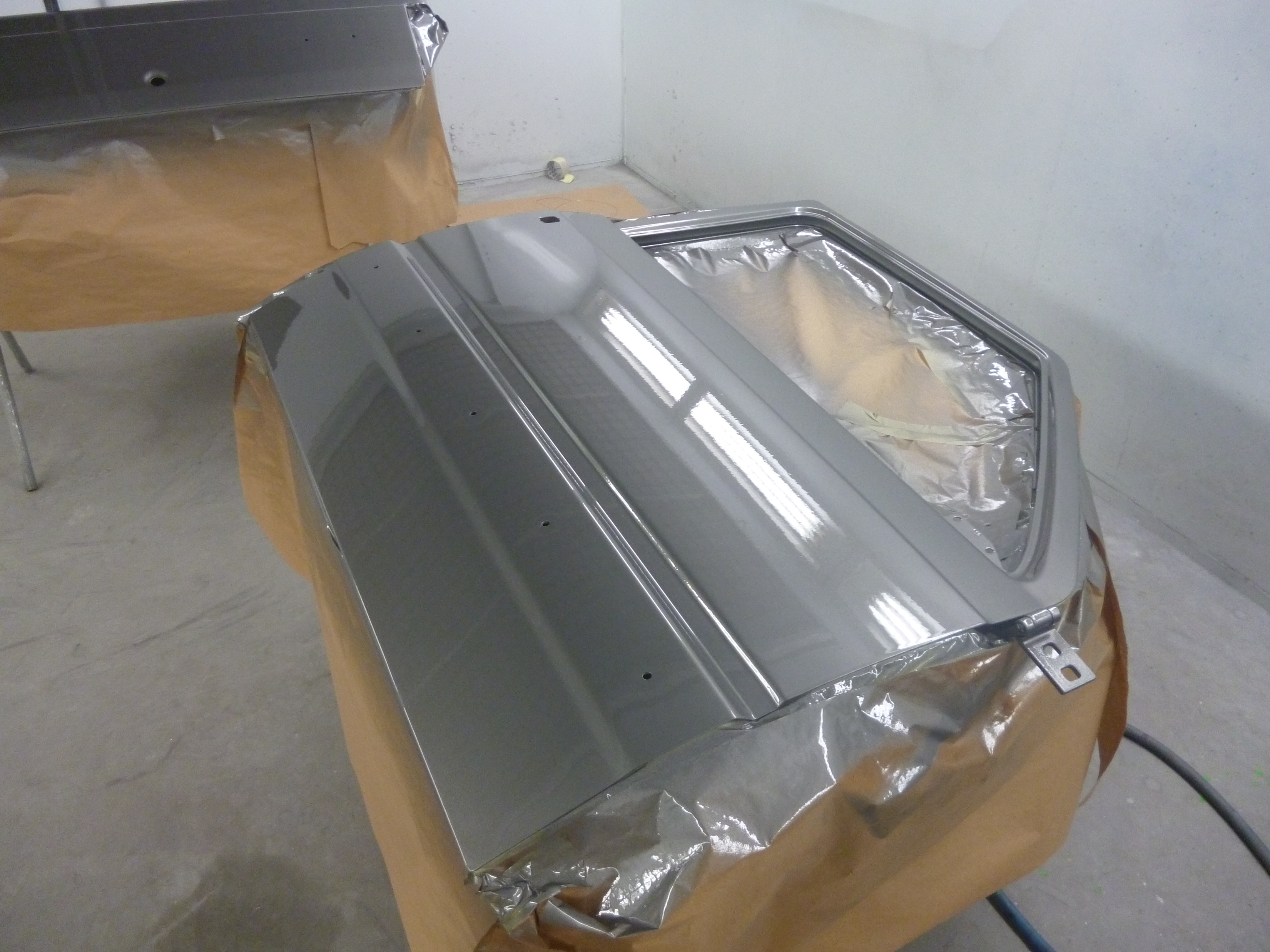

Panels now painted, insides have been done aswell:

Paintwork is looking superb Freddy, how lucky are you to have those facilities! :yum:
I'll have to have a go at fixing the headlights then, don't think I'll be allowed to use the oven so will have to try the heat gun method, that Cinq guide looks useful though(y)
Yes I am very lucky to have use of the booth, although it takes some planning as I have to fit around proper paying jobs, I can't moan though as it would have cost me alot more if I was getting anyone else to do it for me!
