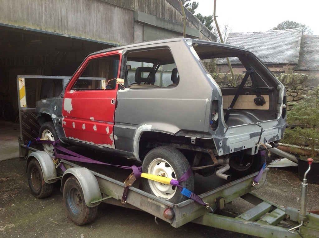

As promised here are a few pictures of my Sisley I picked up yesterday
I'm going to give it a good clean and check over tomorrow but I had to have a play with the 4WD in our field first :D

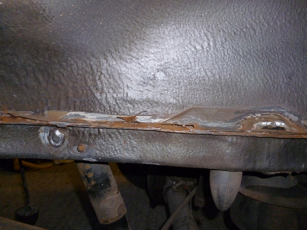

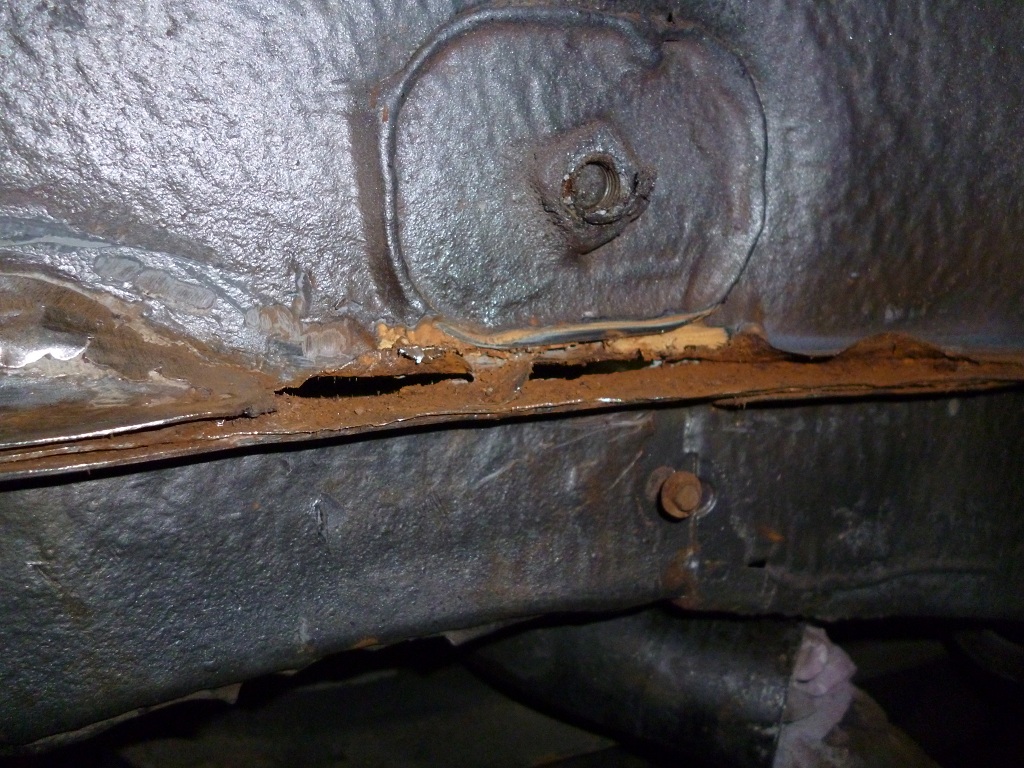

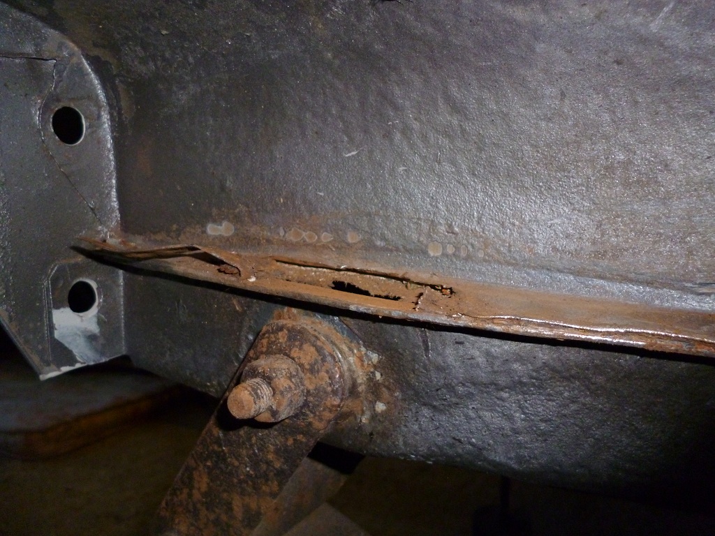

Well I'm still plodding away at this, spending most of my weekends prepping bodywork. I thought I was getting somewhere until I starting poking at the boot floor seams in the rear arch and realised they were worse than I thought:( Drivers side is totally shot and the Passenger side needs a small section repairing. Should hopefully get them sorted tomorrow so will post a few photos then.

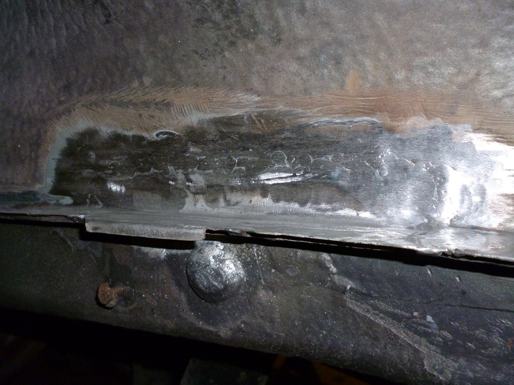

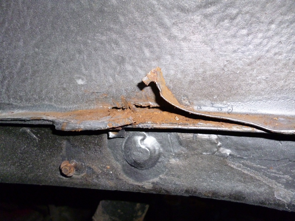

Managed to get the passenger side sorted today, not enough time to make a start on the drivers side though. Pretty pleased with what I ended up with anyway, wont even know its there once it has been painted:)
This is what the passenger side was like:
How it ended up, I cut out the inner arch section oversize so I could get access to repair the edge of the boot floor.

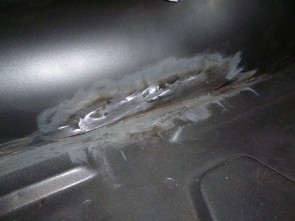

The driver side looks like this:( I will be cutting the entire top inner arch section off, repairing the edge of the boot floor where neccessary and then I will make up a new section of inner arch. Need to remove the fuel tank and filler pipes first though.
Well all the welding is finally done:woot: Inner rear arches are now solid as a rock and the rear of the drivers side sill is sorted properly, I repaired it when I first started welding and was never really happy with how it turned out so I redid it, good job as the inner sill have a couple of small holes in it which I didn't know about until I cut the outer off.

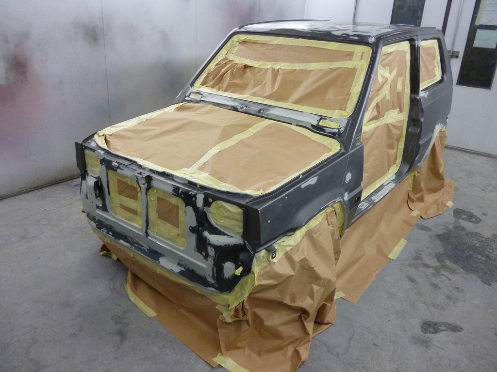

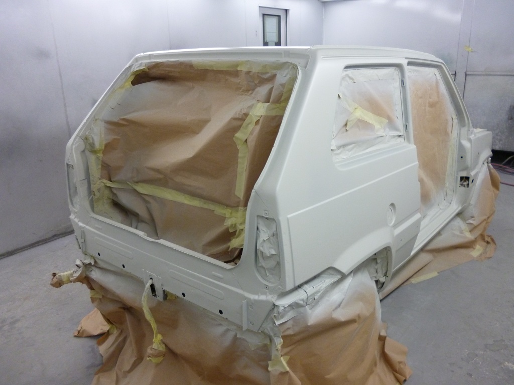

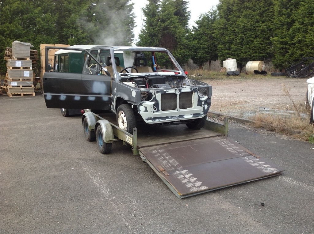

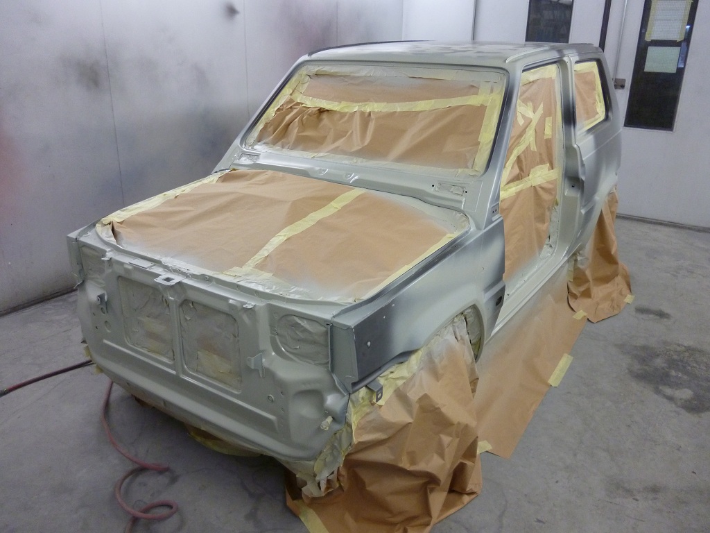

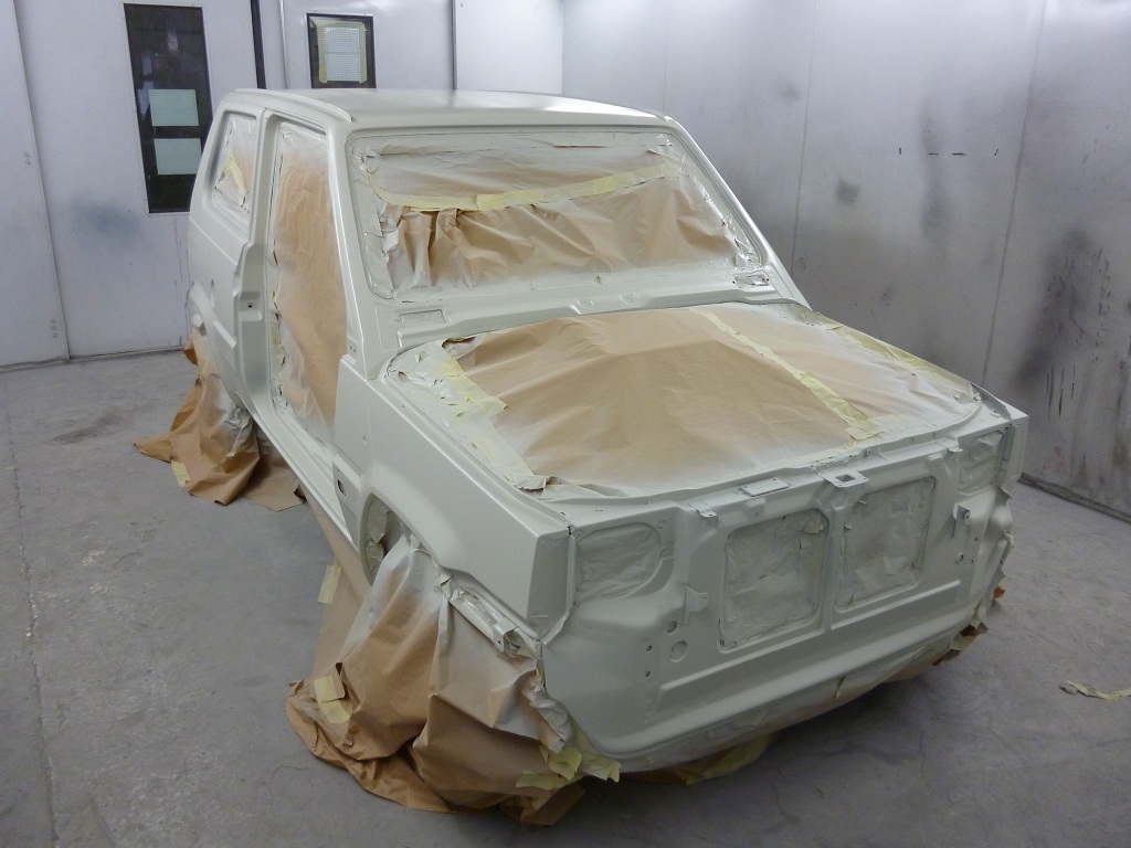

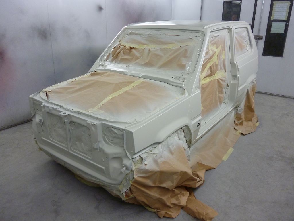

After 7 months of the Sisley sitting idle, today I fetched it home to get the final prep work done so it is ready to be painted. I have a couple of areas to re-prime and a final rub down, and then it can go grey again:D.
The doors, bonnet and tailgate are also now in primer and just need a final rub down aswell, these will be done after the car, that way I can fit them as soon as they are done to minimise the chance of damage.

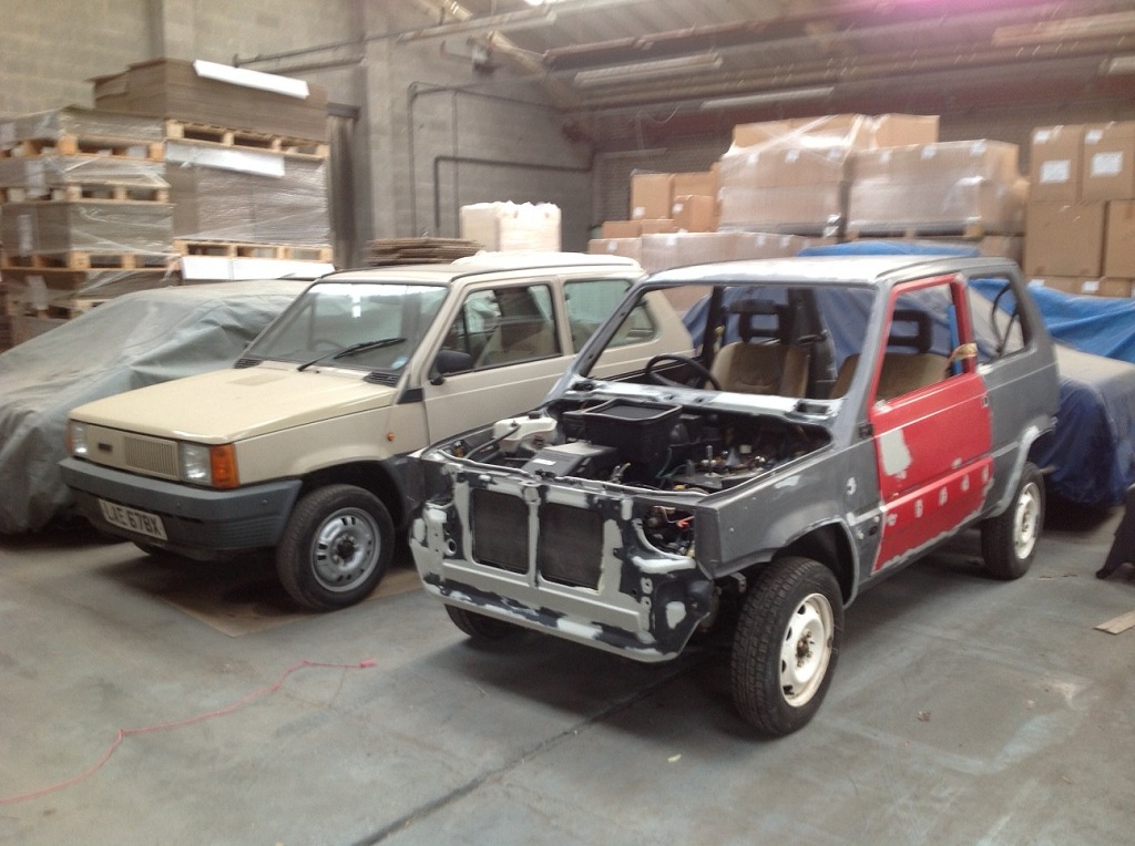

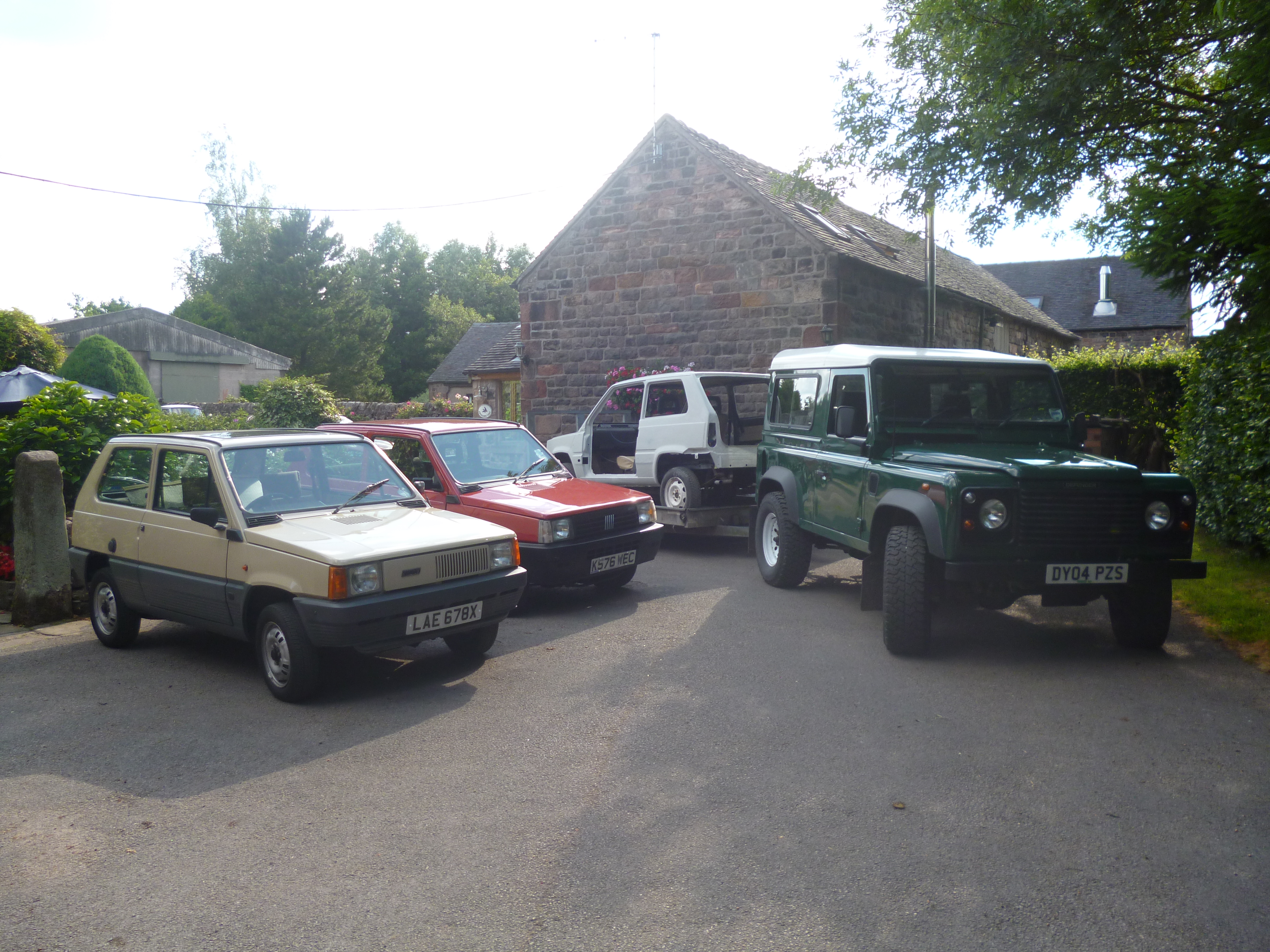

I haven't taken any photos apart from this one
Its the first time I've had all 4 of my vehicles together, you can tell which one does all the hard work, the Pandas get a nice easy life in comparison:p
