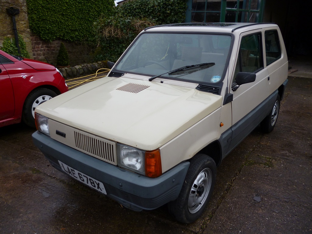

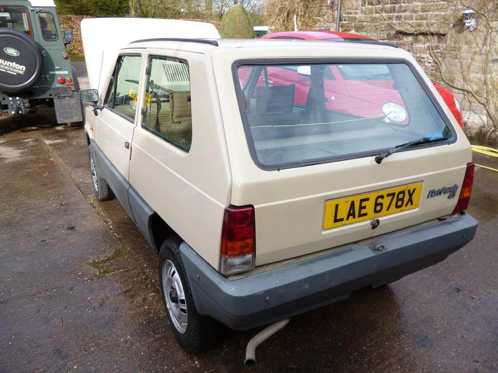

I'm pretty sure most of the Panda section regulars will know this car, but I thought I would post a few photos of the latest edition to my fleet.
It is a early 1982 Mk1 45, previously owned by forum member Cacciatore, and is possibly the second oldest Panda left in the UK. Unfortunately it has failed its MOT on a couple of bits of welding and a few other things, but I am very impressed at how solid it is especially for a 30 year old Fiat!
We picked it up last night and I was a bit worried it wasn't going to fit on our trailer! Luckily it did, just!
The plan is to do the MOT jobs over the winter once my Sisley is finished and then get it on the road in the spring and do a rolling restoration.

I'm afraid the photos make it look better than it is, the body will need quite abit of work to bring it up to a good standard, due to previous repairs that have not been done particually well. The good thing is that the interior is perfect, which is probably the hardest thing to put right, the mechanicals are excellent and it is pretty solid underneath.

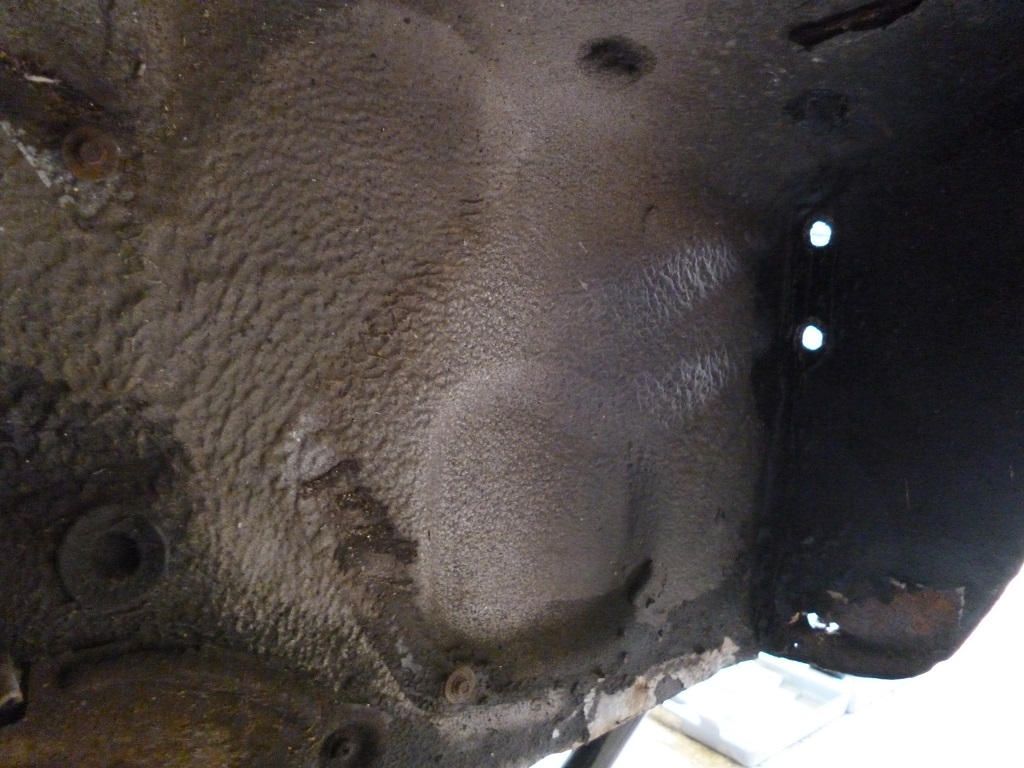

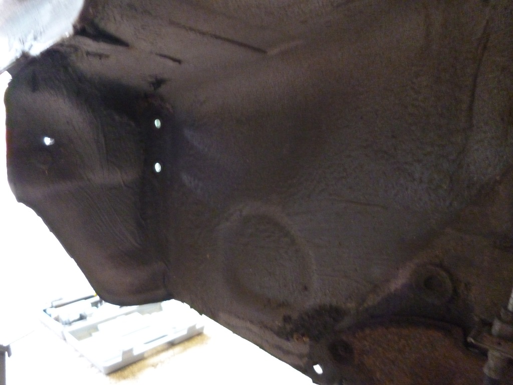

I then backed it in to the garage and got the front wheels off so I could remove the arch liners and front bumper to have a look at what needed to be done. Amazingly none of the bumper bolts were seized! The inner arches are remarkably good, just a few scabs that need abit of paint on them. The front panel is abit worse, someone has bodged it with filler in the past but it is not any worse than I was expecting.
