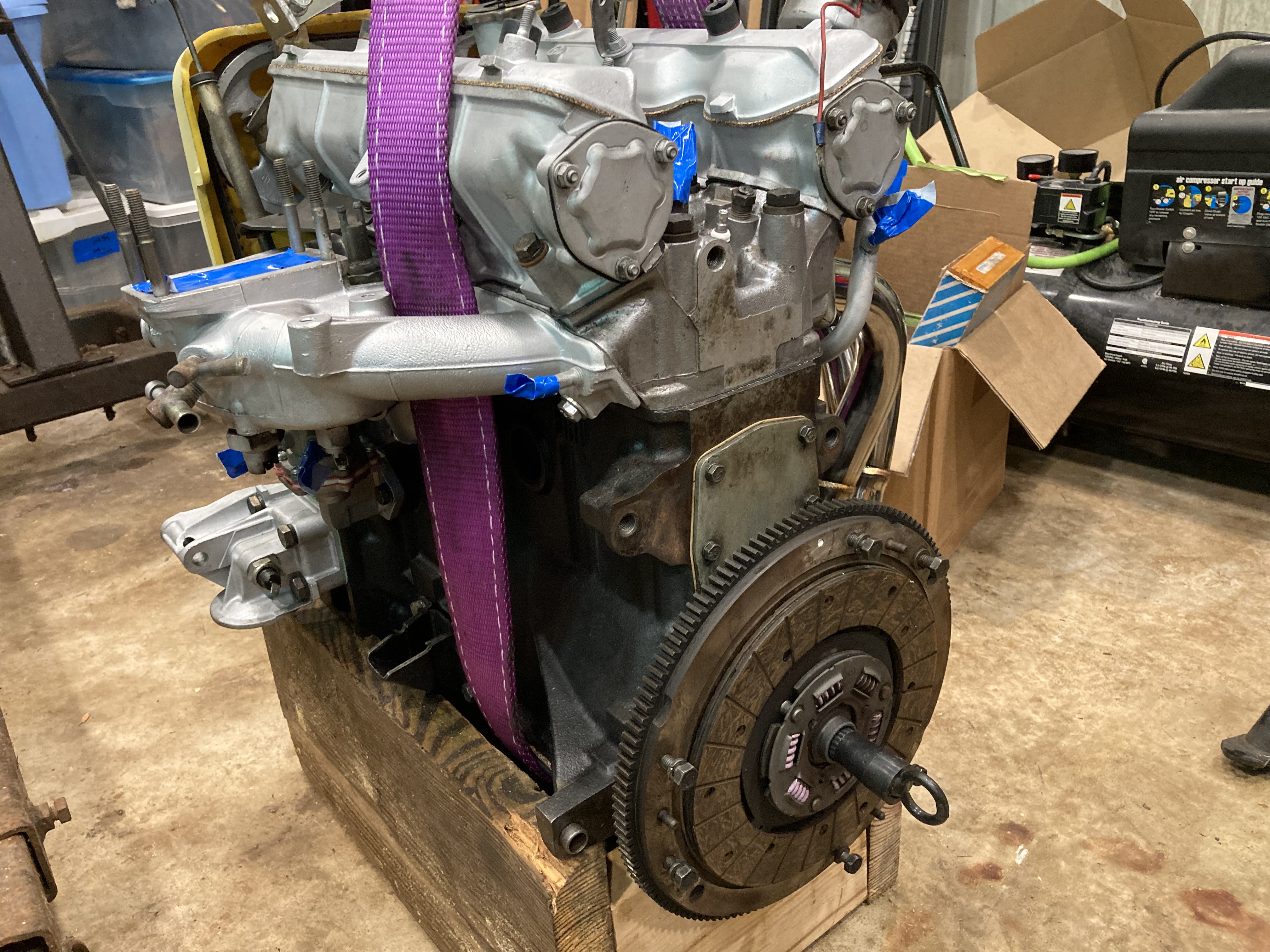

To remount the flywheel I had to build a box stand for the motor so I could take off the engine stand.
Question: torque spec for flywheel bolts is listed in Haynes as 58 ft lb, while in Pininfarina shop manual at 105 ft lb.
I’m thinking 105? Wildly different numbers…
Could it be there's different size bolts for different years?
Just for fun I asked A.I. and it came back with 65 to 75 "typically " for a 78 further confusing things...to really mess things up in will go check my Chilton manual and add it to this post :)
Yeah I saw a post somewhere talking about 10 mm bolts taking something like 40 and 12 mm taking 60 or so - and these 6 bolts are 19mm! So I went toward 105… seemed like the correct setting and is aligned with Pininfarina…
The other fun bit on this step is that my friend removed the pressure plate without marking it. SO. I’ve looked all over it for a mark but, none seen - so I have just put it on in one of the 3 possible orientations… (shrugging my shoulders).
Chiltons comes in at 61lbs for flywheel to crank bolts for a 78., on the pressure plate you have a clutch pilot tool for alignment correct?
Opps, see the pilot tool! :)
