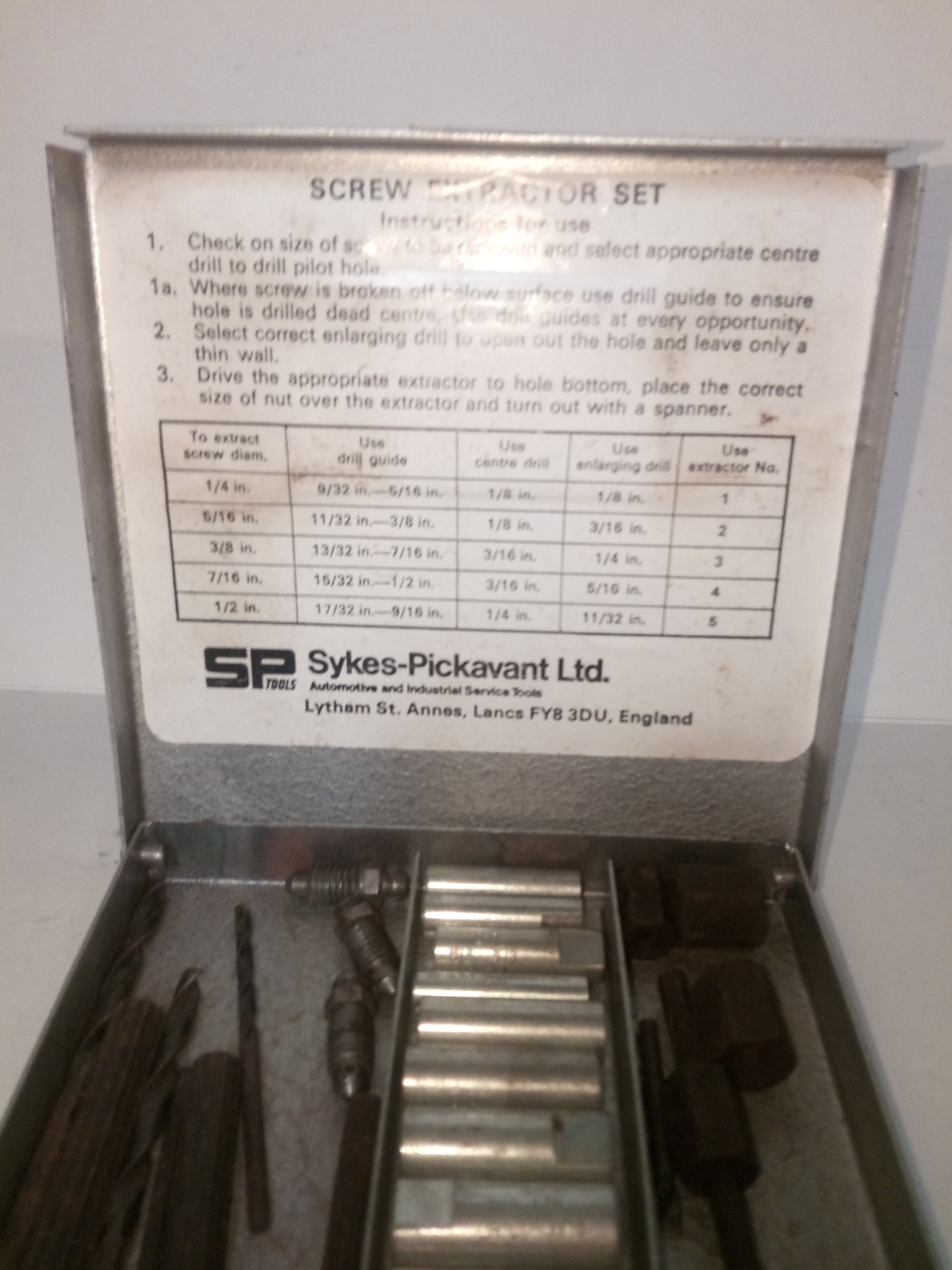

There are stud extractor sets that include guide bushes for the drilling process. I prefer to use a spline type of extractor rather than the tapered screw type. E.g. :-

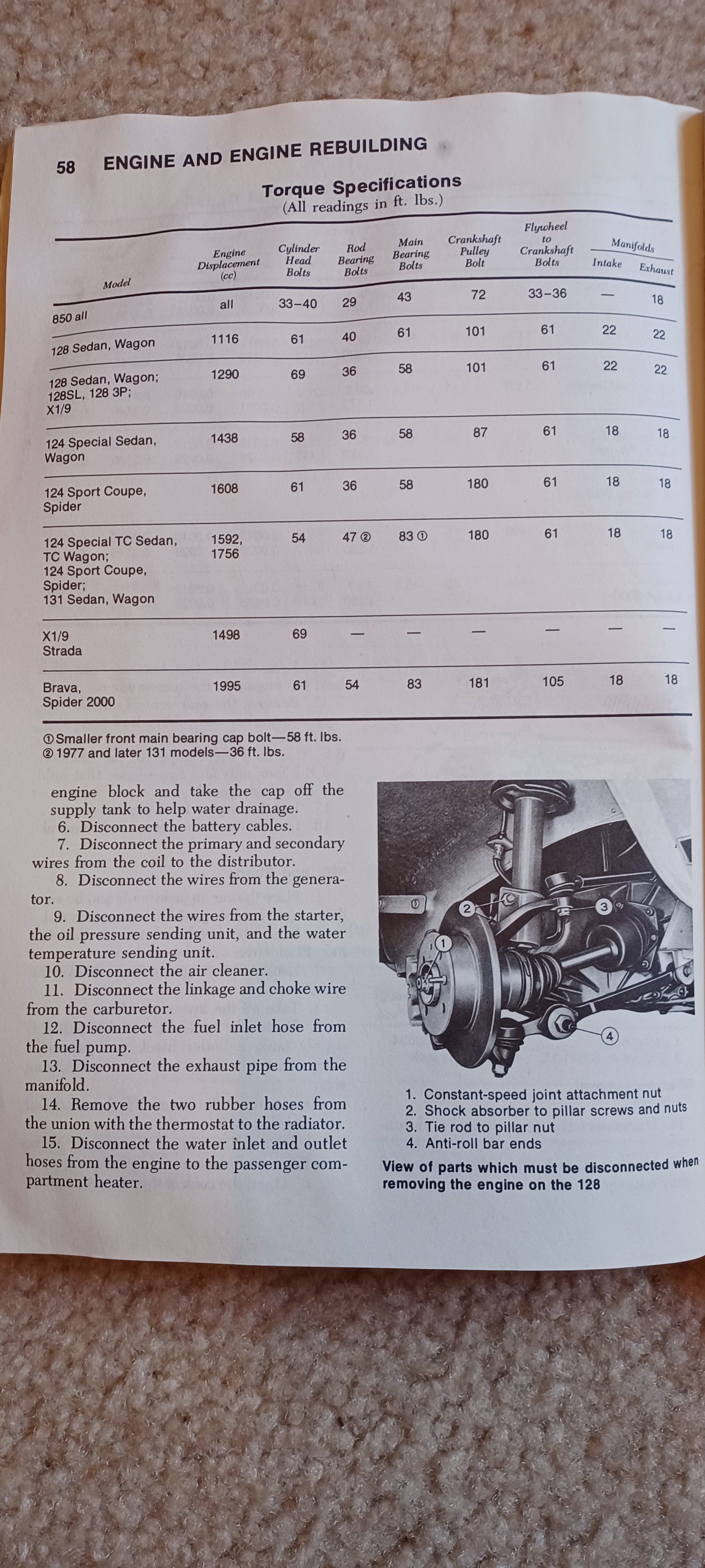

Okay question: i cannot seem to find torque spec for the crankshaft end bearing covers (each with 10mm bolts). I found one reference online for 59 ft:lb, but no mention in either the Fiat service manual or the Haynes. I must be missing something ? I don’t want to over or under torque….
Iirc, your engine is a 1756cc unit, correct?
My Haynes manual only covers cars up to 1977, and gives the main bearing torque figure as 59 ft.lbs, however afaik, this figure only applies to 10mm bolts.
Iirc, later 1756cc engines used 10mm bolts on the front? bearing cap and 12mm on the other bearing caps, the figures then became 59ft lbs for the 10mm cap bolts and 85 ft.lbs for the 12mm bearing caps.
Just to clarify, Tightening Torque figure for 10mm bolt (head size = 16mm) - 59 ft.lbs.
12mm bolt (head size = 19mm) - 85 ft.lbs

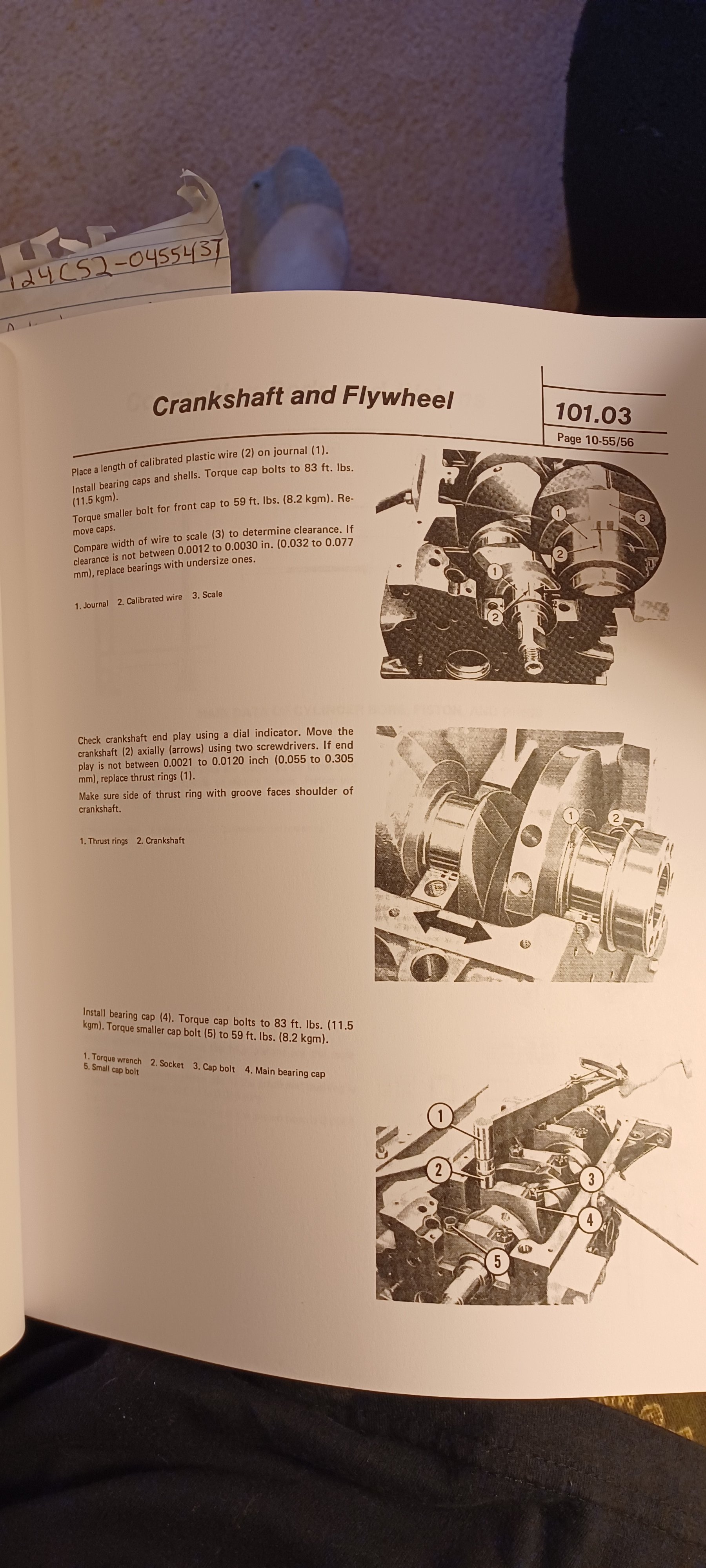

Iirc, you purchased a copy of the Pininfarina Spider 'Shop Manual as recommended by @Slotman, does this manual not give these torque figures?
Thanks @124BC1 - Yes I bought the Pininfarina shop manual, but that too does not (or I didn't find it) list the torque spec for those bearing covers. They are all 10mm bolts (fore and aft) on the 1756cc motor; so I think I will go with your recommendation. And the one reference I found was for 80nm which does turn out to be 58/59 ft/lb... Oh and my Haynes covers up to the 1980 model...

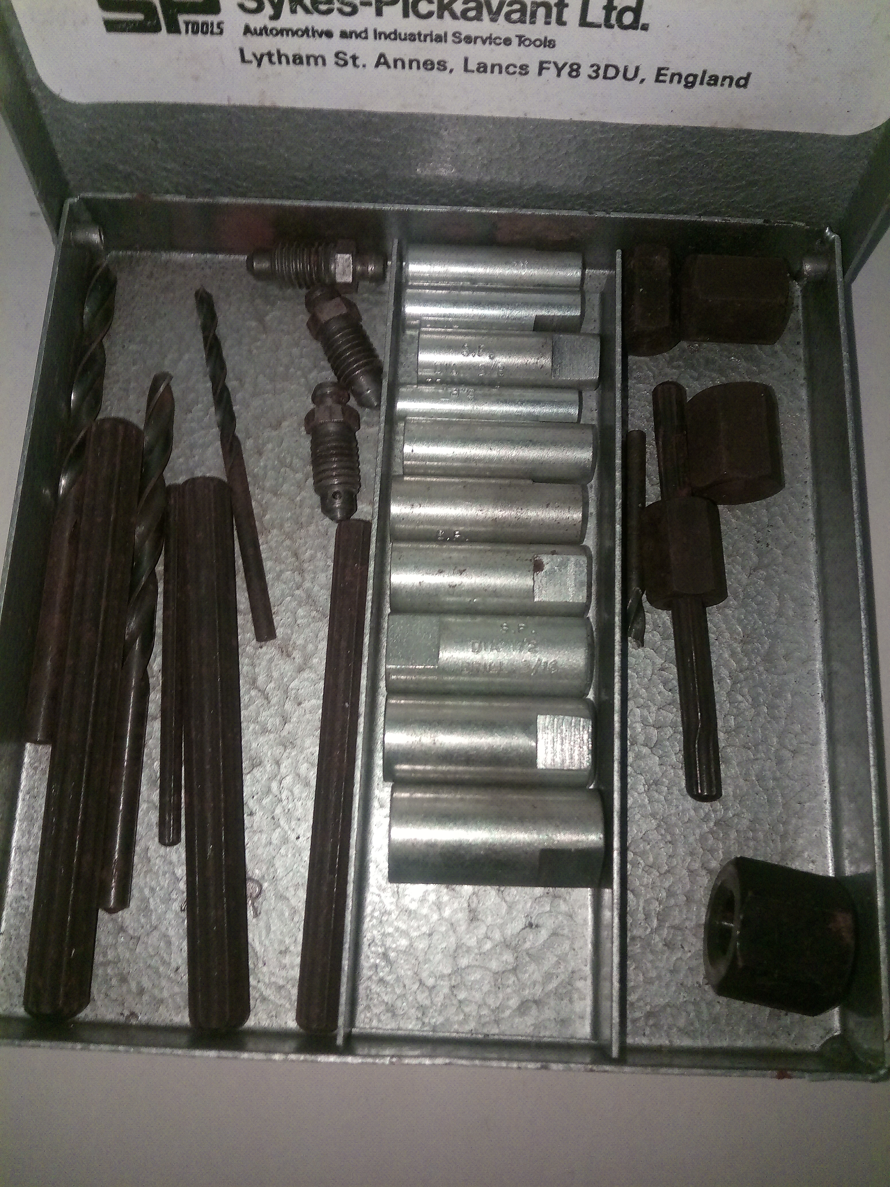

If you look at the items in the right hand tray ^^, you may notice a broken twist drill and that one of the broken thread extractors has been twisted at both ends thereby locking it's removal nut in place - this is what can happen when you loan tools to someone who might just be one of the 'ignoranti'.
I forgot to mention another tip re. removing a broken stud - some suggest using a left hand spiral/helix drill bit - the thinking being afaik that as you drill in, in a counter-clockwise direction, the force may unwind the broken stud, especially if the drill bit tries to snag/jam.
Not sure if this helps but it's from the Pininfarina manual..

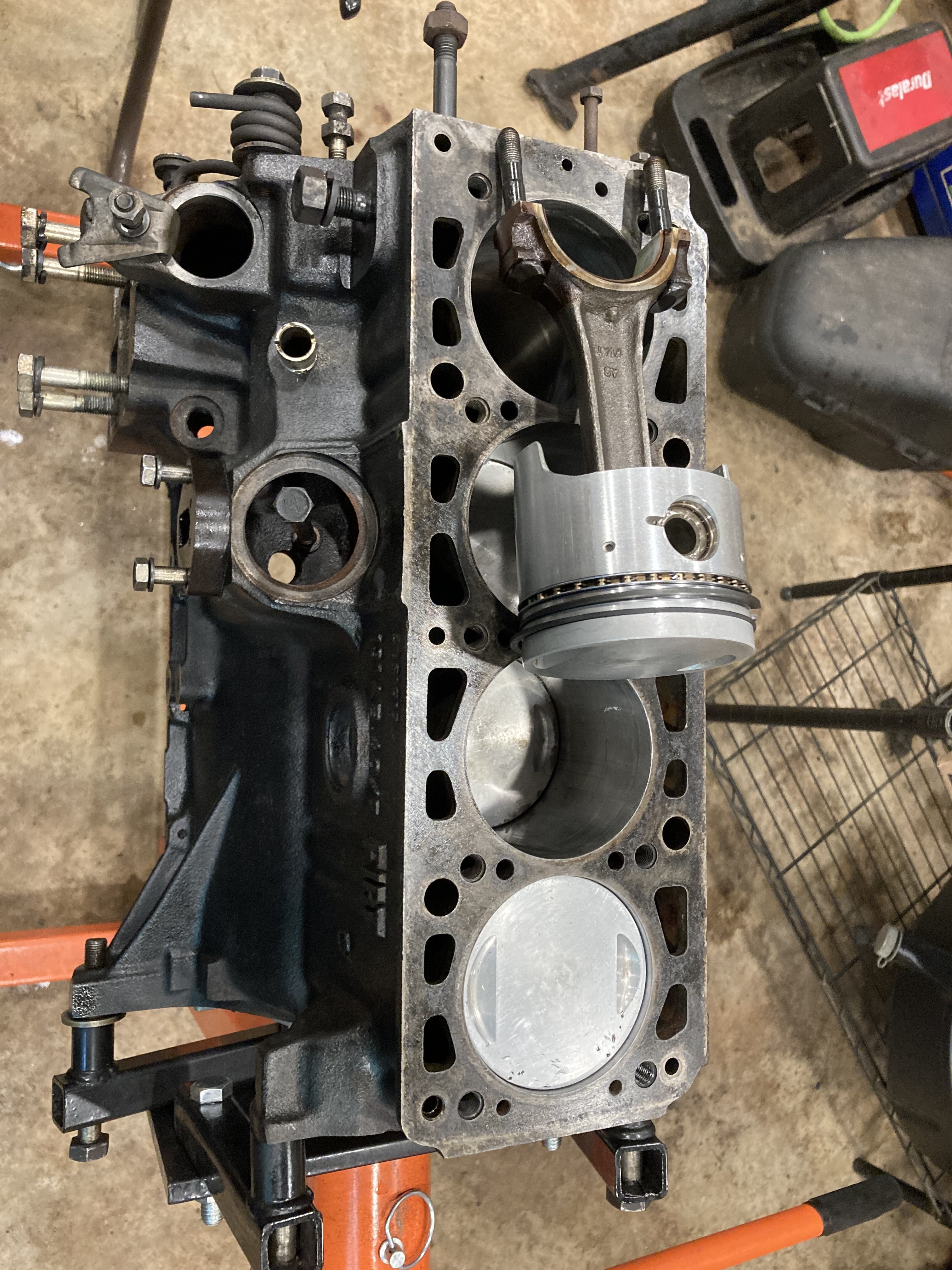

Greetings, good people. I’ve been away. I am back.

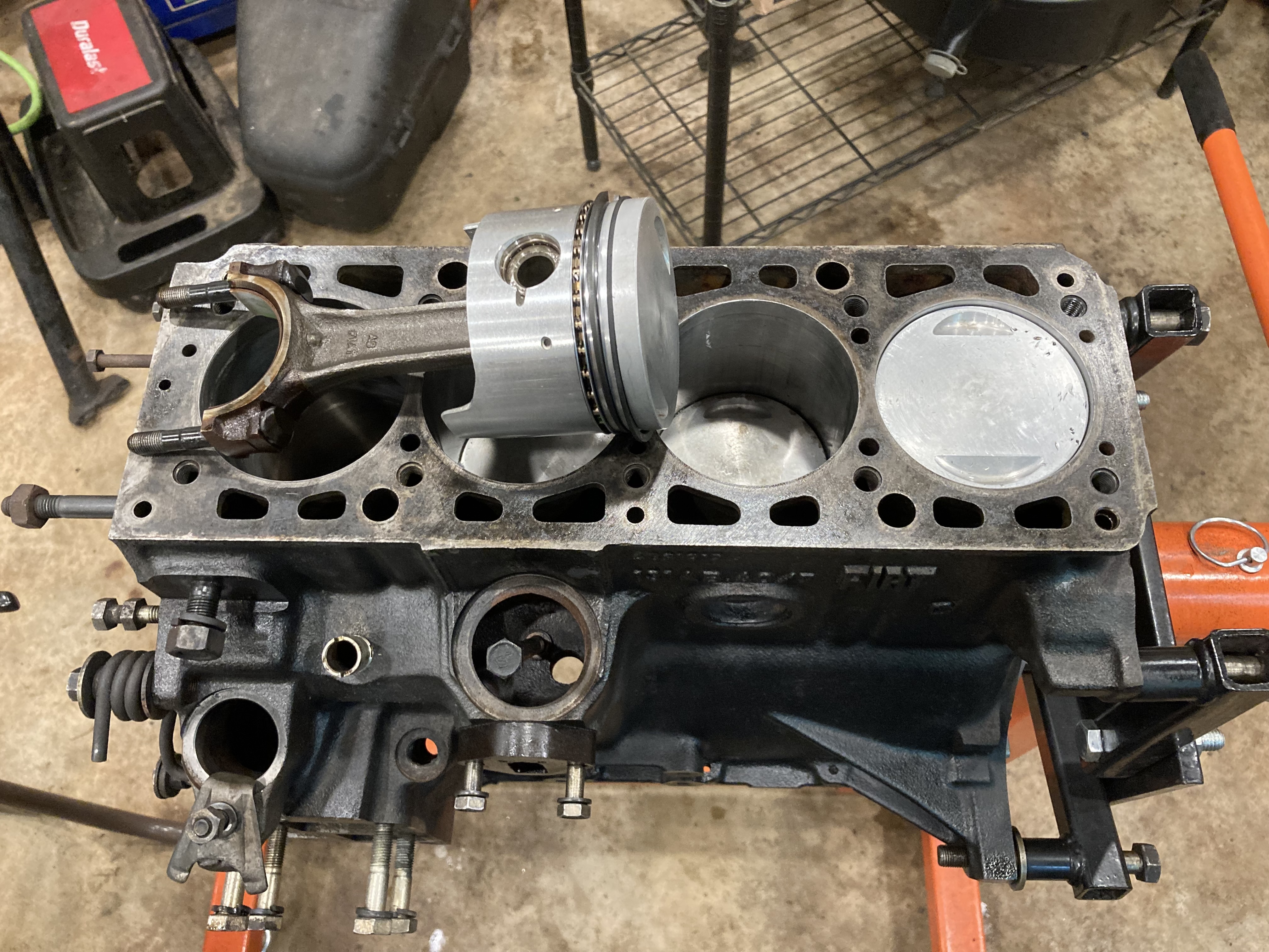

Pictured above: new rings on the pistons which have now gone in. I’ve worked the cylinders a bit more to assure (almost) no ridge and am going to proceed as if (laughing) everything is just fine.
Hope you all are well.

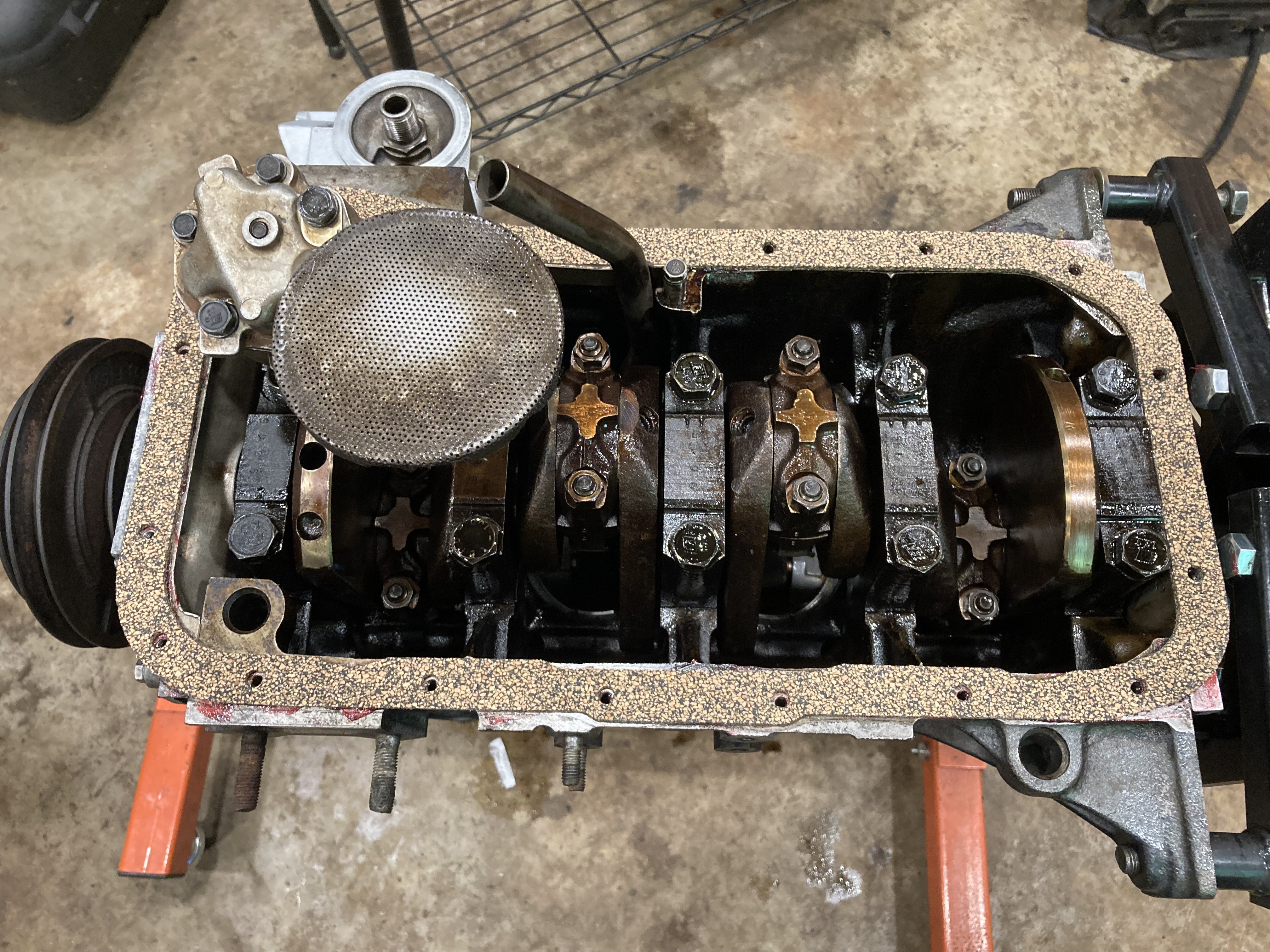

Reassembly is going slowly and smoothly. I had a moment of perplexity when I couldn’t find some bolts for the six shaft seal housing but then I discovered my well-labeled and orderly box of bits. I forgot that I was organized about that.
