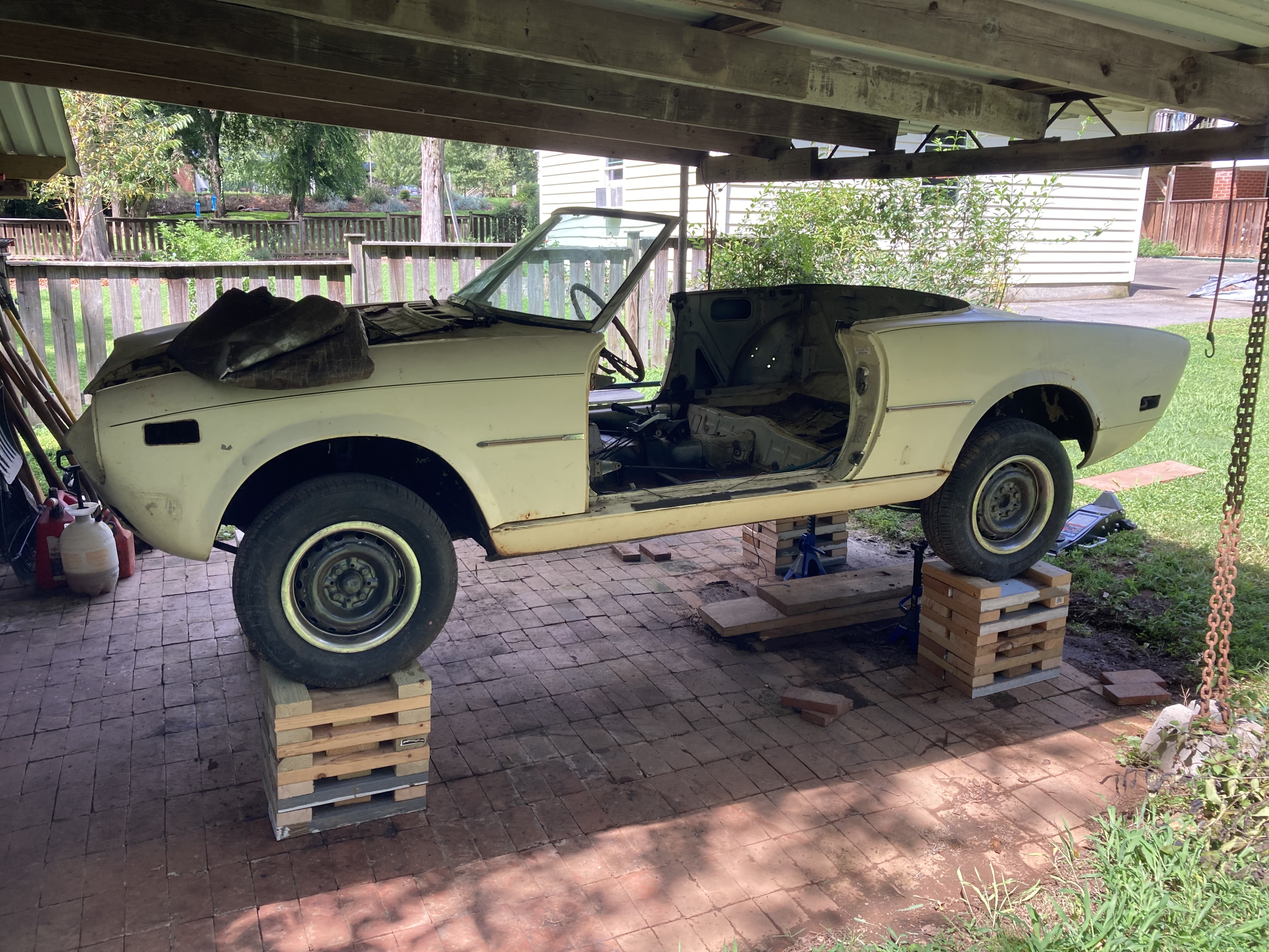

Elevato extremo for sure! I'm betting you can sit up and have a sip off your beer under there! I might be tempted to place a jack under the front crossmember, and rear end for added safety if your really wrenching on something...are you getting ready for metal replacement? Looks like a pleasant place to work!
Whats the plan with the bidywork?
Original or delete the chrome sidetrim and Fed spec side repeaters front & rear? Fiat 500 (old one) front indicators are about £12 on ebay and look way better. I bonded some blanking plates on with magic metal (to avoid welding distirtion) then filled and sanded flush
Aye - it is *very* nice as I am 6’3” and the interior (engine bay and floorboards etc) is now *so* much easier to reach.

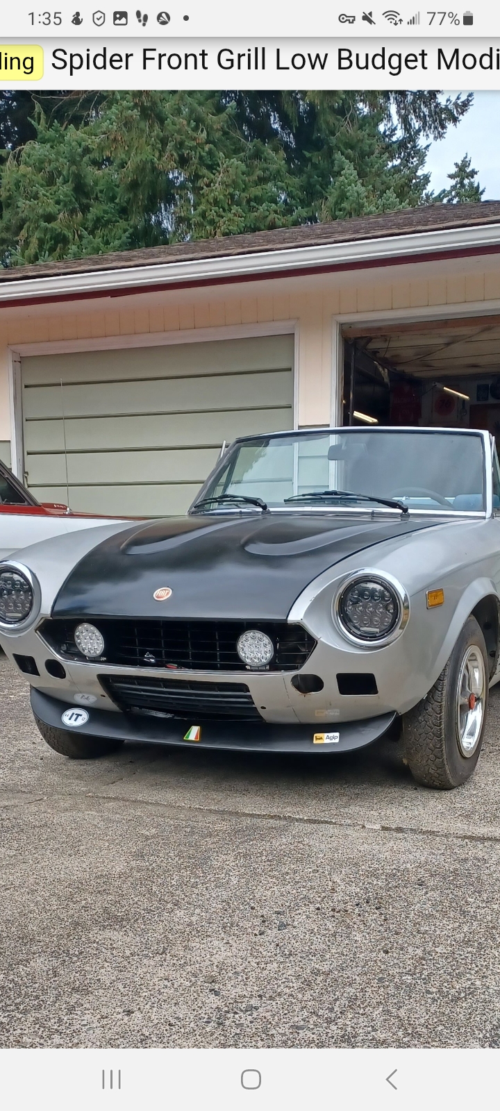

Spiders look soo much better with the front bumper gone...I took so much liking to the images twink80 posted of the fiat 500, 600 front turn signal lenses that I bought an ebay set yesterday, here's what my low budget front-end make over looks like, I'm going to mount the front signals in the bumper shock locations, and add perforated metal on the back side of the original turn signal locations...just another idea for you and the progress you are making is great!
P.S. front chin spoilers add a lot of eyeball !
P.S. front chin spoilers add a lot of eyeball ! View attachment 472281
Sounds like a good plan
For another idea you could fit brake ducts to the outer rectangular holes and make the apertures functional. Ebay stock kits (black plastic mouldings) which you can bond in with silicon and not damage the paintwork.
