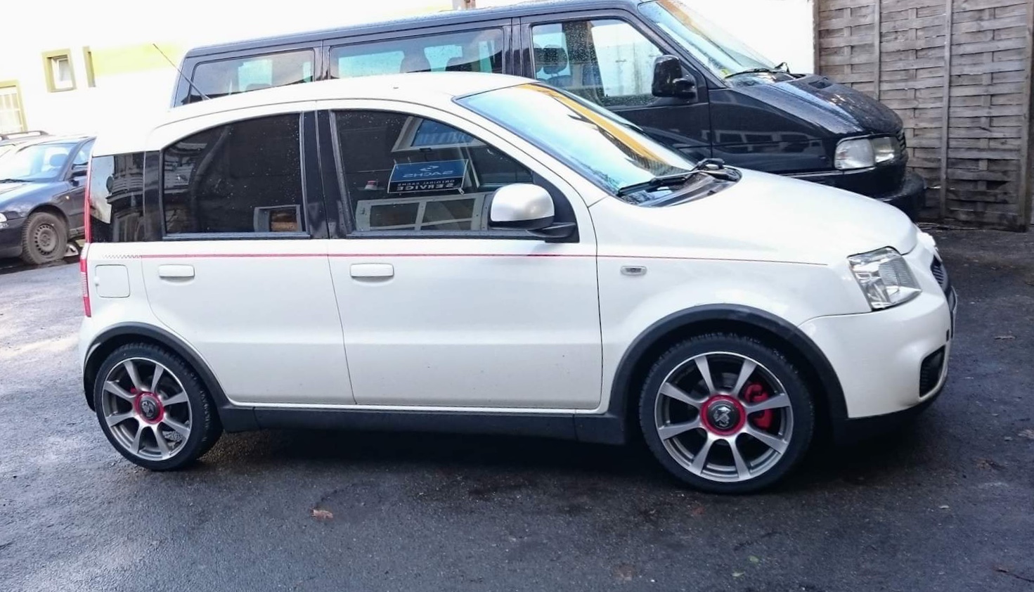

This looks great to me, the wheels look nice and snug in the arches. All things considered though i think I'll just pass and keep an eye out for 15s, thanks.
Yeah, nice and snug when it’s stationary equates to wincing at every fast bend, undulation and speed bump when it’s not. Another option is for the 16’s with 40 profile tyres, didn’t try this myself but this would give you the same rolling diameter as the 100hp wheels. Definitely don’t think it would improve the ride though.

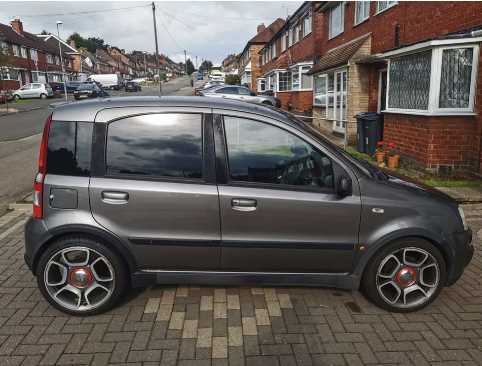

My 100HP has 15s with 50 series 195-50 tyres. The original 195-45 were hard as nails and utterly horrible. I can only guess at how bad 17s would ride. Then there's the potholes. You will never need to worry about worn-out - they'll have been potholed to death, along with the rims.
