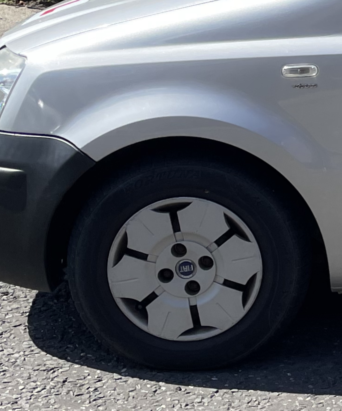

So, April rolled around this year, and I bought my grans old Fiat Panda. Its a 2007 model. I am thinking about future plans for the car being some new wheels (yo!) Anyway, its currently sitting on 13'' Steelies. (155/80/13) the wheels I have in mind to change to is the Fiat 500 rims, but they are 16'' - 3 inches bigger. Would anyone recommend this or is it worth just sticking with current rims for now. + if the wheel size is bigger, will the speedo need recalibrating because the wheels are bigger? - I have attached the rims I am talking about and the ones that are currently fitted. As far as I am aware they are both 4x98, which is the bolt pattern so they could fit fine? - i am completely new to 'modifying' wheels.
2) On a completely unrelated note, I was thinking about getting some Stance+ coil overs just to lower the car (but just enough so the tyres don't scrape and I can get over speedhumps sensibly) would anyone recommend these/are they any good? Again, attached pic of the coil overs themselves.

Hi and welcome:) Top car, hope you enjoy it. Check the rear axle isn't too rusty.
I can't offer much advice, but I'd suggest before you buy anything do some research on offset, tyre widths and profiles, and rolling radius to understand what you're doing.
For example, the 13" steels have a BIGGER overall circumference than the 14" alloys fitted to the 169 Panda due to the tyre profile.
Generally best to stay close to factory options. Have a look here: https://www.fiatforum.com/threads/wheels-help.508288/#post-4746095
Also worth considering insurance implications of fitting non standard sizes.
15" rims were fitted to the 100hp Pandas, anything bigger and you'll need low profile tyres, expensive and you might not like the ride. Has been done though: https://www.fiatforum.com/threads/17-inch-wheels.498294/
Good place to start would be visit the Panda mk3 section and search 'wheels', lots of previous threads on the subject.
This might be close to what you want to achieve: https://www.fiatforum.com/threads/wheels.428751/#post-4100309
16" is too big in my opinion
The profile on tyre will be so small it going to knock your fillings out, part of the suspension is the tyres

On the inside the ET should be stamped
Some of the 500 wheels are a very close match
Keep the ET close to the tyre width you want to fit, the steering will feel nicer, a couple of mm isn't going to make too much of a noticeable difference
ET41 155
ET38 165
