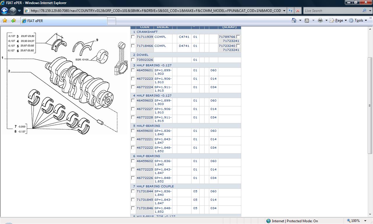

Was looking at the bearings for the cranks tonight on;
1.2 16v mk2
1.4 16v
1.1 8v sei
the bearings are all the same for the cranks.
1.1 8v cinq is different though, and haven't looked at 1.2 8v mpi, but is that the same as the cinq one then?
1.2 16v mk2
1.4 16v
1.1 8v sei
Kristian
You sure? I have mains and big ends different for all 1.1 and 1.2. Generally the shell thicknesses are the same, the diameters different. My source the Porter book. Yours?

ePER may be wrong, but surely it would have been corrected by version 40?
The actuall cranks DO differ (probably stroke etc), but looks like the shells on all 3 are the same?
Interesting. Looks like -- and it would make sense from a manufacturing POV -- the 1.2 was the big step (Porter gives the 8 and 16v as the same) -- and the 1.1 Cinq dimension became obsolete.
