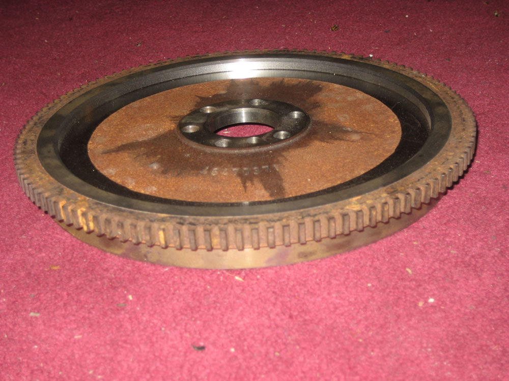

I got v2 of the flywheel back. Quite a lot off the back as I wanted. Now weighs 5.4 Kg, which is about what I want, so I'm happy. Quality of the work is great. Nice radius on the cut and everything. Plan to put whole lot back together tomorrow and go for a drive before it is dark.

I think 5.4kg is approx what i took mine down, all works well :)

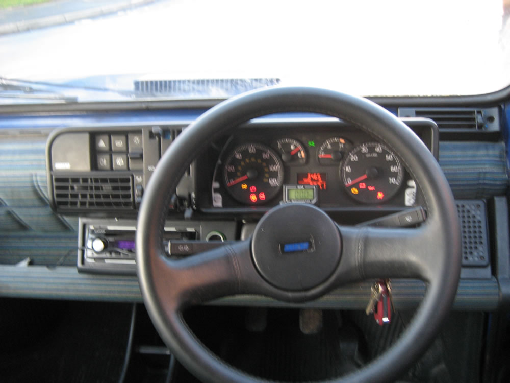

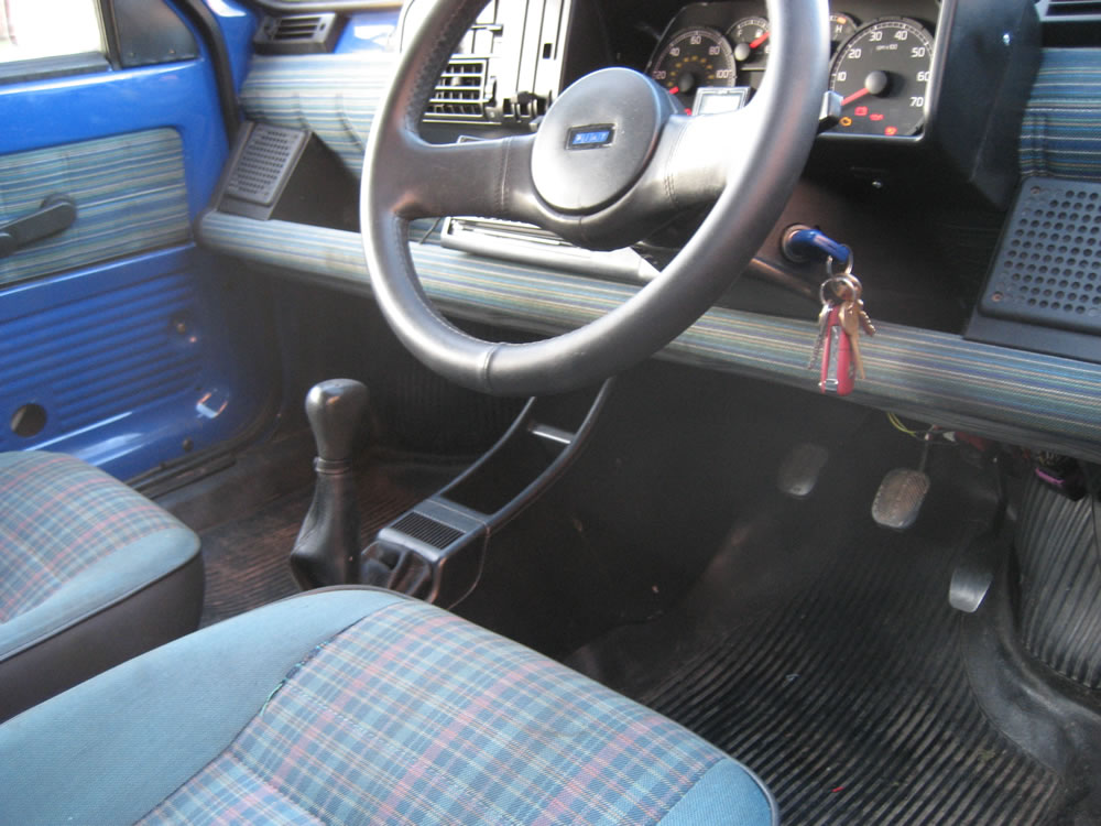

I also fitted a new gear lever and centre console from a late Lancia Y10. I put all the interior plastic back together and have an SPA digital speedometer wired up to the gearbox sensor. Expensive, but does the job very well. Does very accurate acceleration timing between any speeds and distance (1/4 mile) timing as well. The entire custom loom is now soldered permanently and covered up. Most people don't notice it isn't standard now. Even had a mechanic (who doesn't know FIATs) lifted the bonnet and he didn't realise it was modified when I questioned him later! All he said was, "I wondered why the airbox was chopped up". Fitted a Cinquecento Sporting steering wheel too.
I have a proper binnacle valance that will hide any nasty edges around the dial set currently in production. The digital speedo will sit in with dials where the orange clock readout is now. I have a dummy made up that proves the concept and looks neat. I have changed the bulbs in the Panda switches and levers with amber LEDs to match the dials. It looks like it's meant to be at night. Unfortunately the speedo backlight is green, although has adjustable brightness to try to match the dials.
