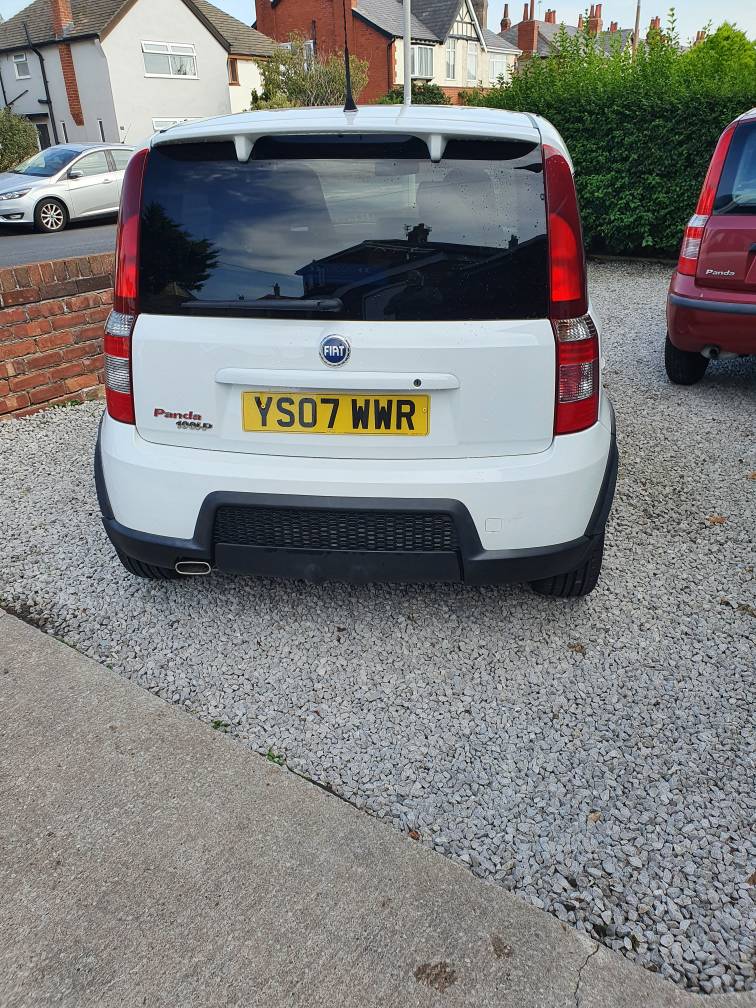

I know the 1.4 16v 500 is broadly the same underneath as the 100hp ...
But as the bodyshell is different... I just wanted to check if a 500 1.4 16v exhaust is the same dimensions, same mounting points and can just fit right in on a 100hp?
If not, is that due to all or just some sections (manifold/cat, middle section or back box section) being different fitments? Which ones?
Thanks in advance for your help

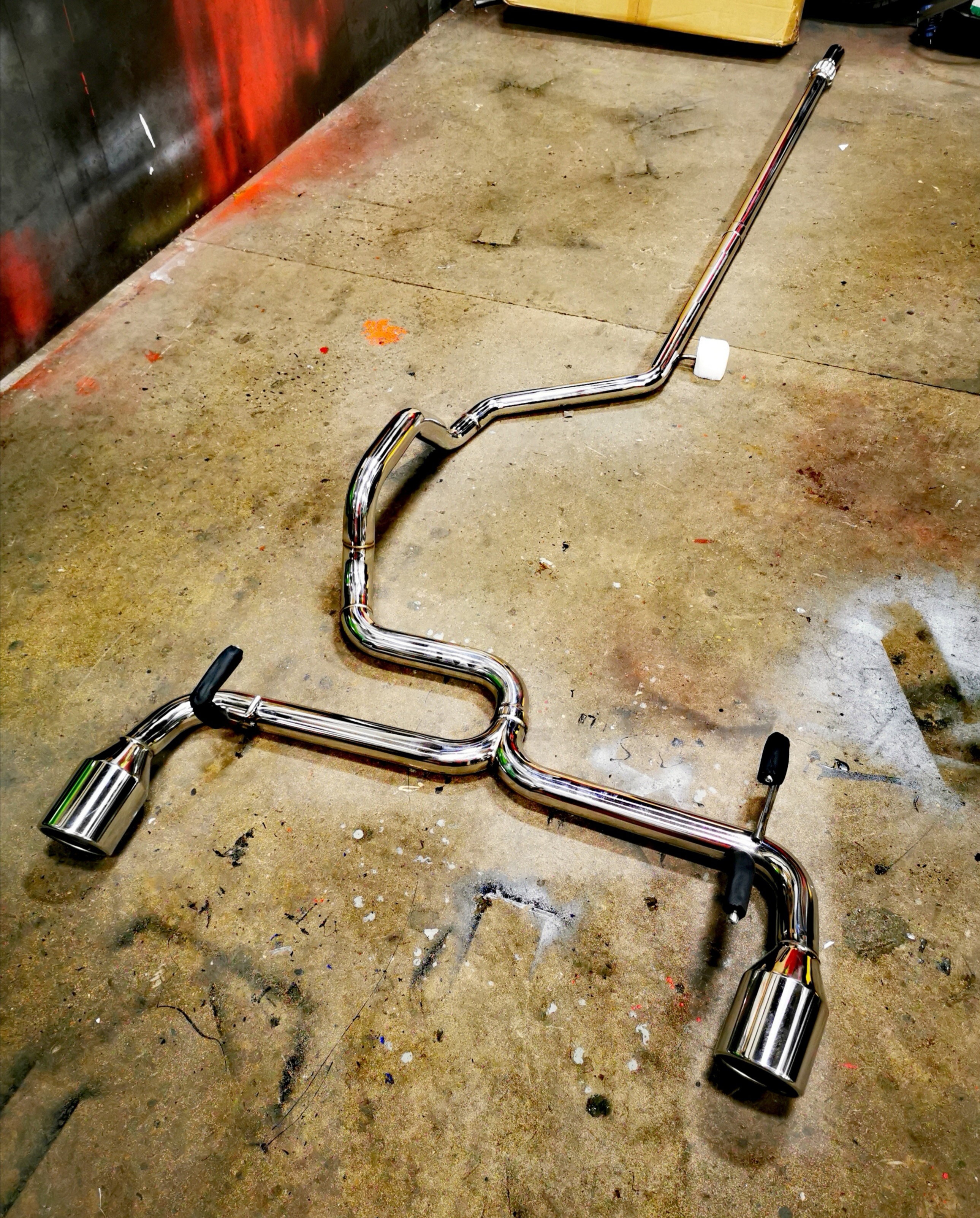

I'm fairly certain the physical shape and dimensions are the same for all the 500's and Pandas.
The only real difference I know of is that the bore size is different depending on which engine.....but if it's a 1.4 and 1.4, I'd guess it'd be the same.
I fitted a stainless exhaust made for a 500 Abarth on my 1.3MJ Panda with no issues.

Thanks.
For yours, that tip is the style of the 500 1.2. Have you selected that tip or is that the 1.2 system?
I think the 1.2 system is 41mm bore whilst the 1.4 is 45mm ? Is that right? Does it matter!?

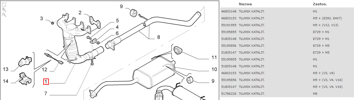

I can't get fully into ePER today but the 1.4 has it's own section with regards manifolds.
The picture shows all other petrol engined Panda manifolds, not one of the part numbers match.
Finally got into a Polish ePER, the 1.4 exhaust manifold certainly has a unique part number (51838402).
