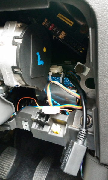

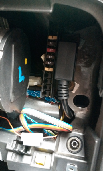

Here are some pics of the module and cables in place...
The connections required for the CAN Bus system are an Orange wire to the Switched 12V Ignition and Blue & Blue/White wires to Pins 6 & 14 on the OBDII Socket (hence the lead to save soldering to the original Fiat Loom)

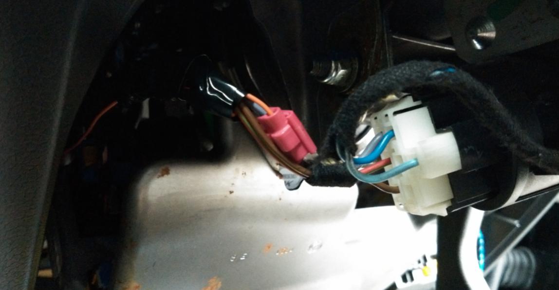

Then the Orange wire was connected to the IGN Switched 12V (I used a bridge clip as I didn't want to cut or solder the original)

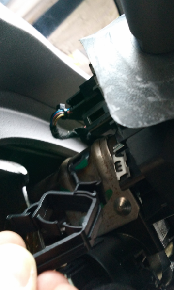

Then I drilled some holes in the lower section of the dash (out of sight) to secure the cables going to the Module form the Stalk and IGN.

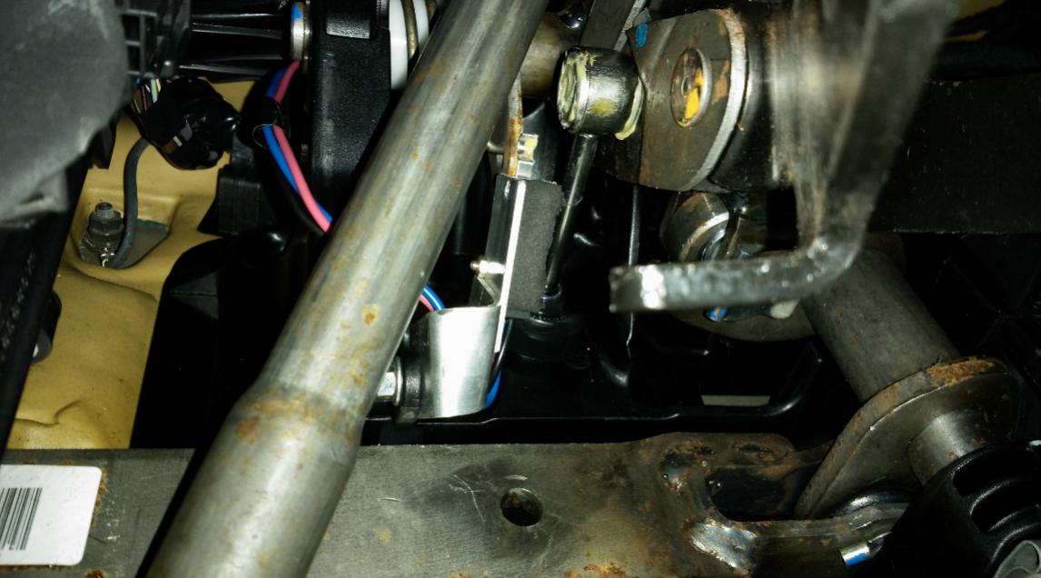

I have fitted a Microswitch for the Clutch Switch and found that I put one of the Stalk wires in the wrong position in the plug before connecting it.
With both those done it works fine.
Here is a picture of the switch (from RS). I used some of the B&Q 25mm Aluminium for a bracket.
