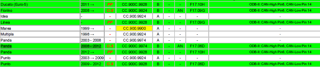

I have been doing some more searching and found an application list and it does seem to state that the Panda 2003-2008 uses the Analogue CC Kit (AP900) and the 2008-2012 Panda uses the CAN Bus one (AP900C).
Mine is a 2009 so in theory I should be able to connect to the wires that go to Pin 6 & 14 on the back of the OBDII connector.
Which should make things a bit easier...
Cheers.

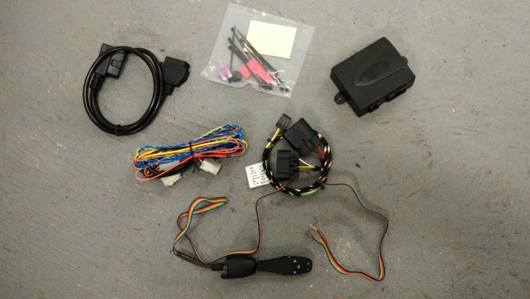

The Cruise Control Kit:
I'm not sure how the pics will upload so I may have to post in bits... and maybe it should be moved to a New Thread...
The Kit is:
1. AP900C (the C part means the Module is switchable between analogue and CAN systems - therefore suggest getting the C version as it does both.)
2. Command Module CM35 - Stalk with 2 memory function
3. Main Loom (standard with the kit)
4. Throttle pedal T Harness / Loom (Specific for the Panda but also does 500) Part No. 190-5002380
5. A OBDII Lead from Ebay (with a 90Degree outlet so it fits neatly behind dash panel) Plan to cut it in half and then just have the wires for Pin 6 & 14 CAN comms.

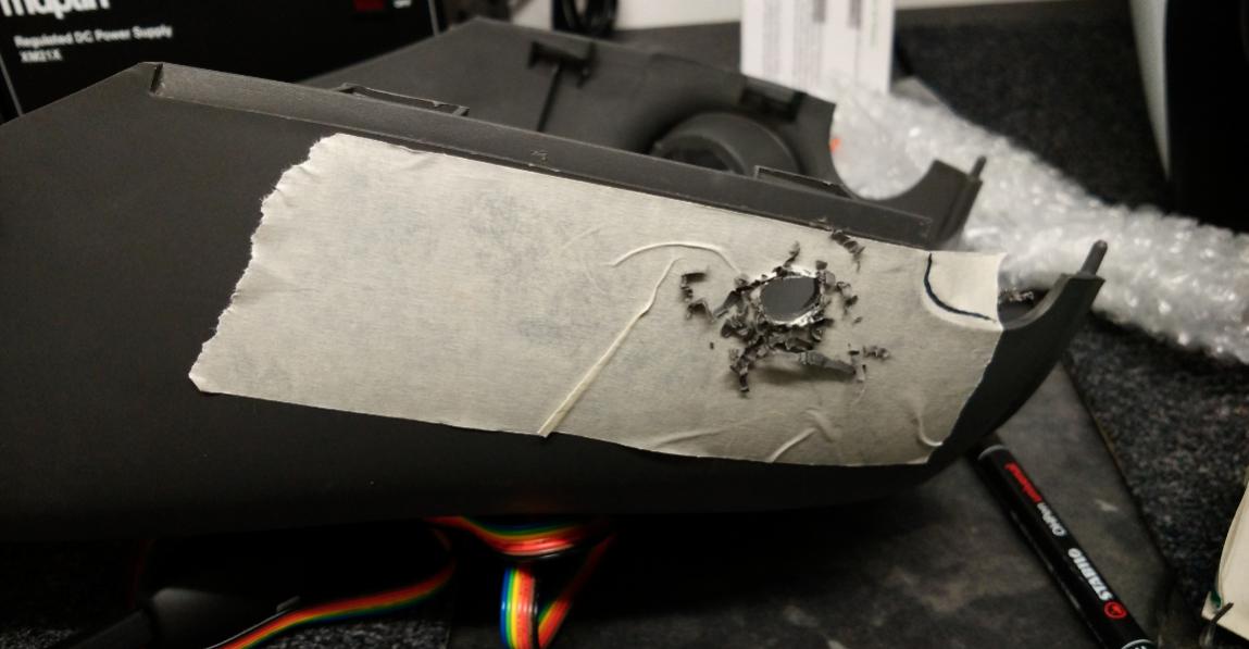

I next looked at the Stalk location and decided on trying to fit it on the lower Steering cowling as it looked the best option as clearance behind the cowling also.
Had to drill a suitable Dia 10mm hole. (I bought a second hand cowling from Ebay but it was a different design to mine - maybe an earlier model so was no good anyway. Although it did use it to mock up and try the stalk mounting)
The flat cable could be tucked behind the polystyrene padding.

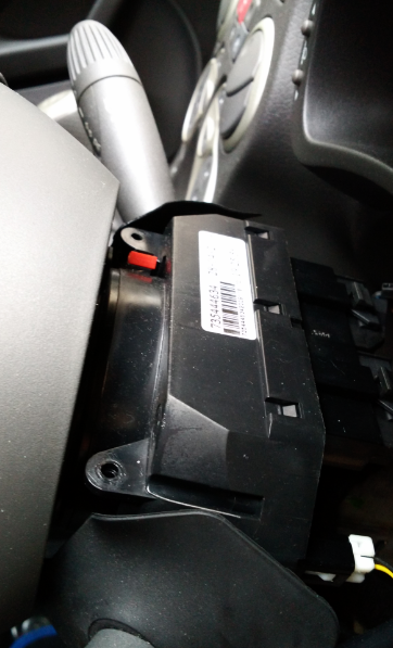

The lower cowling is removed first (3 Screws for underneath and then some awkward clips holding the top and lower ones together) then there are two screws holding the top cowl in place fixed from the under side.
I also had to cut away some of the strengthening web where the stalk nut was (used a small craft knife).

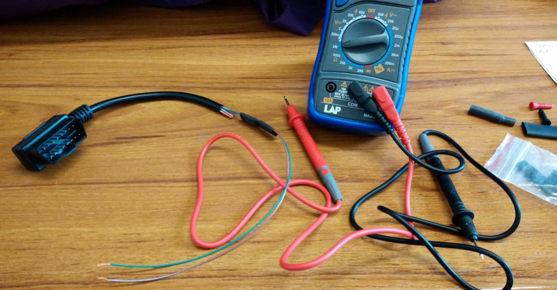

Next I modified the OBDII Lead to attach to the AP900C Loom...
I used a Multimeter to identify pin outs 6 & 14 and cut off the rest.
