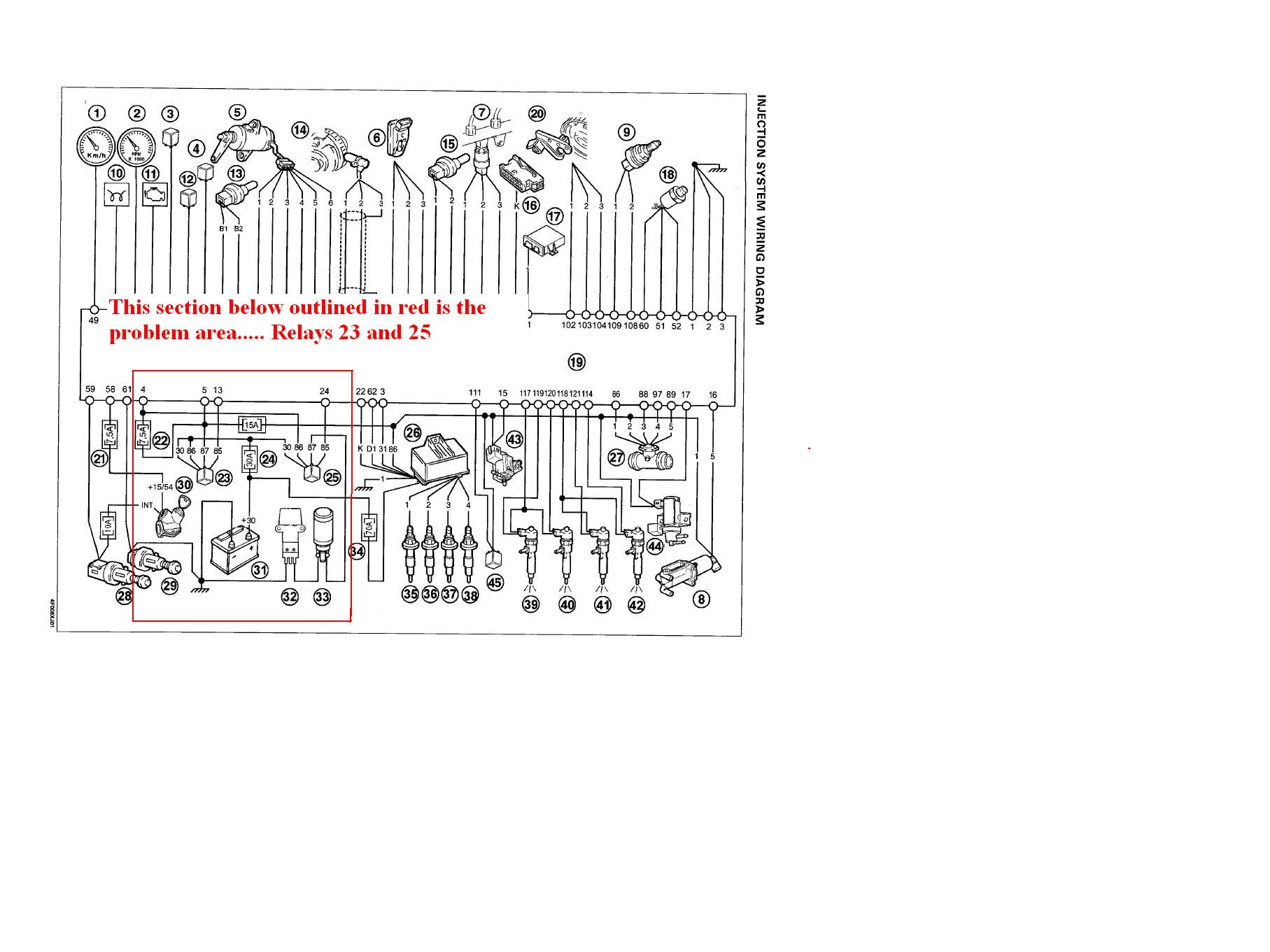

Its been a long day working on the 'Marea' again.....:(
This is getting a 'Bit Complicated' and involves the 'Black Art of Electrics'...
I have looked through a Marea pdf and have found the ECU 'Pin-Out' to describe what the relays do and what they are controlled by.
Relay 23 is the 'Main Injection System Relay'
Relay 25 is the 'Auxilary Fuel Pump Relay' ( the electric one in the fuel tank )
Traditionally the Relays are controlled by a trigger signal coming to connector number 86 and exiting the relay through connector 85. Pins 30 and 87 are connected when the relay operates to let the larger current circuit be connected.
According to the description...
Pin 4 is the Actuator power supply.
Pin 5 is the Injector / ECU power supply.
Pin 13 is the Injection Relay.
Pin 24 is the Auxilary fuel pump relay.
So Pin 4 on the ECU then operates Relay 25 and it operates Relay 23 which then seems to power the ECU at pin 4..:confused:....
Is this diagram wrong or is it too late in the day and I am tired ....relays seem to be powered by AND to power the ECU..which cannot be right..:confused:

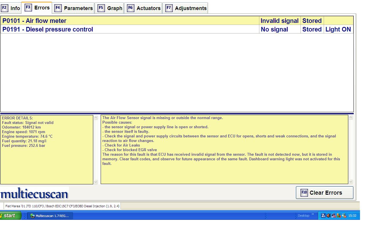

Attached is an image of a screen shot pasted across into the 'Paint' program.
But just in case its a bit small...the codes are:-
P 0101 Air flow meter...... not worried.....I can fix or replace that....
but the 'Killer' code that has been causing the 'Click' and turning off the engine is...
P 0191 Diesel Pressure Control .....THIS failure turns on the Red Engine Warning light and CUTS the engine.......Problem FOUND :D (y)

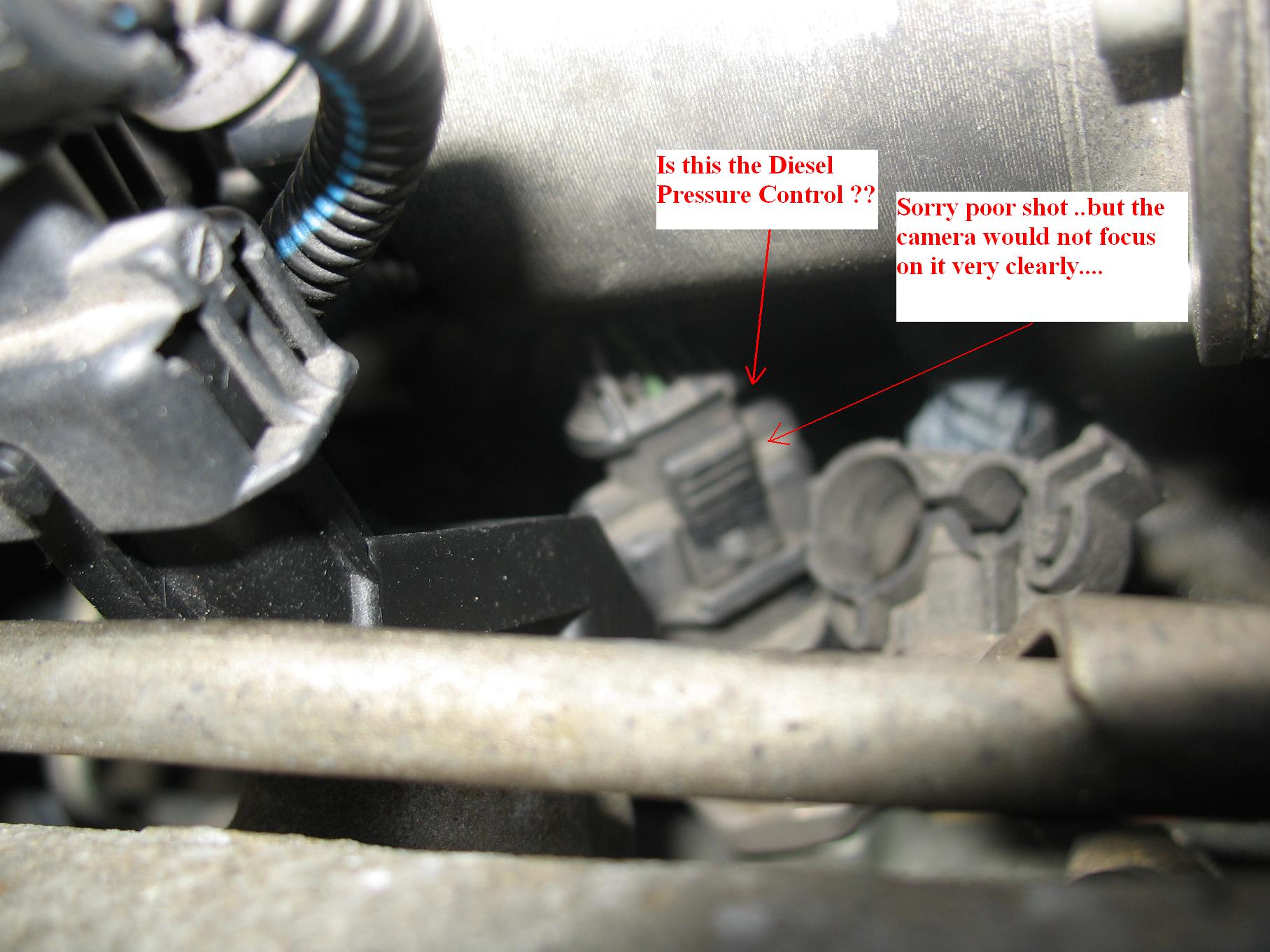

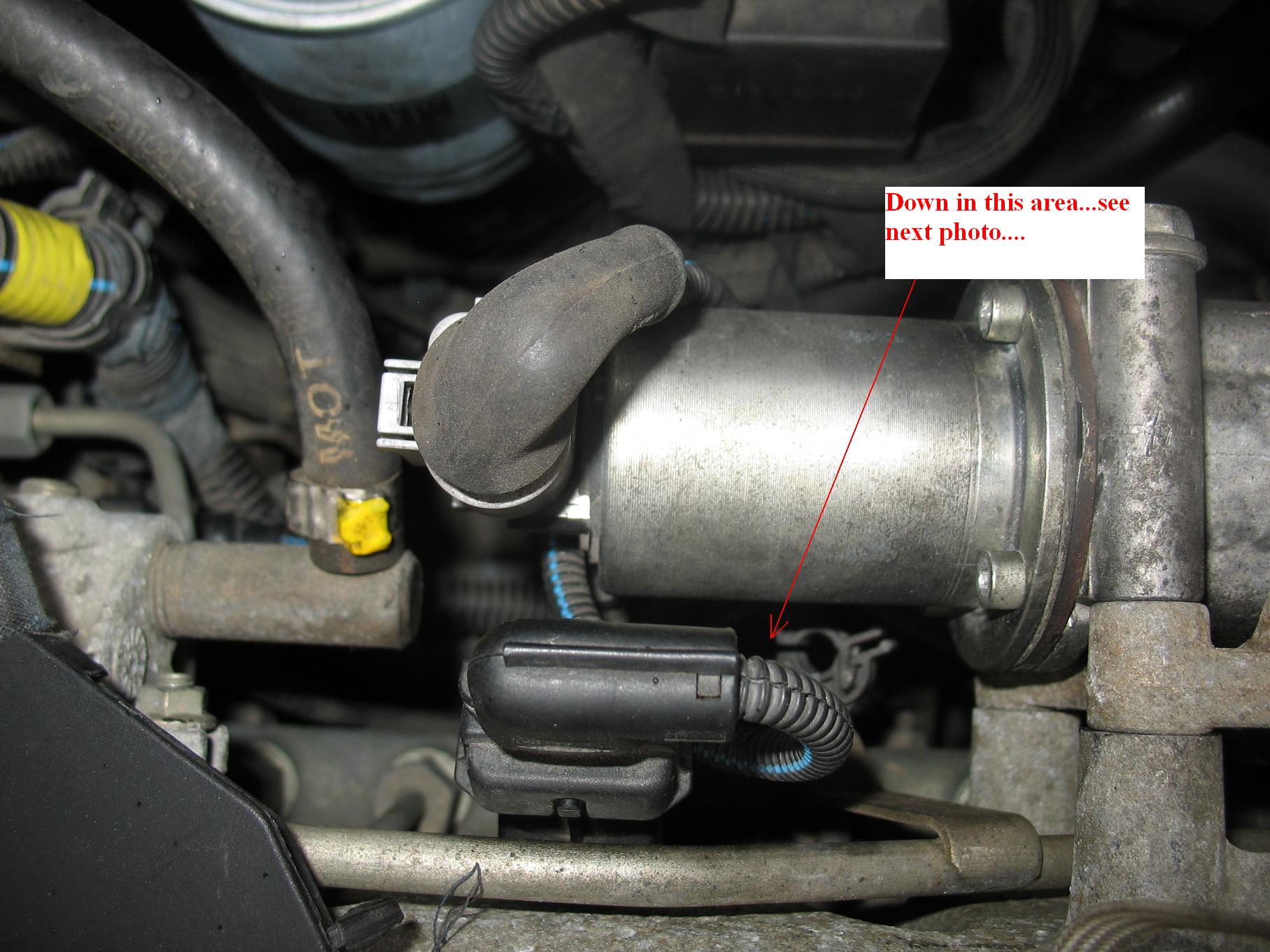

Now I think that it is this part in the photos below .... but please can someone confirm that it IS the part that I have put the red arrow pointing towards ?.
The 'Multiecuscan' is absolutely GREAT....ALL errors found and cleared from my previous 'messing about' .....Engine run up and air flow fault found within a few seconds.....then after a few minutes...the 'Click of Doom' occurs.... the engine is tuned off by the ECU and the fault is displayed almost instantly. So I need a new 'Diesel Pressure Control' unit to connect into the common rail fuel line.
We were within a hairs breath of scraping this car because the potential garage bill would have far outweighed the value of the car.....BUT...the 'Multiecuscan' has found the problem..so once the part is confirmed ( by you guys, please ...) I can buy a new one and the Marea is SAVED to run for another 100,000 miles..:D
Number 14 is the pressure sensor connected to the fuel line/rail in this picture.
Number 12 is the pressure regulator connected to the pump and the workshop manual has instruction on howto replace it.

I would also be interested what MES says about the fault (in the picture you have the maf error selected).
Hi Neverth,
It looks like 14 in the picture but mounted into the fuel rail the other way up.
I have the MAF highlighted because THAT was the error code when I took the 'screenshot' of the computer display screen . ( I guess that MES is the multiecuscan) I can try and get a 'screen shot' of the Diesel Pressure Control fault page but its not easy in the rain with a mains extension cable as the laptop has no battery :eek:

Here are 3 screenshots in Paint....The first shows the 'Diesel Fault Code'

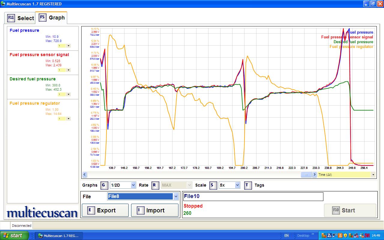

The second is one of the 'Recorded Graphs' with Fuel Pressure expected and delivered, the fuel sensor voltage and the fuel pressure regulator %......
It seems to be that the Fuel Pressure Regulator % is at fault and after it has 'bottomed out' at 1 % the ECU stops the engine with the 'Click'
Please can someone confirm the exact part that I need to replace to sort this problem out ?
Thanks in advance

I assume around the 249.8 second mark the engine shut off?
My guess is also on the pressure out of regulation -> engine shutoff.
The software description about the code suggests the sensor, but just looking at the graphs it looks more like the regulator cannot keep the desired pressure.
I would expect a faulty sensor to read too little, not too much pressure.
So number 12 on the picture.
In the downloads section on this forum you should be able to find workshop manuals for bravo/brava/marea (doesnt matter, same engine).
From there Volume 4 -> Engine -> 1910 JTD 2000 Range, on page 20 you have picture of the pump and the regulator, page 36-37 has instructions for removing and refitting the regulator.
Part number seems to be 0281002488, I would get one from scrappy for testing if you dont want to spend too much money on it.

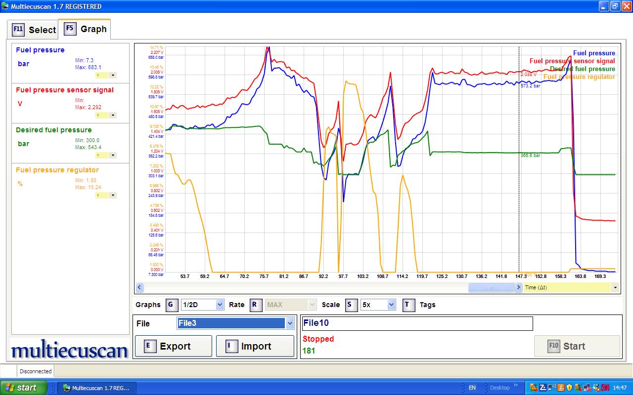

I replaced the Fuel pressure sensor with one from a scrap yard and still got the same readings........:(....and the car stopped...:eek:.....
Then I looked at the graphs more CLOSELY ... Look at the Fuel Pressure regulator reading.....It drops to 1 % and then the 'Actual Fuel Pressure' starts to climb and to deviate wildly from the 'Required Fuel Pressure' and so it all goes wrong....
(I think that you were right... Neverth.....The Fault Code was the pressure sensor...BUT the Fault itself probably lies with the Regulator ! )
I plugged the 'MultiECUscan' into a Fiat Doblo 1.9JTD...and got the second graph.....Look at the difference in the 'Fuel Pressure Regulator' Percentages on the two graphs!
Comparing the two it now looks to me like the 'Fuel Pressure Regulator' is actually to blame for the fault...so I am getting a replacement one from a scrap yard and I will try again in a few days once I get the part and I will update you all accordingly...

Multiecuscan connected and engine started ......and...It ran PERFECTLY(y)
The required Fuel Pressure and the Actual Fuel Pressure NOW work very closely with the Pressure regulator varying its percentages as the engine ran through the rev range and for well over 45 minutes with NO problems....
