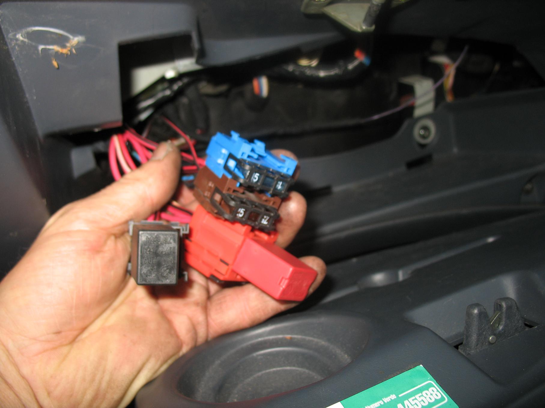

Suddenly the engine died...I started it again and listened and 'click' the engine died again......its this BLACK 20 Amp relay here (one of 2 inside the glovebox ) that just clicks off and the engines stops.The other red one is the main immobiliser powered relay at 30 Amps.
I have replaced the relay with 2 other second hand ones but it made no difference and after a few minutes it still just clicks and the engine dies. The time that the engine would run for got less and less with each test.
I even simply 'Bridged' this relay with a piece of wire which makes the electric fuel pump run without the ignition being on and connected a relay to join the two signal wires.....but after 20 seconds the relay clicks and the engine dies ( still with the fuel pump running ).
Obviously the main part of the relay operates the electric fuel pump...
Does anyone have any ideas where this relay is actually powered from and what else its powering wires might operate ?
