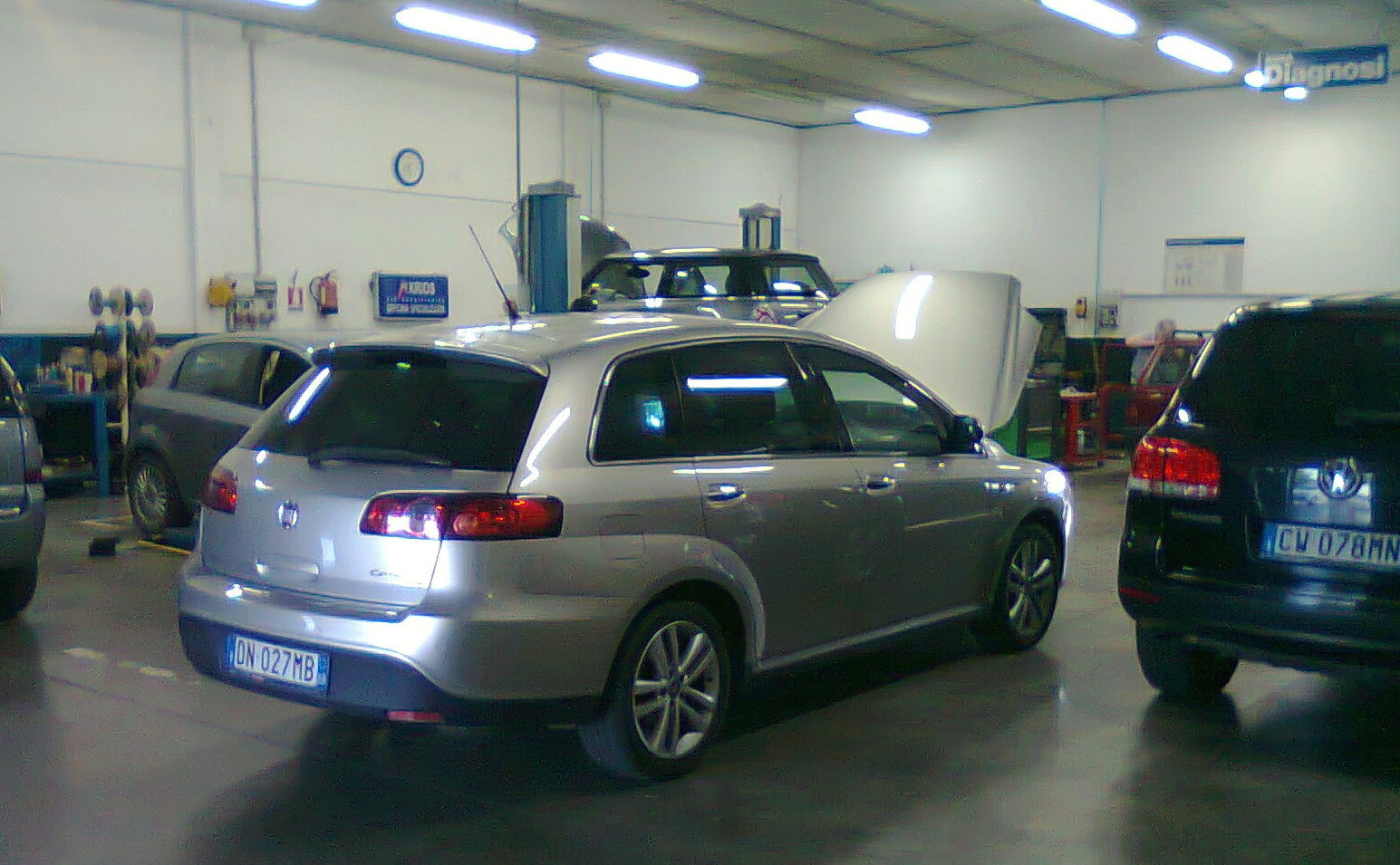

Well, after a good run Monday with no hesitation, stuttering etc problem appears fixed. Unfortunately after filling with diesel the amber 'Check engine' warning light appeared. However, all seemed OK with car so drove it home with no problem. Warning light kept coming back on though so took it back to garage this morning. They eventually could take a look and run tests, but as usual they are not very talkative but it was fixed. Light does not now come on. We were told that (and showed) the EGR gasket was the problem and that it may need the EGR blanking off and the ECU software modified. Something we had previously mentioned. Lost in translation, we do not know for sure what is actually fitted now, suffice to say that some minor hesitation was felt after leaving garage. Almost back to square one. Being Italy, they take their holidays next week for a week and the garage will be closed. Could be a problem, but they have offered a courtesy car if we need it. (yes). Will be in contact with them tomorrow. It is just becoming so tedious, wasting our time and costing lord knows what now – all because of some stupid EU directive.
Anyway photo attached of sad Croma in garage...
