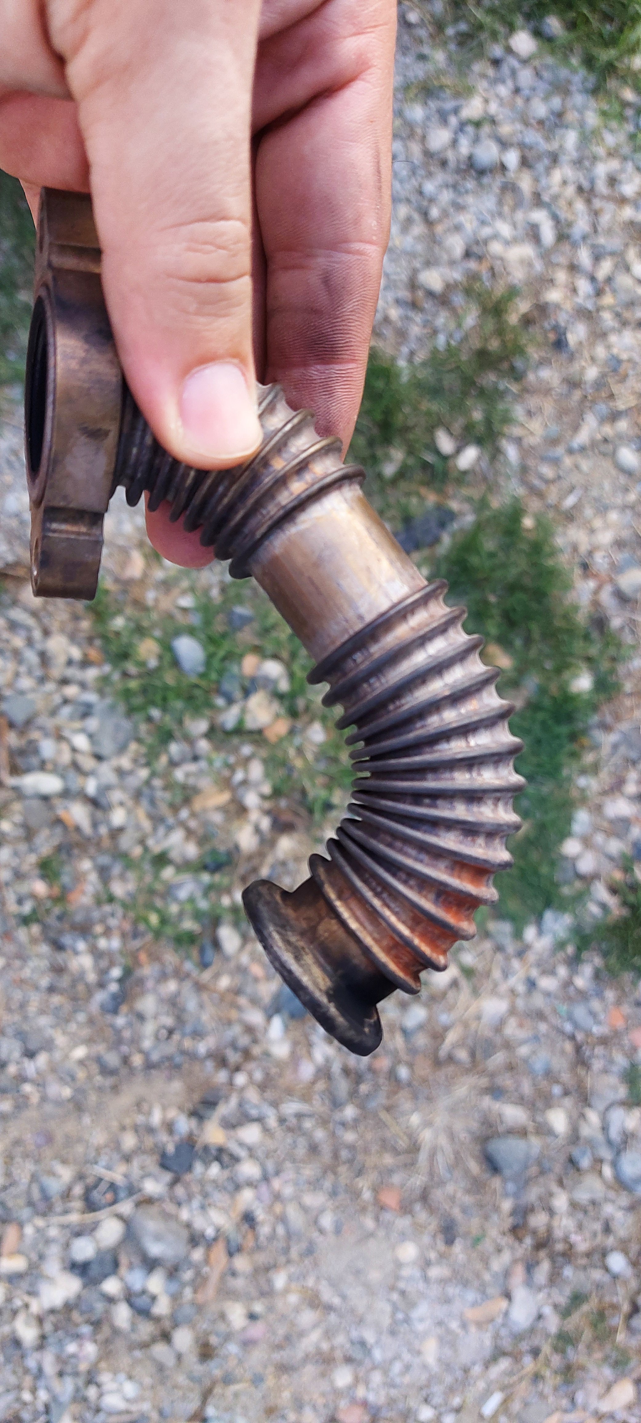

This didnt resolve totally the problem. I have changed this metallic hose but now the car wont go over 90 km/h with 2000 rpm in 5th gear. In 3rd gear it wont go over 2750rpm at 70 km/h.
Any new idea?

After all repairs, it was DPF filter clogged, again. The first mechanic didnt put the sealing of EGR in correct way so it looses air. Then it broke a metallic hose of EGR. During this time the DPF was clogged and it wont went over 90 km/h. Now that all the systems are fine, the turbo has started to whistle, a sign that is near breaking. In this moment the car can go near 130 km/h with some difficulties. Lets hope the turbo will last some time because this car has pissed me very bad.
