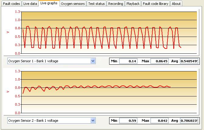

pre cat lambda should oscillate between around 0.15v and 0.8v almost every second at tickover
(Don't just buy a new one if it doesn't, it may be quite correctly stating the air/fuel mix is wrong)
It should look similar to this top trace on tickover
