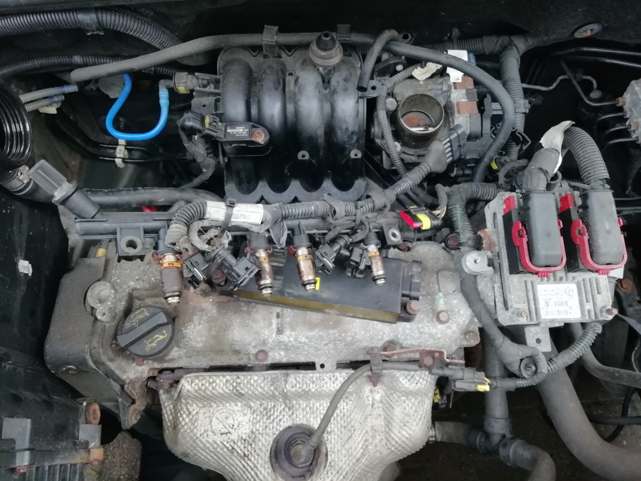

Had a go at swapping over the injectors. Still couldn't get the fuel line off, but was able to get enough access to flip the injector rail over and access the injectors. Some petrol spileage but not a lot. Not being certain which injector was #2 I swapped the middle two over.
My multimeter battery is dead so I couldn't do any tests on the wiring on the rail harness.
When I turned the engine on after the swap, it sounded a lot worse. Like it would probably stall if I did rev it a bit. Checked the fault codes and now I see both P0202 and P0203. I didn't clear the previous fault code, so hopefully this is normal and doesn't mean that both are now faulty?
Oddly, unlike last time the fault was there as soon as I turned the ignition. Last time I'd disconnected the battery and the fault went away until I'd driven the car a little.
Conclusions? If the fault codes accumulate, then P0203 suggests the fault moved with the inector so injector #2 is bad. If the previous fault code should have cleared itself, then my man-handling has damaged wires on the harness for injector #3 as well.
Some photos attached of the injector rail pulled out and inverted but still attached to fuel line and that pesky fuel line connector - looks like you should just press in the tabs at the side and pull off, but it wouldn't budge.

You're on the right track. Now use code reader to clear the fault codes and run the engine to see which of them reappear.
There are few options:
  1. Swapped injector on 3rd cylinder is indeed faulty
  2. Unless you have installed it poorly or damaged the wiring
  3. p0202 should not reappear after fault cleared
Cleared faults and P0203 came back so it looks like it's the injector itself. New one ordered. (y)

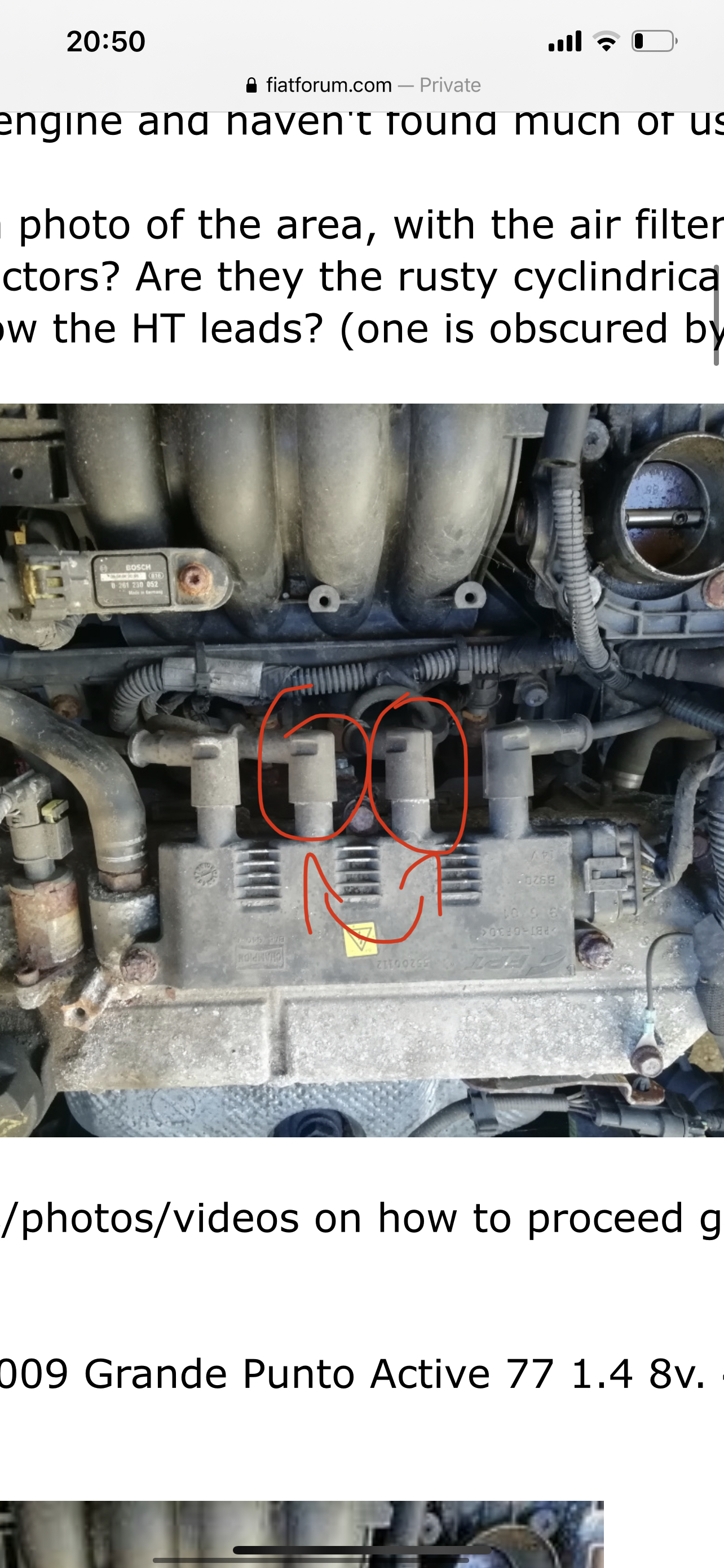

Hi all Im having a P0302/P0300 error coming up. To check the 2nd cyclinder can you simply just swap the 2 plugs as shown below and start the engine and scan the OBD? Thanks
Dude, don't be fool. That's ignition coil. If you mess those leads up, it'll cause severe engine damage. Don't do anything if you don't really know what you're dealing with.
What you should try is to replace all the spark plugs, ht leads and if it continues, change the ignition coil too. In the meantime please search google and these forums with those misfire codes because that is a misfire code which is probably not related to fuel injectors and to this topic.

The spark plugs were changed 2 weeks ago so it's not that. The engine light flashes when I go above 65mph and stops flashing when i decelerate below this speed.
I was looking on youtube before and many people were willy nilly changing the ignition coils to see if the error code changed cylinders (i.e. po302 to po303). That is what i am asking how to do and if changing the plugs in the pictures will have the same effect of changing the code. Ive searched all over this forum and no one has done the swap test for a grande punto thats everywhere on youtube. Many people are doing multimeter tests instead.
I know it's a misfire, semi related to this thread. Any other bits of advice?

This has casette type ignition coil which cannot be tested the way you intend to. If they were separate coils, then it'd possible to change only one faulty coil. This time you need the change to whole thing if you think the ignition coil is faulty.
There's a very good reason why you don't want to swap those on this type of GP which i mentioned earlier. Unless you really hate the car already and want to scrap it afterwards. Cheapest thing would be to replace all the ht leads. You could also check that they are indeed installed properly.
There still is possibility of other things like worn engines, faulty headgasket... among other things.
