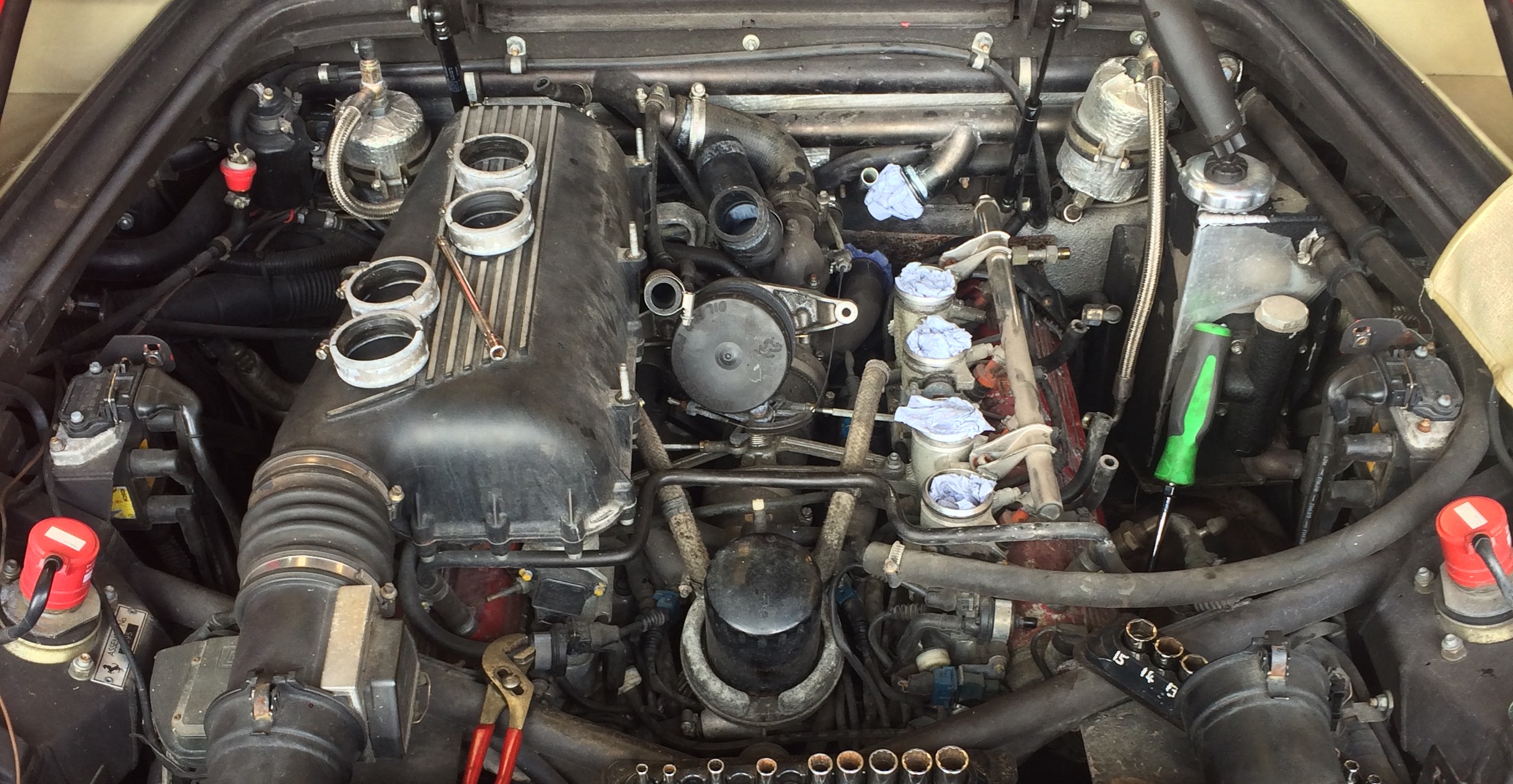

What I want to know is, apart from a guy on facebook (he's on here somewhere but I don't his name or what to search for to find his posts) has anyone managed it in succession with real world driveabilty? If so, what ITB's did you use and did you have to take out the heater matrix and crap?

ITBs... well they sound cool, they don't give the huge power people think but they will drive nice and sound epic if setup properly.. The question has to be asked though, why if going to the effort would you not ITB the 16v?

blu73 I know they don't give the huge power increase that everyone expects but seeing as I'm running single point I'm still expecting more power than its currently putting out. And regarding why I'm choosing to do it to my current engine rather than the 16v is mainly down to the fact that I have limited time and I'm hoping to keep my heater system by making my own filters and to be perfectly honest I want to be different and the 8v is a lot easier for me and my dad to make a standalone system for the fuel injection. And I don't particularly know much about 16v engines in general apart from the golf 1.8 and 2 litre

But getting it in there with the heater box and ITBs is totally doable, Jamie (Todger182) managed to get some in on a 1.4 16v so it shouldn't be all that hard. Here is the thread, ITB stuff starts from this post although if you want to read from the start its a good thread. https://www.fiatforum.com/members-motors/237628-chalky-1-4-16v-itb-seicento-5.html?p=2789378

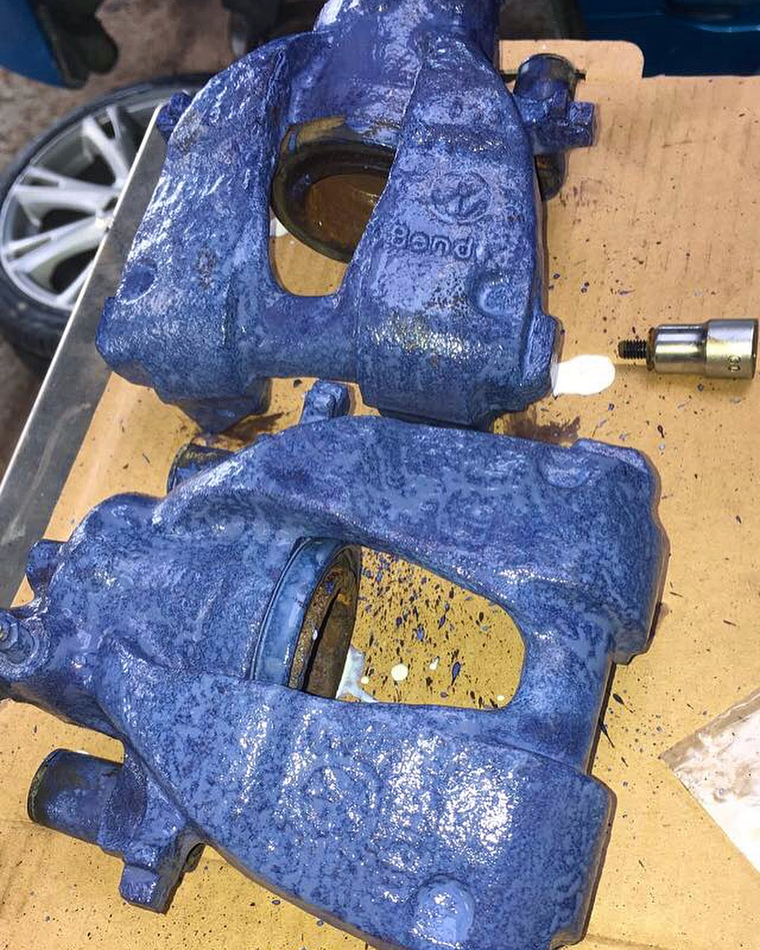

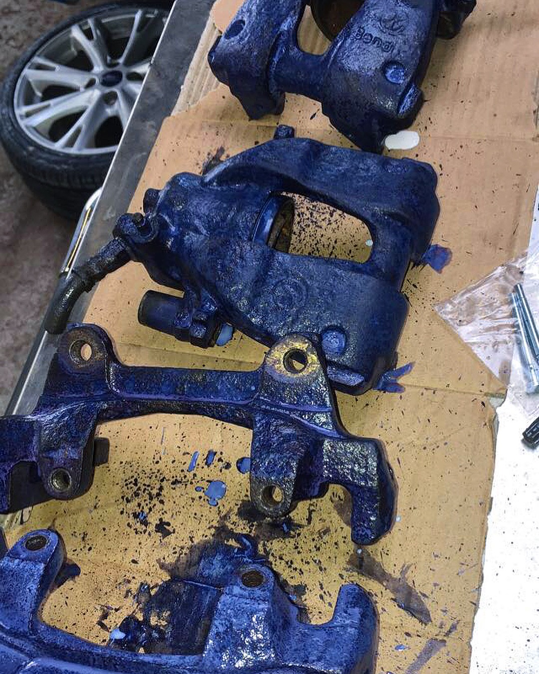

As some may have seen in a previous post asking about brake carriers, I have finally been given the calipers and carriers from the bravo and test fitted them before ordering anything else. So they will be painted and rebuilt ready for when the parts procurement manager gets me a price in work.

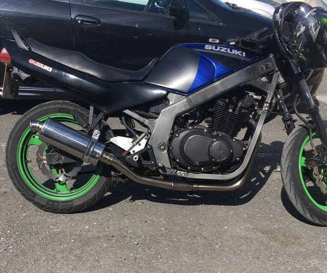

That’s all that has happened really as the motorcycle has had the worst running problems I’ve encountered but that’s what happens when it’s 23 years old and running carbs I suppose.
Some pictures of said callipers etc, only rust treated so far whilst a paint colour is decided but it’ll either be black or silver as well as the steering wheel.
And slightly off topic just to show it, the bike is also pictured. Sporting the green wheels too
