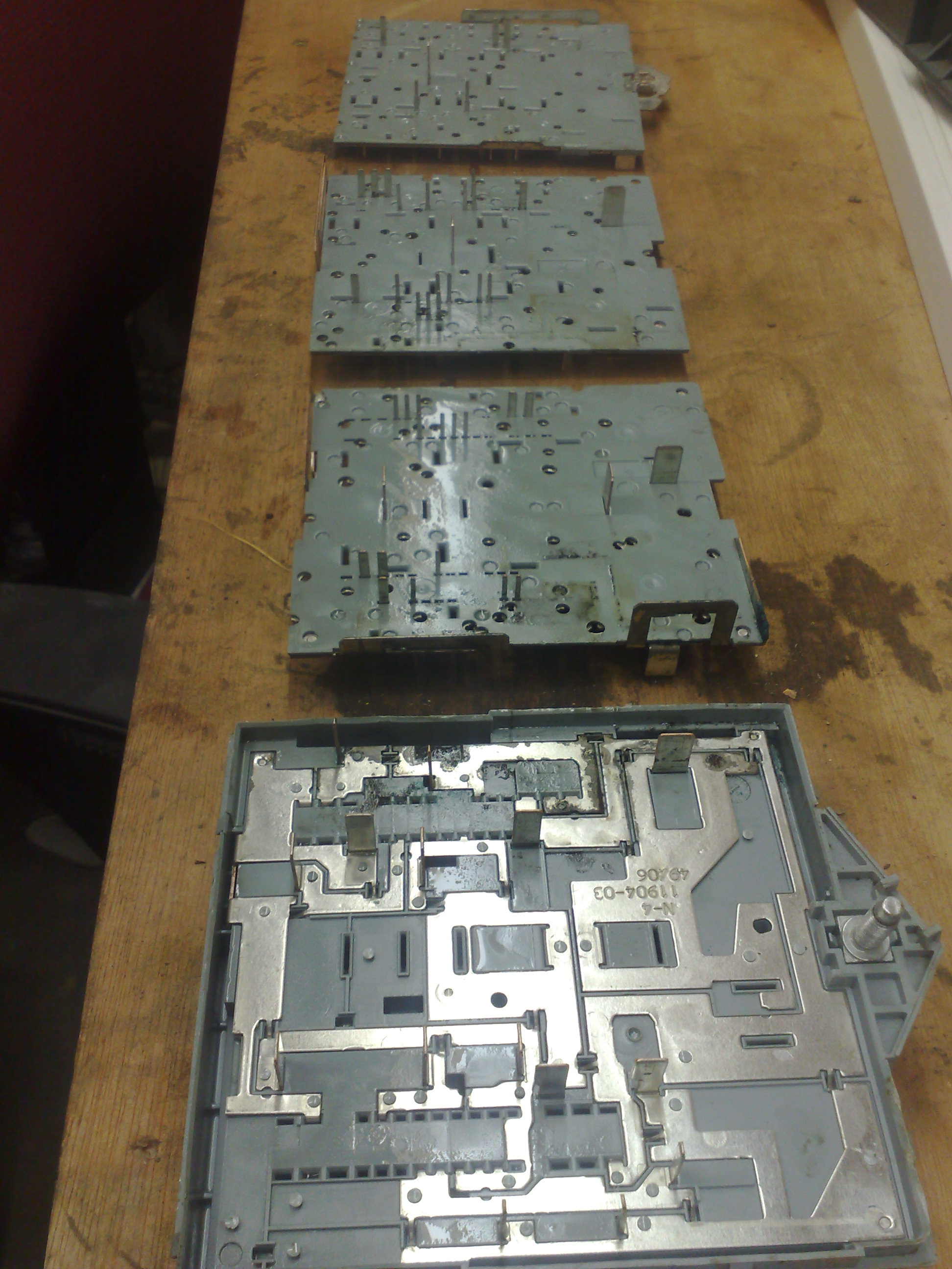

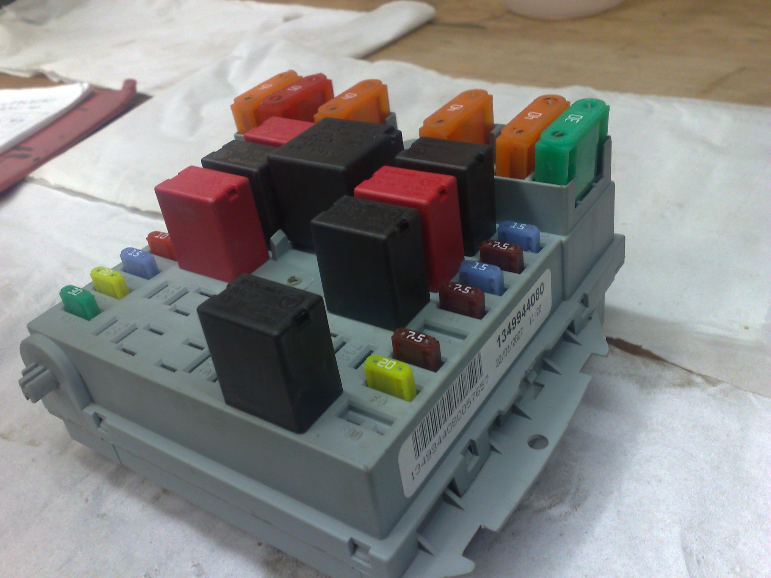

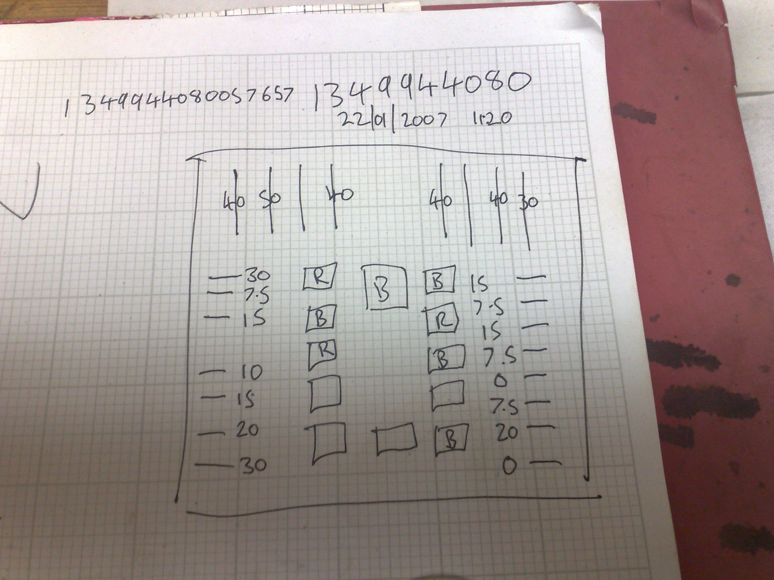

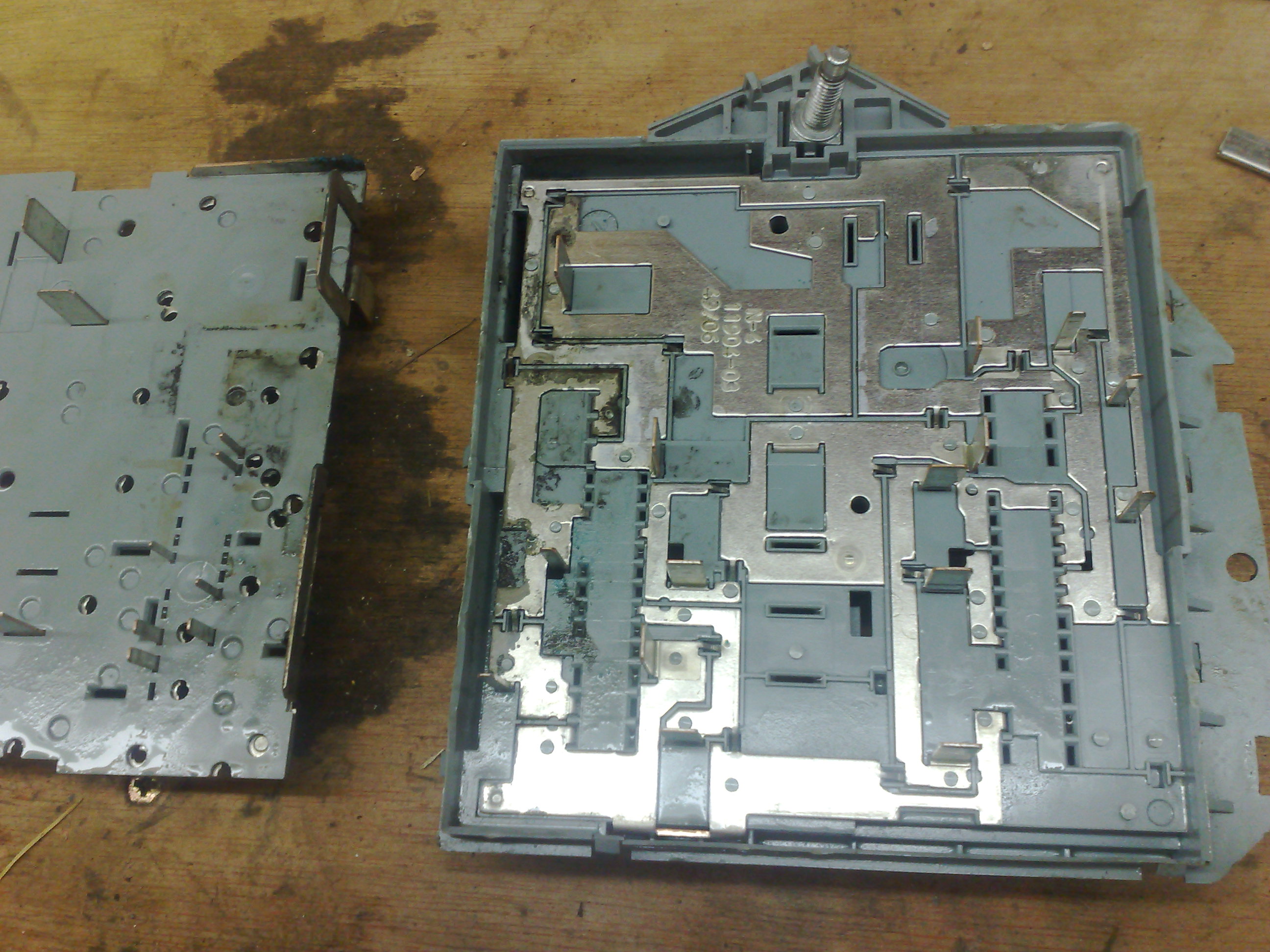

i thought i'd have a proper go at stripping the fusebox completely to see exactly how bad it was inside, as i was just about to order a new one anyway so had nothing to loose, turns out it is possible to strip it right down without doing any damage.
i took a few pics along the way and made a basic diagram to assist in putting it back together.
i found a fair bit of corrosion, gunk and moisture on the boards (poss water and wd40 from previous damp problems) so got a new long soft bristle wire brush and scrubbed all the metal contacts clean then washed everything out with an aerosol spray solvent, also washed all relays and fuses in a jug of the stuff then blow dried it all with an air line. cleaned all the wiring connectors that plug into the bottom of the fuse box and re assembled without any wd40 this time.
took about an hour to piece it all back together, then put it all back into the van and hey presto, it works!!
cost £12 in spray solvent and major hassle with van off road, but well chuffed it worked! may need to change the fuse box in the future i guess, or just keep cleaning it, have to see how finances lie.
p.s. while working on the van in the rain i was surprised to see how much water was getting into the engine bay and on top of the engine, water was coming through the black plastic panel below the windscreen, seems like the fuse box is in a very damp area.
