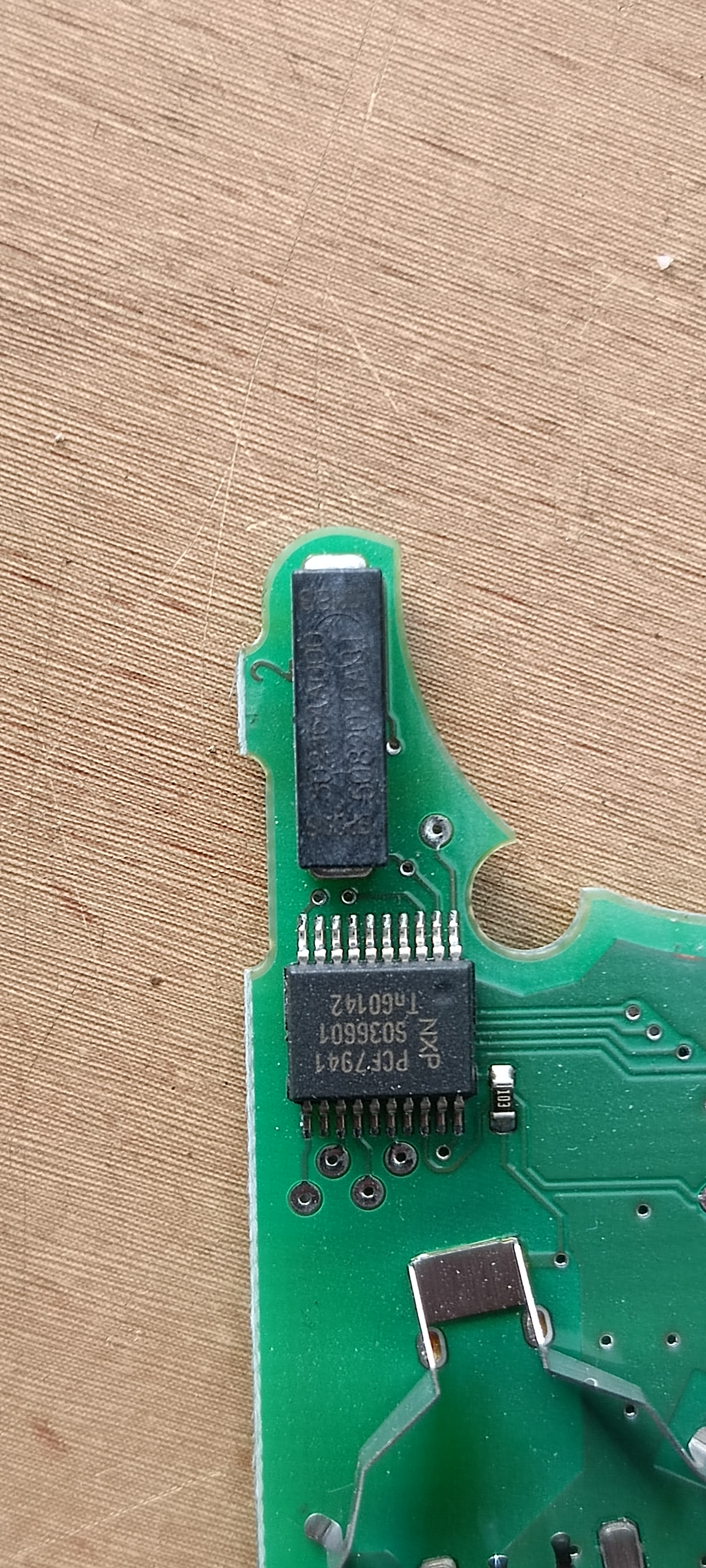

Bcm both codes and on the internet they mentioned that these errors are for a faulty bcm and if this dry joint you were talking about is the issue shouldn't the chip be not readable? Or this is not related? And what do you want me to do if it is indeed dry? Spray some Electronic contact cleaner or something else?
That's mine. Waiting for you to tell me what to put on it

Got a key will replace them but the question is now what's next? Or do you want me to spray some contact cleaner on it as it is out?
You don't normally get the D600 error
The scan tool isn't great but if the internet is correct D600 is the same as U1600 in the BCM is an incorrect read of the key

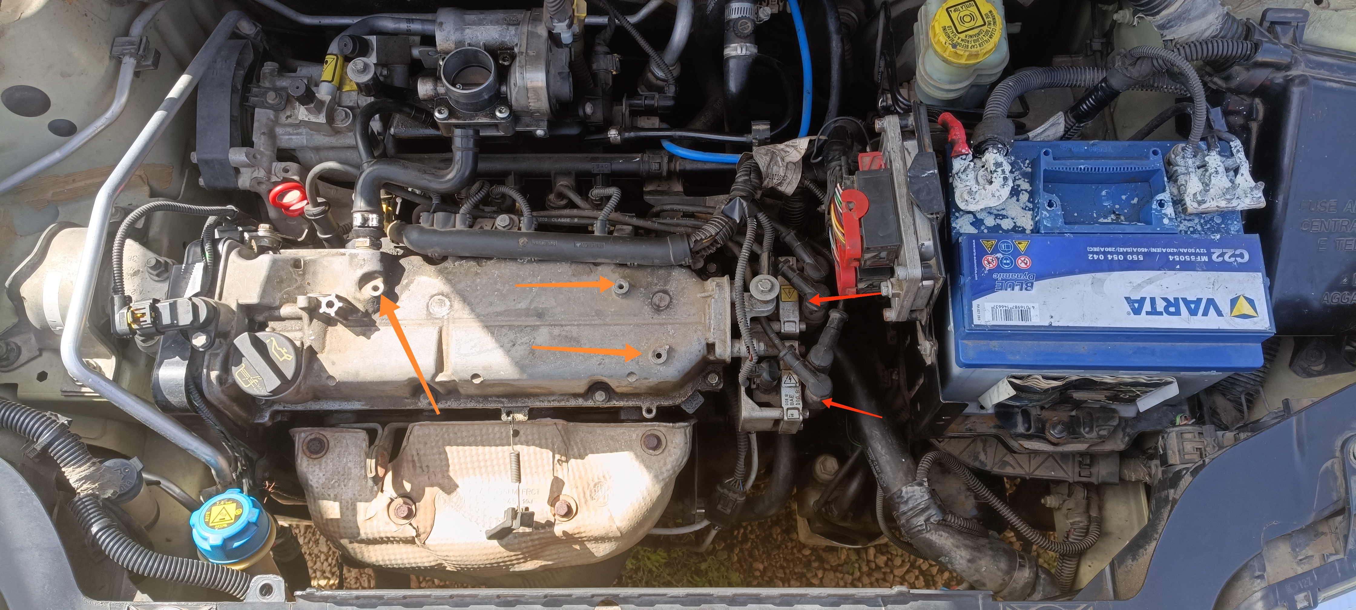

Strange I have a very similar car but the ECU is placed differently
Do yours have the one single coil pack red arrow
Here's the location of the two earth's on my car
Yellow arrows
Does the bottom right one look as if it's ever had one, is there a bolt in the hole
Mine is similar but my coil packs are 2 in the location of the yellow arrows on your picture
Now there is a possibility that the coils had a ground on them and were removed sometime with the previous owner
mmm like my 06 panda had its been awhile since I have worked on one with the two coil
I cant remember where the grounds are on that car let me see
Ok so this is my whole engine the orange are empty 10mm bolts that i think are what you are talking about but that are empty and the red arrows are my coil packs but the thing is the air intake and filter will be mounter right above these 10mm holes so i have no idea how the wiring will go to the valve cover whether it'll be from behind or above the battery but still all 3 terminals on the negative clamps are used otherwise it'll need to be either merged or to the chassis.
If you have a photo of similar engine than mine I'd like to know where i should add some wires
Now there is a void chassis bolt coming out almost behind the brake oil cap that is covered in paint, but I'm not sure if it serves to hold some termal insulation preventing heat from going to the inside of the car or had a ground wire to it
