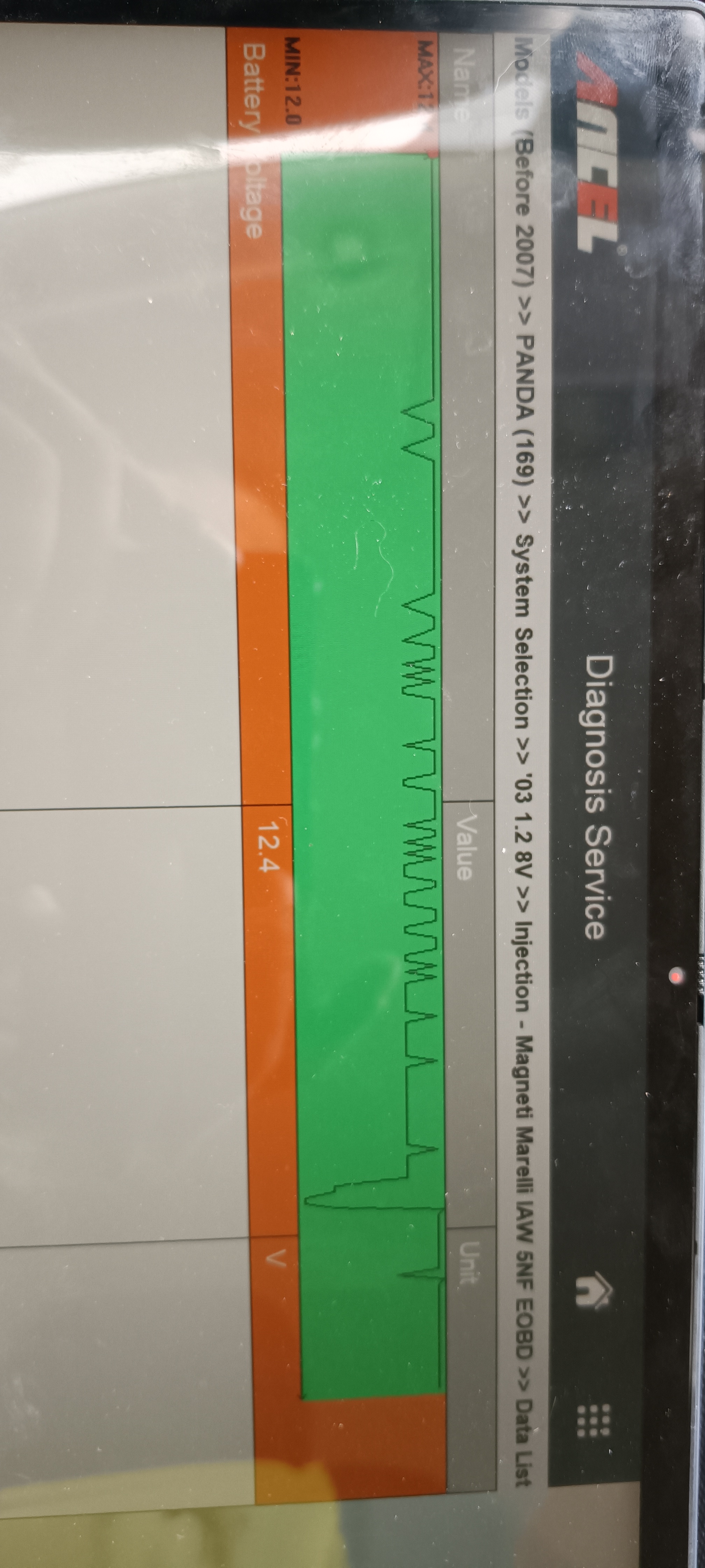

Ok so something weird is going on at first the noise was from the wires entering the bcm, i started wiggling them some gave and some didn't but then i went to the ECU before touching there was a hella lot of flickering but the flicker is of 0.1-0.2v started moving the wires entering the ECU the noise kept increasing until i removed the loom containing the red and white wire then after replugging the loom closing and opening ignition etc... i am getting N/A battery voltage what happened?
After restarting the software it worked again no idea why this happened
That good, at least we know 100% the scan tool is getting the voltage from the ECU, which it should

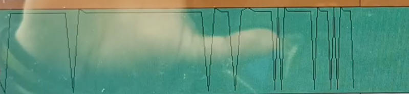

This car is driving me mad look at the spikes and they show before and after the selespeed pump activate keeps showing for a couple of seconds then become less and less until they go back away
Those spikes are normal fraction of a volt
These are 4 volts with nothing operating

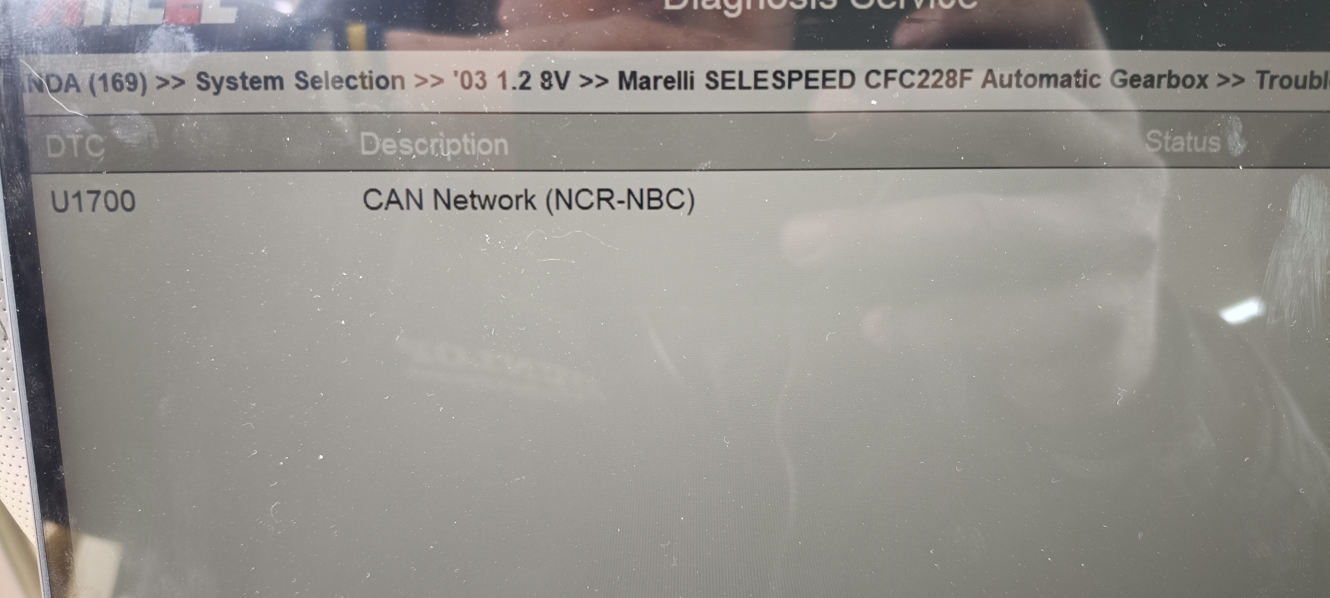

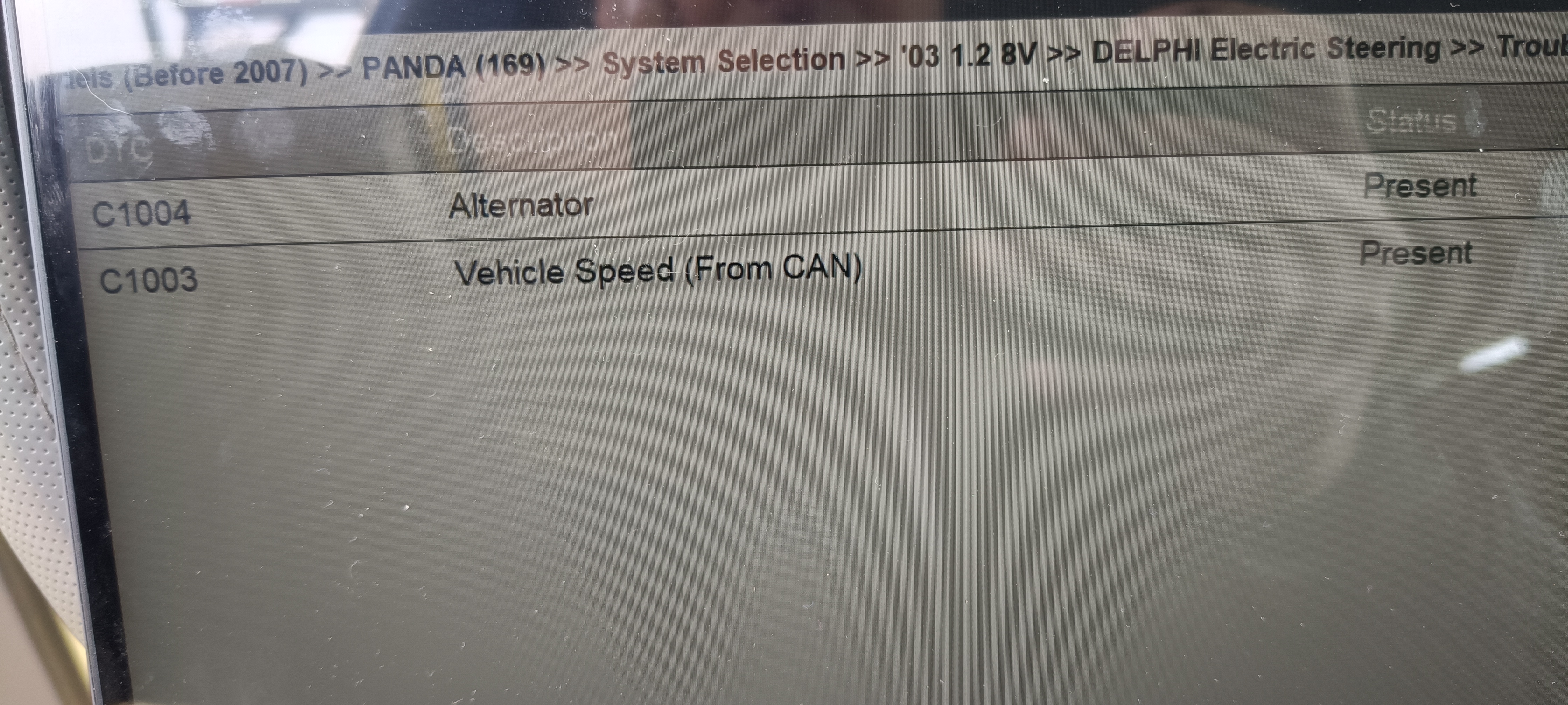

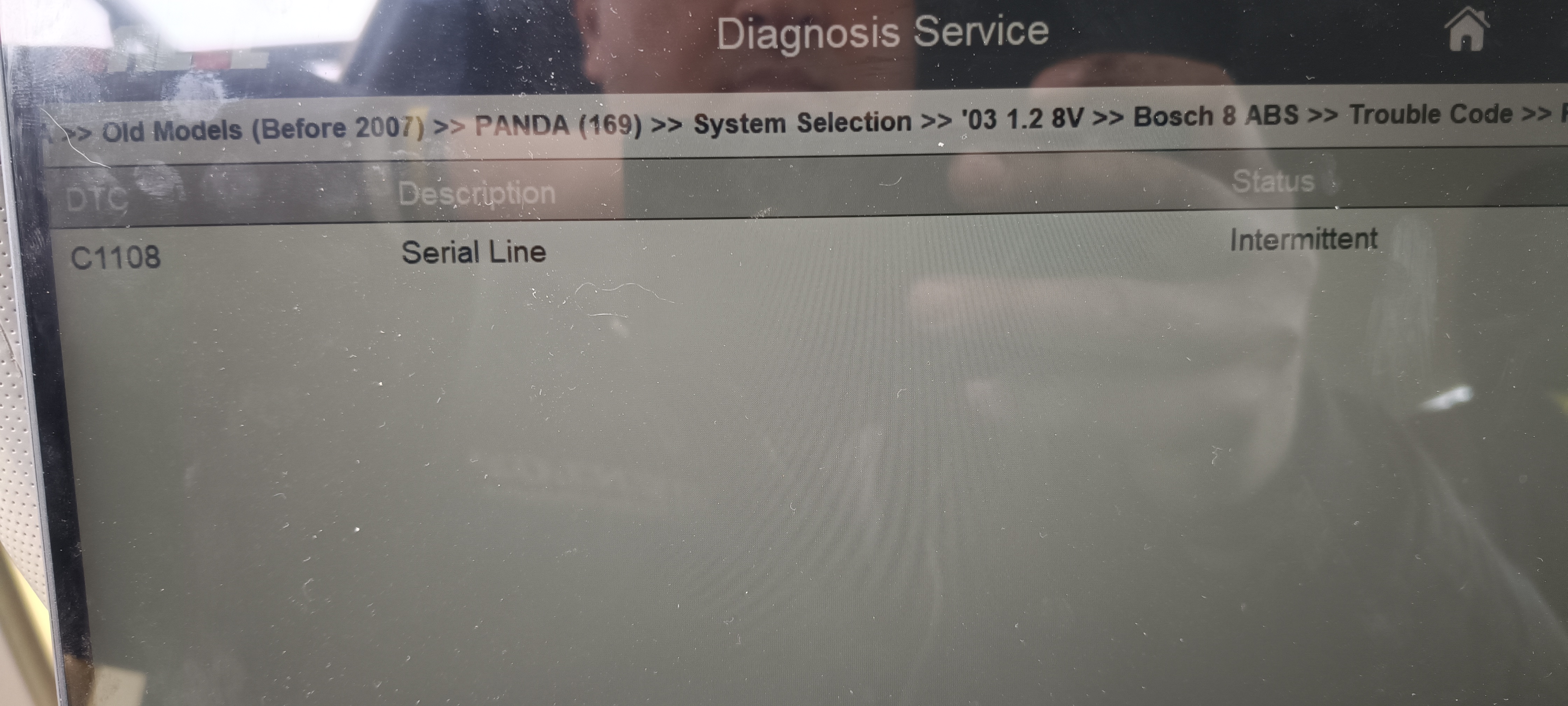

After i was done with all the wiggling i found these codes and surprisingly bcm and ecu were both clean
In this picture it was 0.1-0.2
You moved whatever was loose
I didn't move anything before hooking the diagnostic tool and got no large fluctuations after hooking it the second time do you think cranking might show this large fluctuations again?
Turns out the little flickers are from the battery and i tried cranking nothing is happening again all normal and stable now at 12.3-12.4v

Both the C100? Errors are for low battery
U1700 might not be genuine
Let me check it either U1700 or U1600 I forget which that should be ignored and the battery disconnected and connected let me see if I can find the service post
