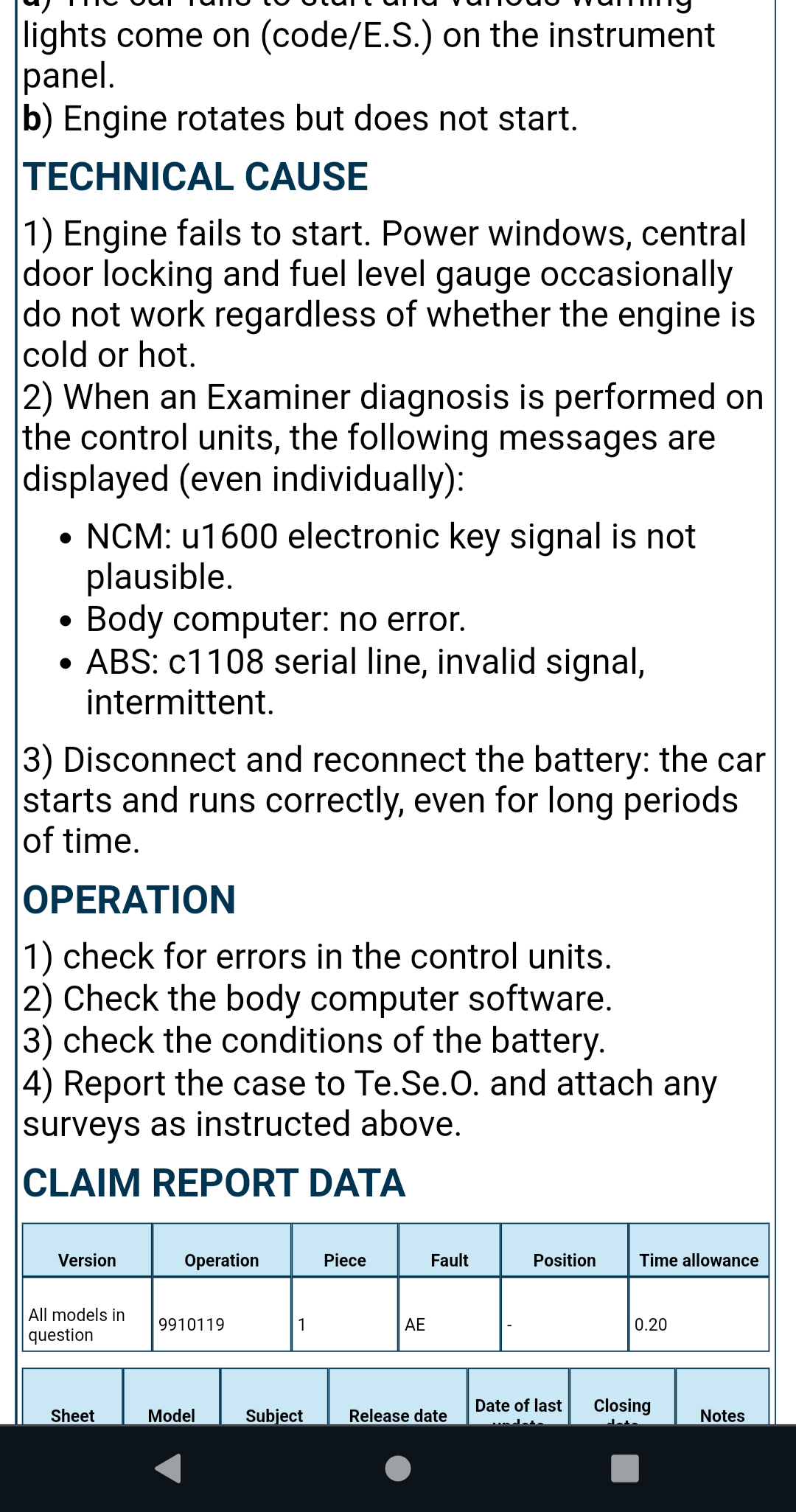

Sounds like a good ideaThe weird part is that they are new faults and after wiggling the cables they showed up i am thinking of putting someone on the scan tool to start looking through the systems while i wiggle the cables but the problem is that it started raining unless you have another suggestion

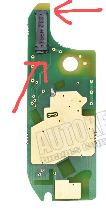

It has central lock unlock but staying the car and cranking is through the key, the key was checked with 2 key readers and returned as functional (tried reading the chip about 6 times on mine and have the transponder's code all 6 times) so the key is not faulty, checked the antenna ring, gave 30 ohms resistance i think it was. 32-34 to be exact but i don't quite remember and checked the antenna wiring for shorts and it was all good along with continuity so I'm gonna assume it's a dead immobilizerThat's great everything is working
No crank error
No canbus error
No alternator error
No battery error
9022 has always been there
D600 is the hexadecimal code for U1600 key not recognised
