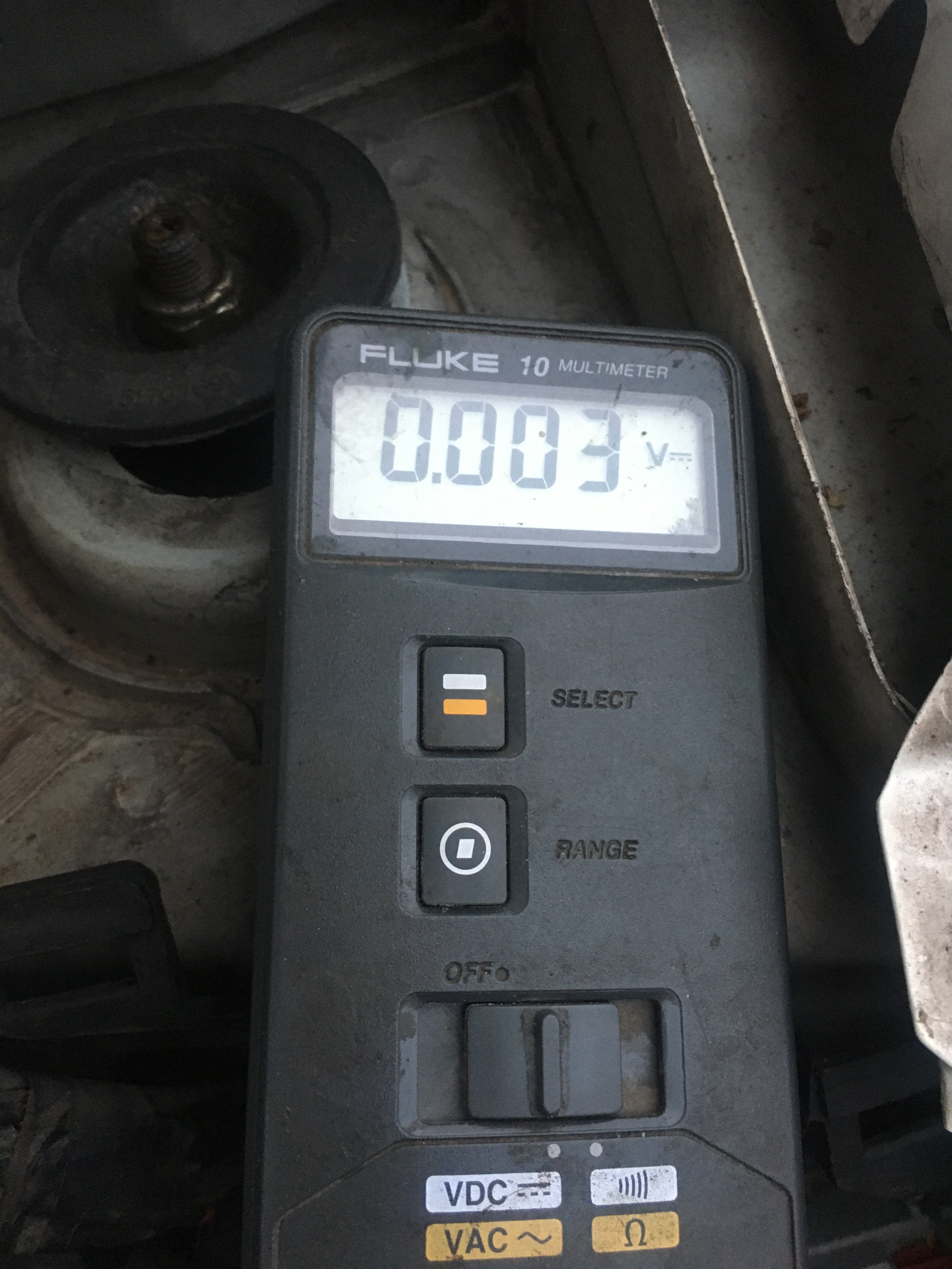

Is that under load or all the time
There's nothing without load up to 0.002v and hits up to 282mv when cranking on the terminal and bolt/nut

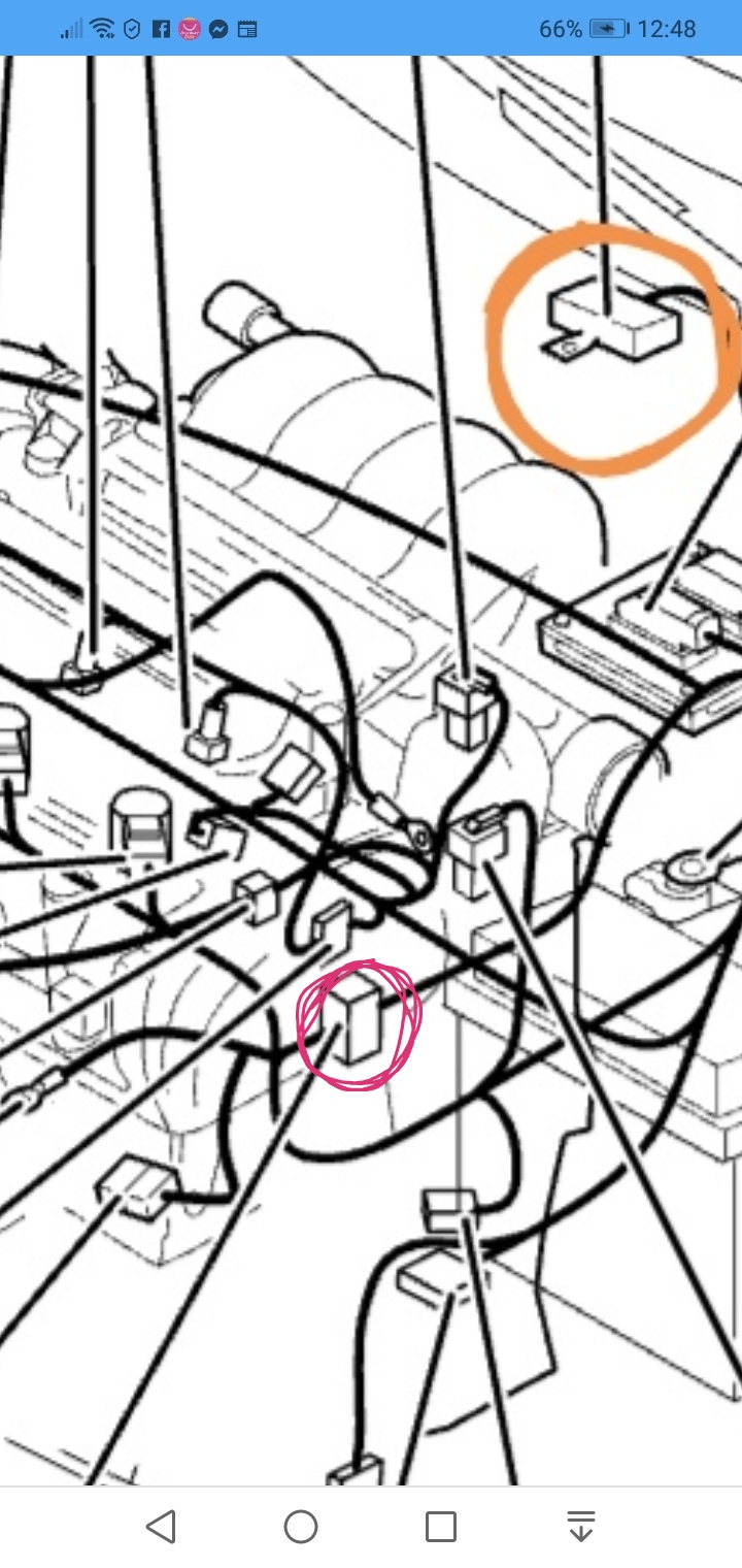

Next to the battery
There black connector block
Not this pin, but the one underneath
Should be

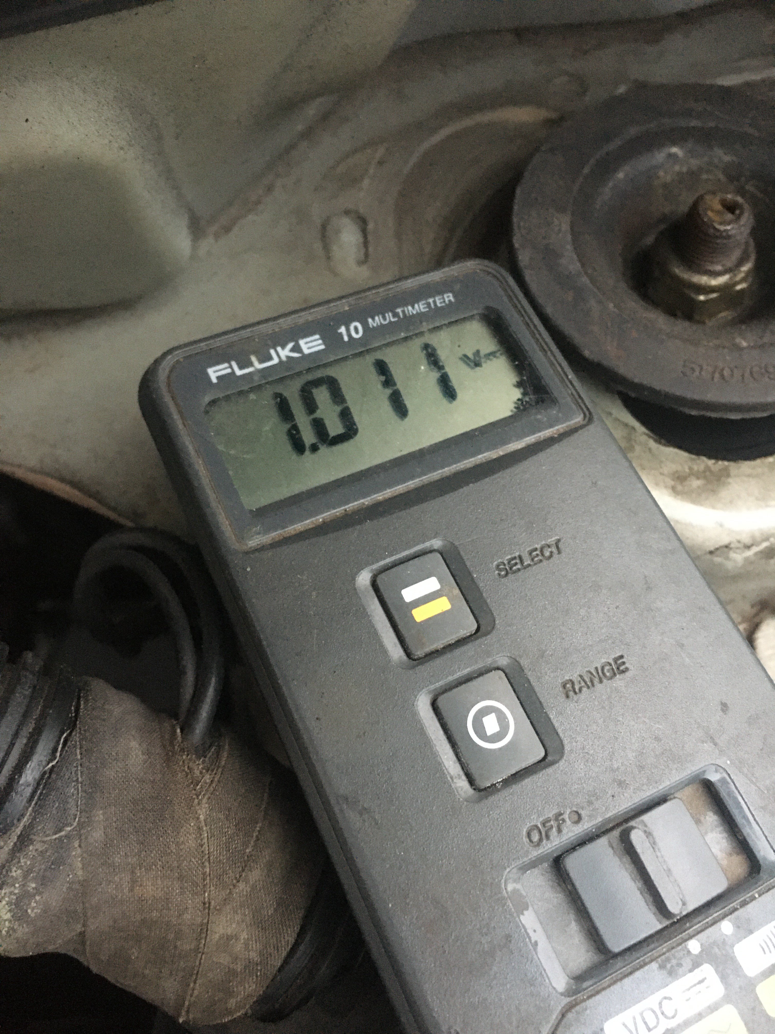

Close to zero
With the ignition off
And around a volt with the ignition on

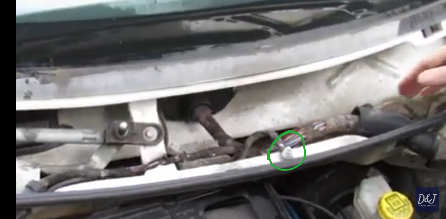

Can't find a similar one
The filter air intake like the one in the first picture passes here and to the left and even checked under the battery through my hand couldn't find one matching yours in the picture but it'll help if you tell me what is it used to power
The thin wires from both the
Starter and alternator go in to it
Should be under the ECU although I see some cables moved and tapped out of the way
Need to revisit the ECU ground it's the only measument so far that different to my car, mine is under 0.2V to the the circle while cranking
You mean in this plastic cover?

And the black connector you mentioned is not available i checked the whole area and based on where your map states there is only both oxygen sensors wiring passing by
