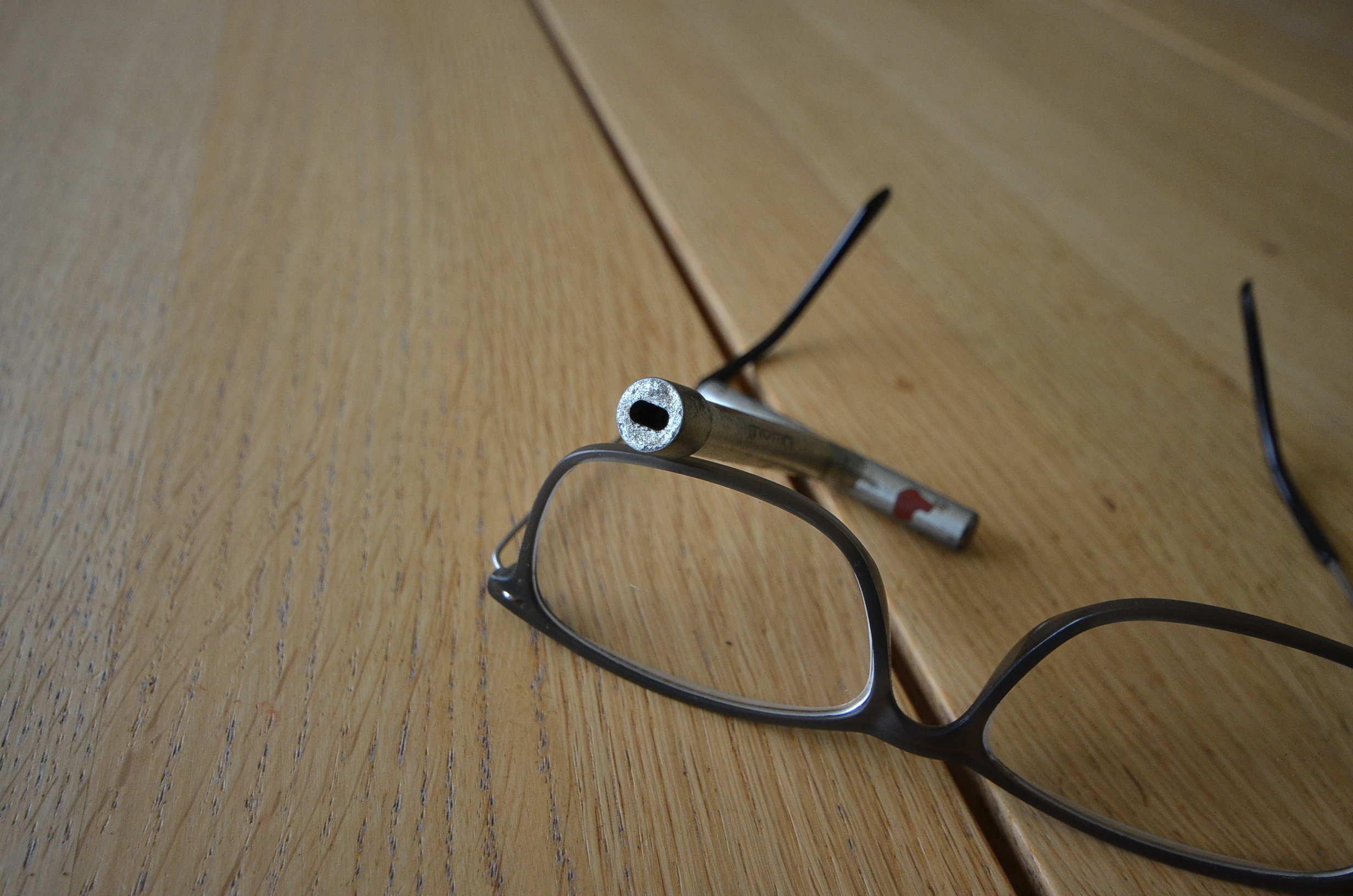

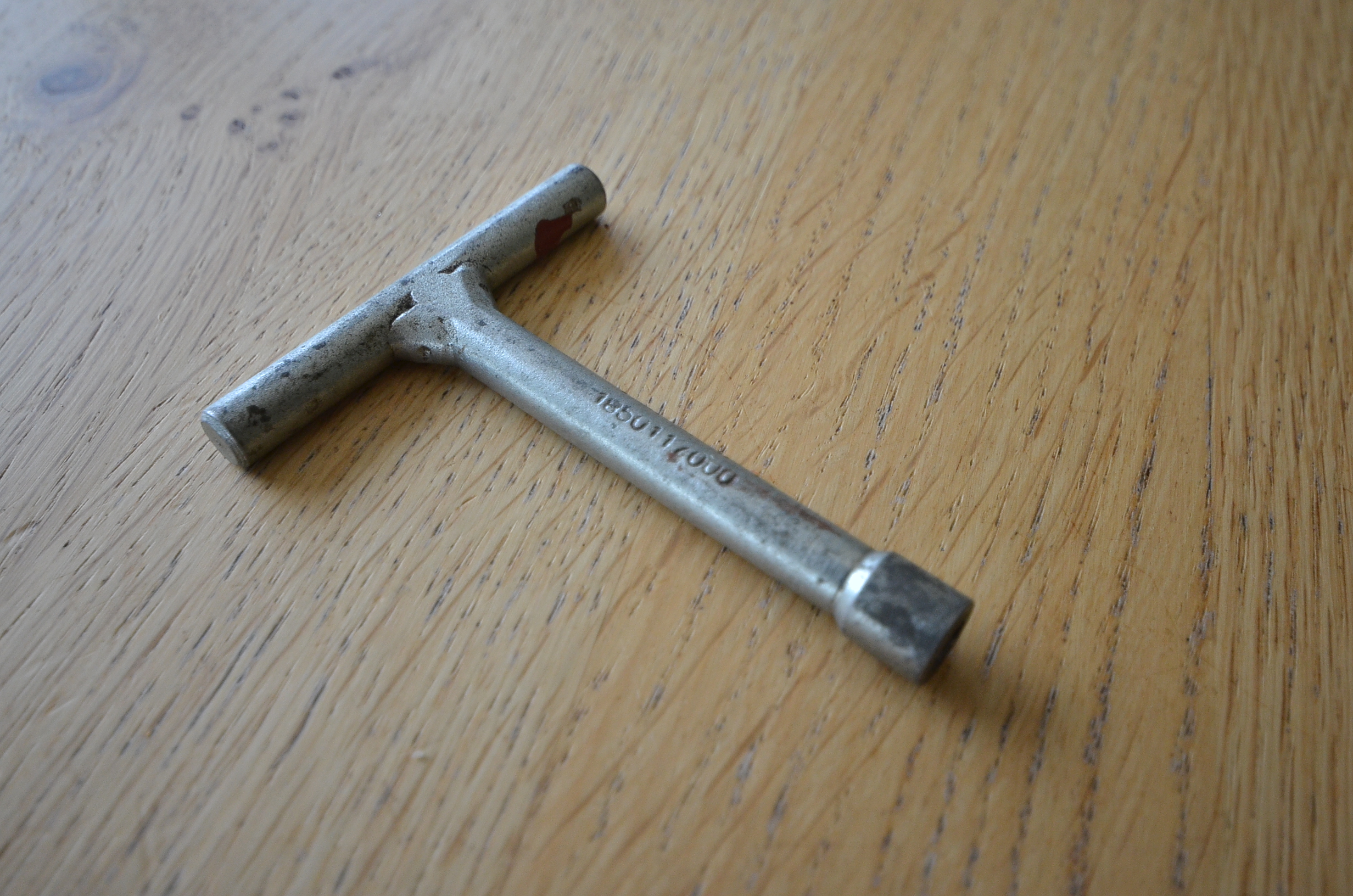

The Fiat tool number 185011/000 (taken from stamping on an actual item) is pictured. I think many people would have the skill/facility to make something like it. You could possibly adapt something in a 1/4 drive socket set or even from a piece of solid bar..
The slot is rounded at both ends and a 3mm twist-drill fits snugly.
The tool does make adjustments extremely easy and gives you precise control.
