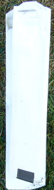

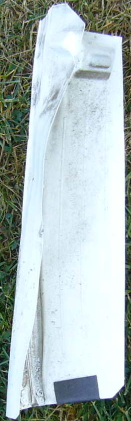

J jte Member Joined Sep 16, 2005 Messages 162 Points 131 Jul 14, 2021 #1 Hi, Does anybody know what this plastic piece is? It was inside front door at the rear. I cannot find it in Eper. Attachments P1040775.JPG 34.1 KB · Views: 55 P1040776.JPG 44.8 KB · Views: 44
J jimboy Patron member Joined Aug 2, 2006 Messages 3,891 Points 852 Location highlands Jul 14, 2021 #2 jte said: Hi, Does anybody know what this plastic piece is? It was inside front door at the rear. I cannot find it in Eper. Click to expand... Looks like moisture barriers.
OP OP J jte Member Joined Sep 16, 2005 Messages 162 Points 131 Jul 21, 2021 #3 Hi, I found it on Eper. It is: LOCK WATER PROTECTIONS SUPPRESSED (DAT 15/09/2001) 46527028 RH side and 46527029 LH side. I cannot find it on the Punto FS (2003-) models. Is it vital to have it in the door?
V varesecrazy Patron member Written 10+ guides Joined Apr 27, 2011 Messages 34,984 Points 7,836 Location Near the M4 Jul 21, 2021 #4 Thats what jimboy said.. Its a barrier to keep rainwater away from the 'doorcard'
