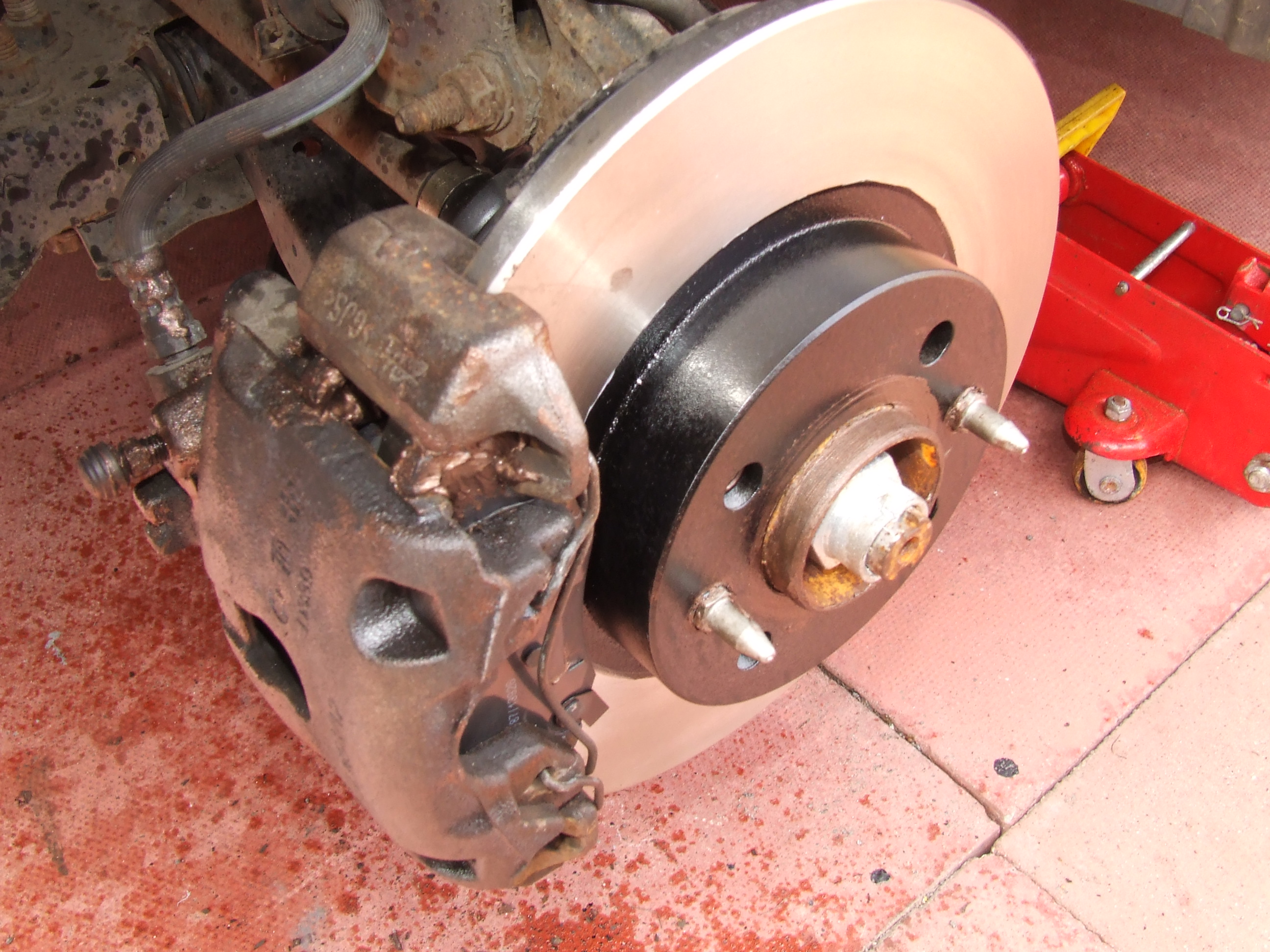

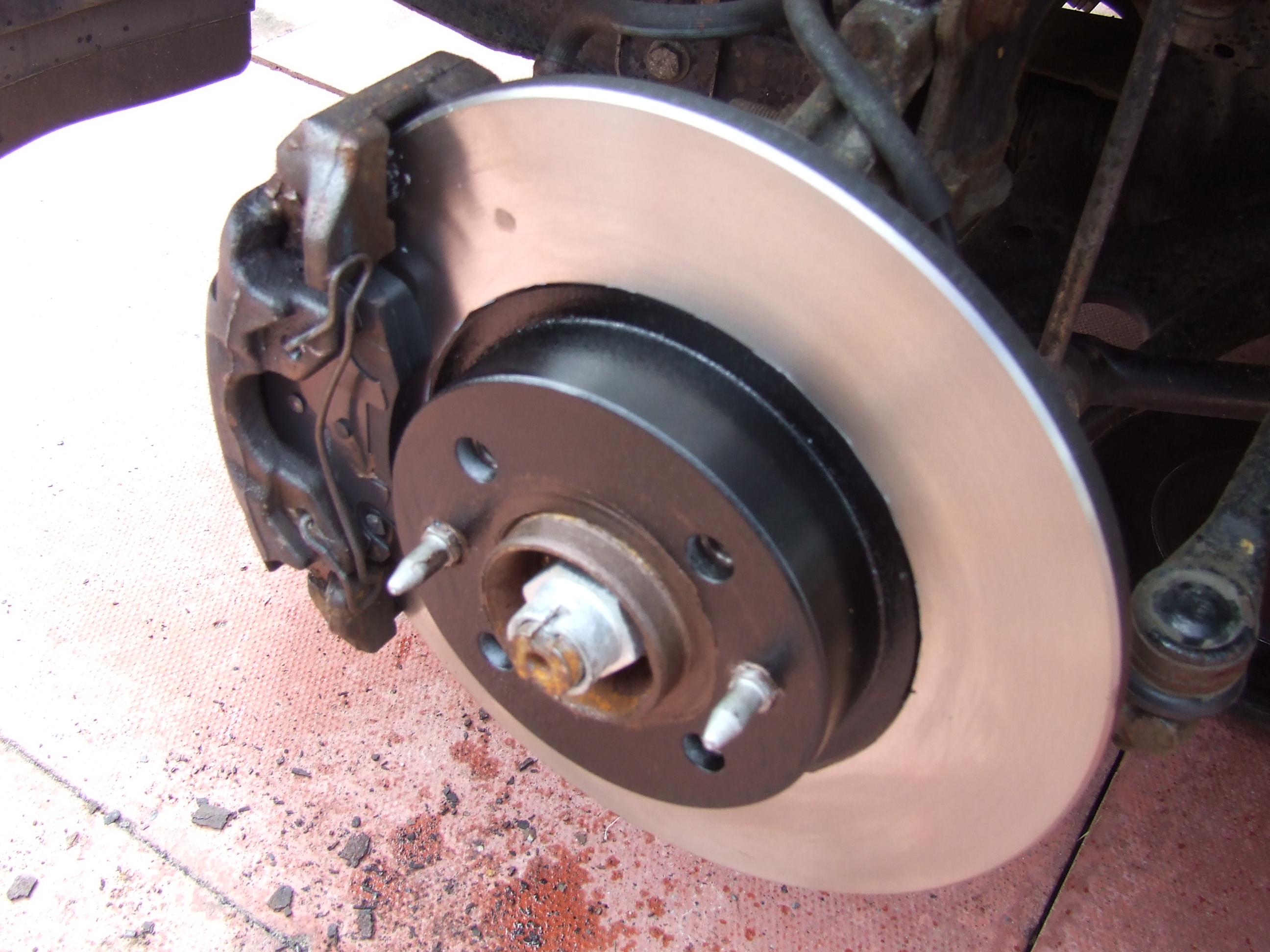

Well I did do the job, the lad with the radiogram was in a hurry and the missus has decided to wait till it's a wet day..... now that's common sense.
The job took about an hour start to finish.

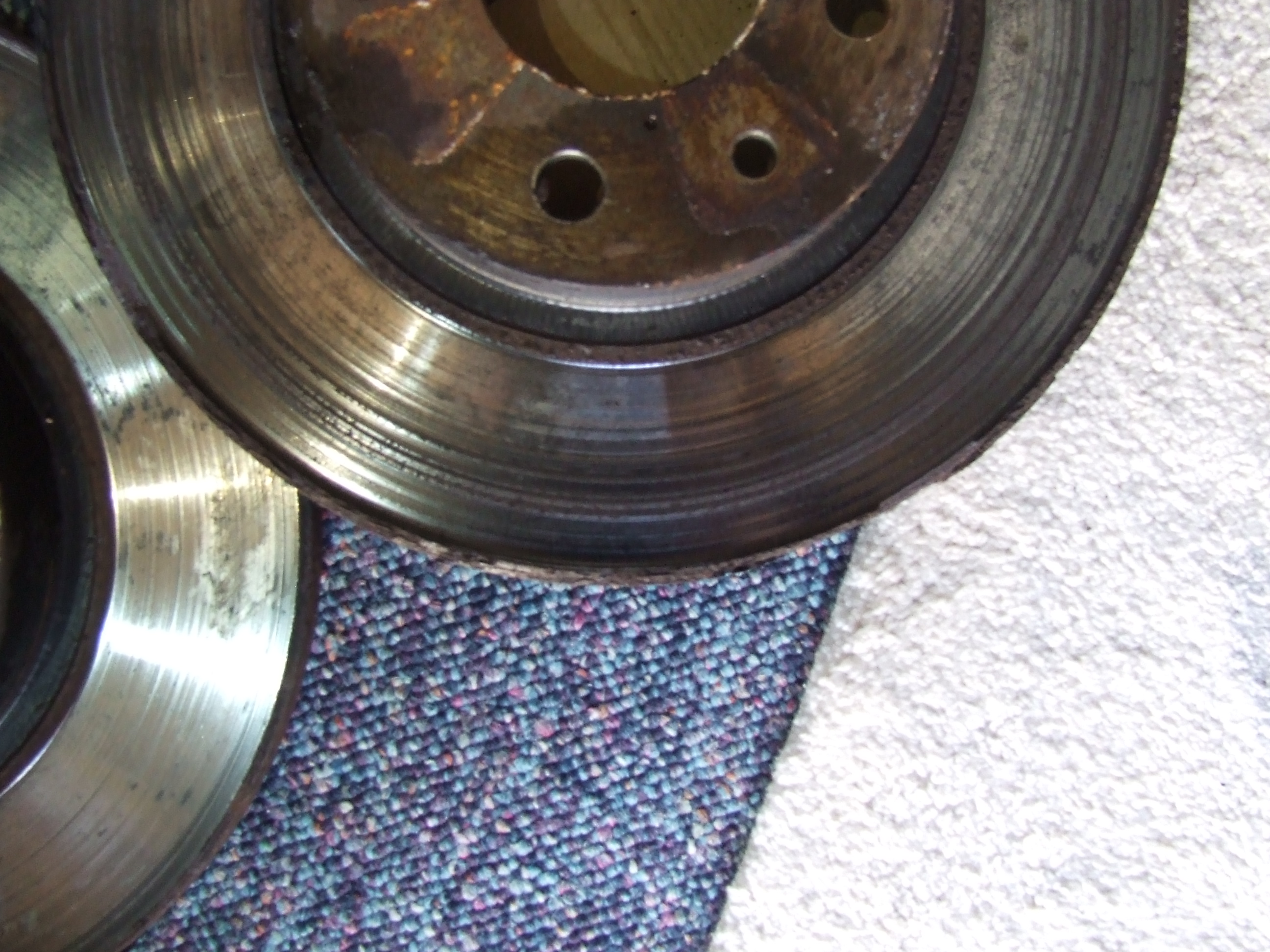

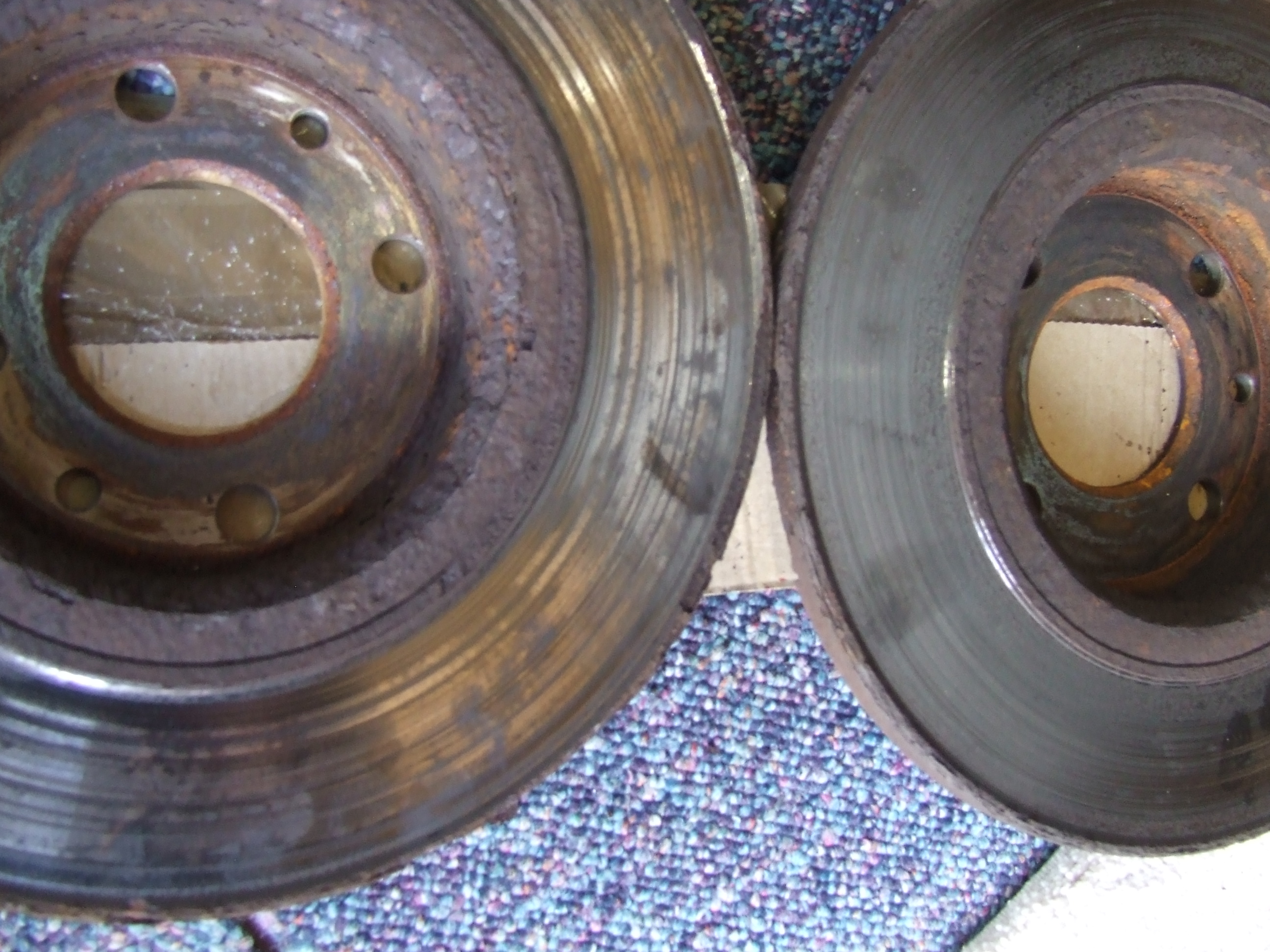

Here are some pictures, one disc is quite badly scored, not so noticeable in the pictures, the camera doesn't like close ups sadly.

Mine was low at 20,000 miles. The first owner lived in a coastal town so they may be more rusted than usual. Fortunately the rest of the car is mint, I will be rustproofing during the summer though.
The solid discs should be replaced when worn to 10mm, if badly scored beforehand.
