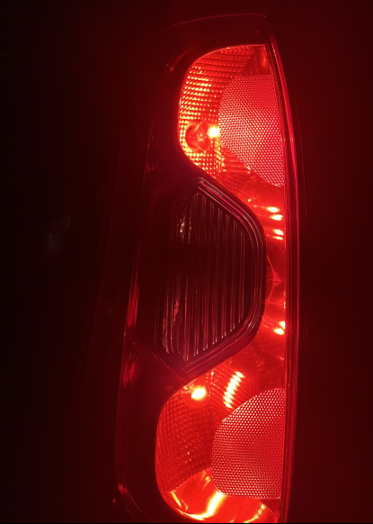

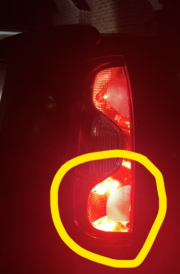

So, on my 2013 TA 4x4 there are four rear light bulbs - all have twin filament 5/21W offset bayonet bulbs. However, only the lower bulbs work as brake lights. Are you checking the top bulbs and finding the brake light filament intact (but this one is not used)? Or is my car just weird?

And just nighttime (headlights)
Obviously I'm not including the 3rd brake light.
Here's some photos to try and illustrate brakes applied;
Oddly, all the Pandas are like that - twin filament bulbs top and bottom but only the lower one used for the brake lights.
I speculated in an earlier thread here that this is because the bulb holder that's inside the red covers is identical on both sides, just flipped round 180 degrees... but have never actually tried to see if this is correct
I speculated in an early thread here that this is because the bulb holder that's inside the red covers is identical on both sides, just flipped over 180 degrees... but have never actually tried to see if this is correct
Thanks @Herts Hillhopper that's reassuring. On the DRL thread that you've been contributing to too, I was suspecting the same was the case for those bulbs (twin filament but only one used). However! I kept my powder dry this time and it is indeed CanBus trickery (as you say) that must switch to the dim DRL with headlights on - I managed not to embarrass myself this time!
