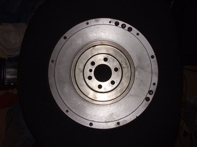

had the flywheel taken down to 4.7kg
yes.. i know i should've done that before fitting the engine.. but it wasnt ready in time :(

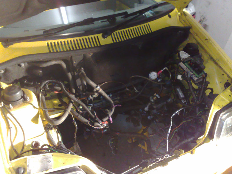

Wiring and fuel wise my car was setup to run an 8v MPI engine, using wasted spark. The Stilo engine used Coil On Plug, which my ECU can drive if i modified it - but it offers no real world advantage. I fitted a coil pack bracket and matching coils from a MK1 Punto Sporting 1242 16v;
I also fitted the Punto's inlet manifold and throttle body, as the stilo setup was fly by wire and too big to fit in the engine bay.
On the (mk1) 8v engines, the IAT and MAP sensors are seperate units. On the 16v, they are not - so a spot of re-wiring was needed;

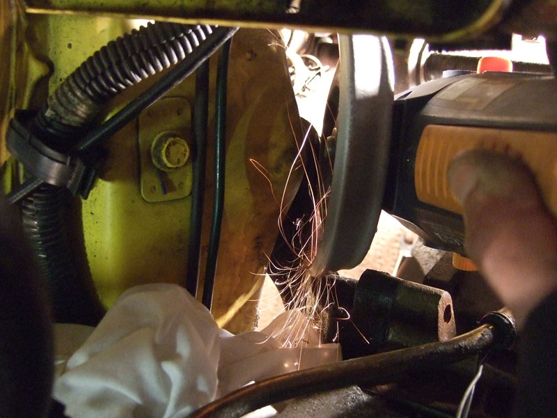

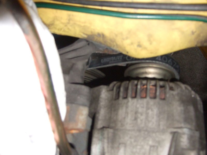

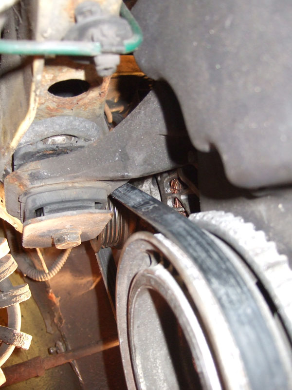

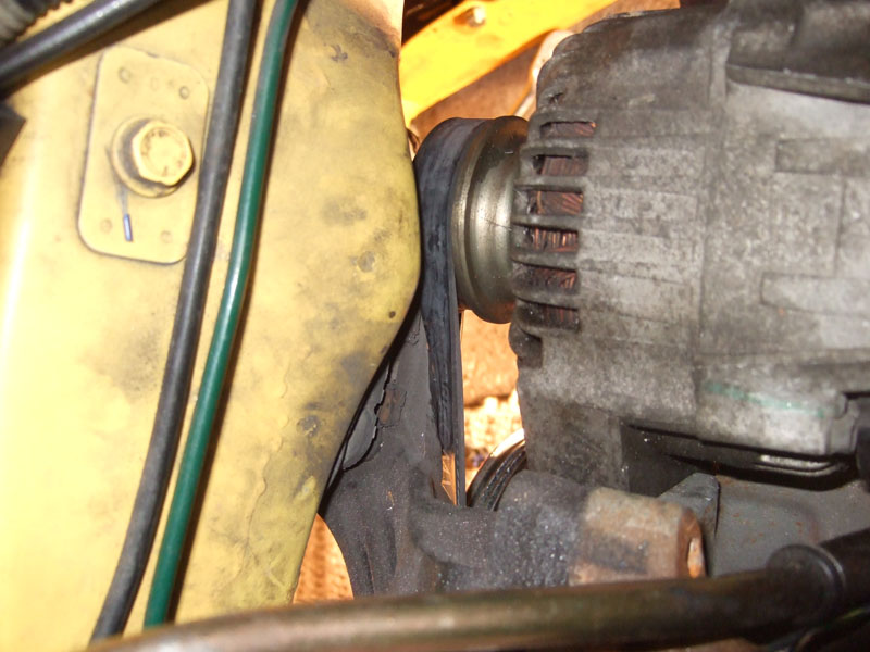

one of the problems was that the TDC sensor is in a different location. On the cento, from the crank it goes;
"cam belt | aux belt | TDC trigger ring" This is because its a bit tight with the engine mount. On the 16v's it goes "cam belt| TDC Trigger ring | aux belt". This means if you use the cento alternator and pulley, the TDC sensor is looking at the aux belt, not the teeth. But if you use the 16v alterantor and pulley then the belt fouls the engine mount.
Options are, grind away some of the mount or move the TDC sensor.
Now i know how finicky TDC sensors are and the nightmere it can cause if they're not bob on.. so i chose to leave it alone and attack the mount. Shame the mount was stuck in the car...
sorted!

great read, just wondering was there a reason why you had lighten the flywheel? and what gearbox you using?
Ricky
cheers mate. i lightened the flywheel because my old engine had one, and i liked how quickly it would rev up. it felt much more responsive.

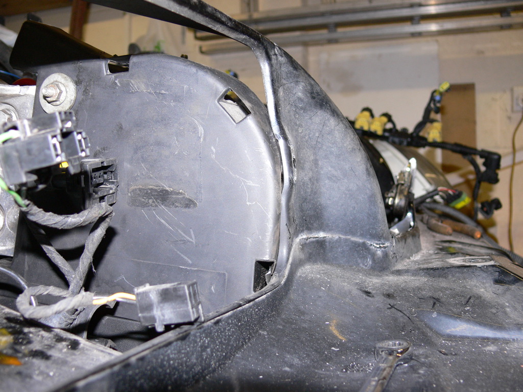

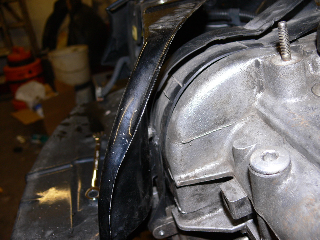

there is nothing better than pictures when someone is explaining or modifying, anyway it seems quite tight at the front, are you going to modify the front panel?
no, but i am going to cut down the headlight mounting bolt though as it is quite close.. and sits right in the middle of the cam belt - i've had nightmares of it hitting it and shredding the belt.
as you can see from the pics.. its a bit dubious that one!!

no, but if i move it back then the inlet won't clear the firewall at the back!
i'll just attack the bolt with a flapper disc and it wont pose a threat anymore!

I just removed the headlight and cut the bolt, nice and easy :)
TO be honest, its pretty stable if you chop the bolt entirely. The clips and the top bolt hold it well :)

Got any close ups of how much of the mount you had to chop?

i will take some photos of the mount on wednesday. am not wiring the MAP, just the IAT part of it. The thermistor is visible, and its legs are exposed so i checked for continueaty between them and the pins on the connector. Got two which showed the correct results, whacked the meter in reistance mode and then put my finger on the thermistor - the resistance changed.
