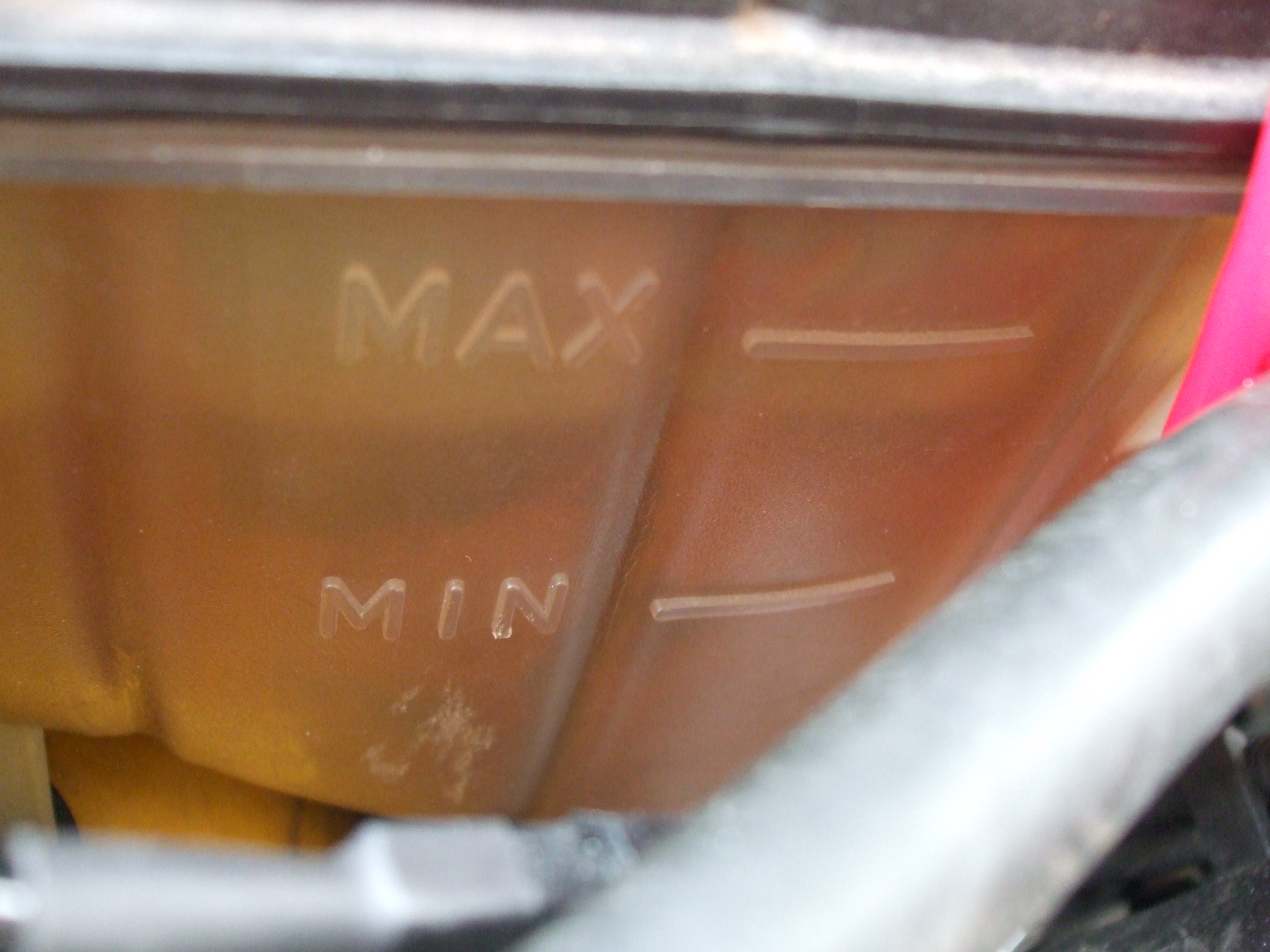

Refill the system with coolant/water mixture,i done 50-50 but you can do
other variations to suit yourself.

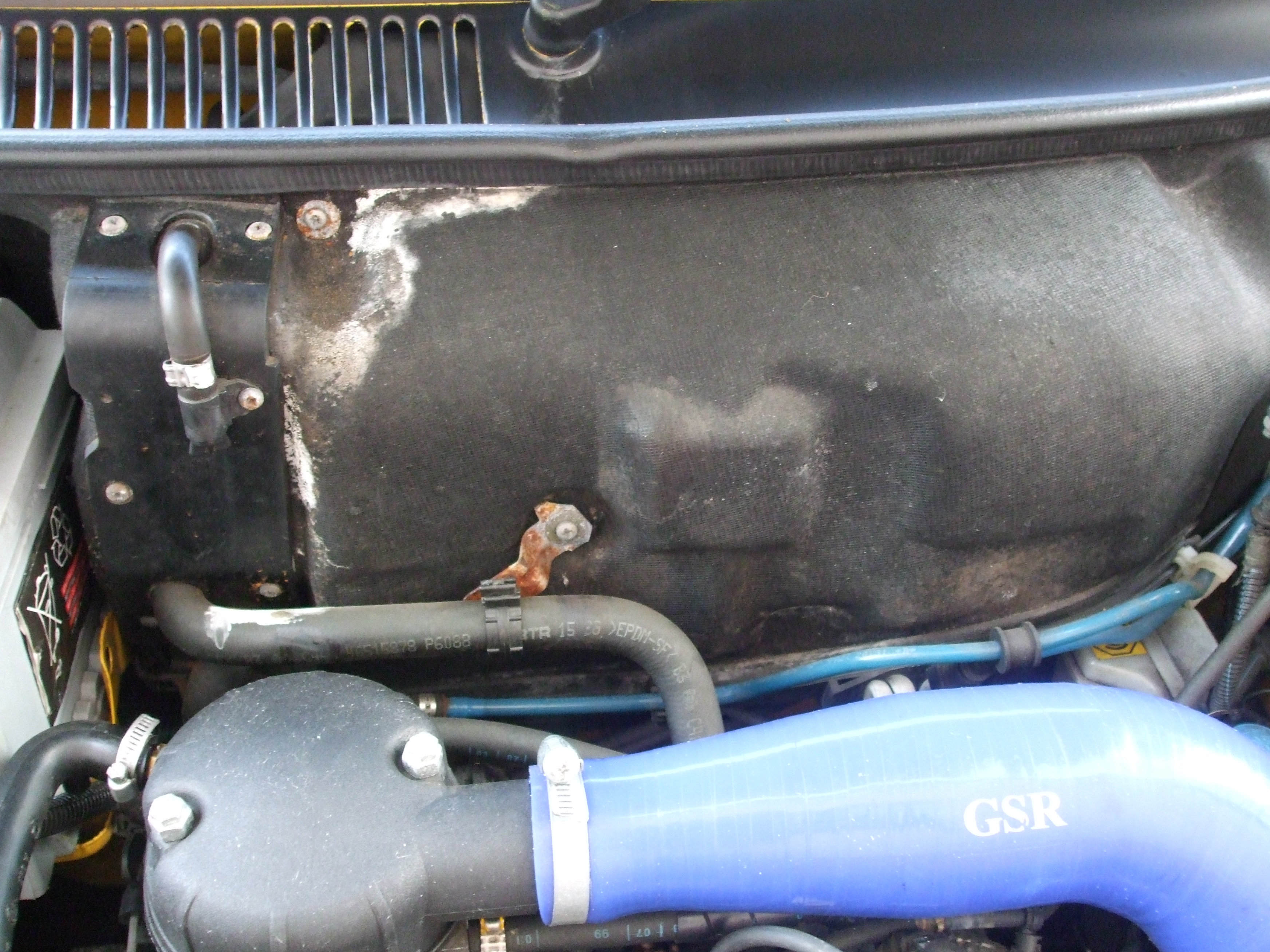

Once topped up and expantion cap is put back on,turn the heater to hot

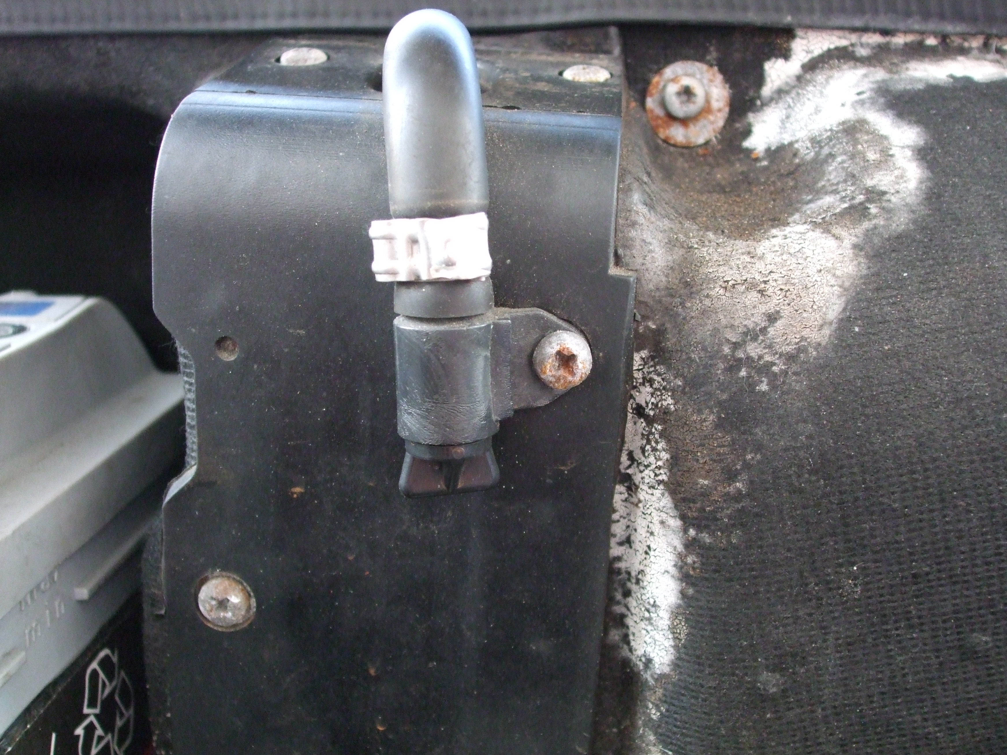

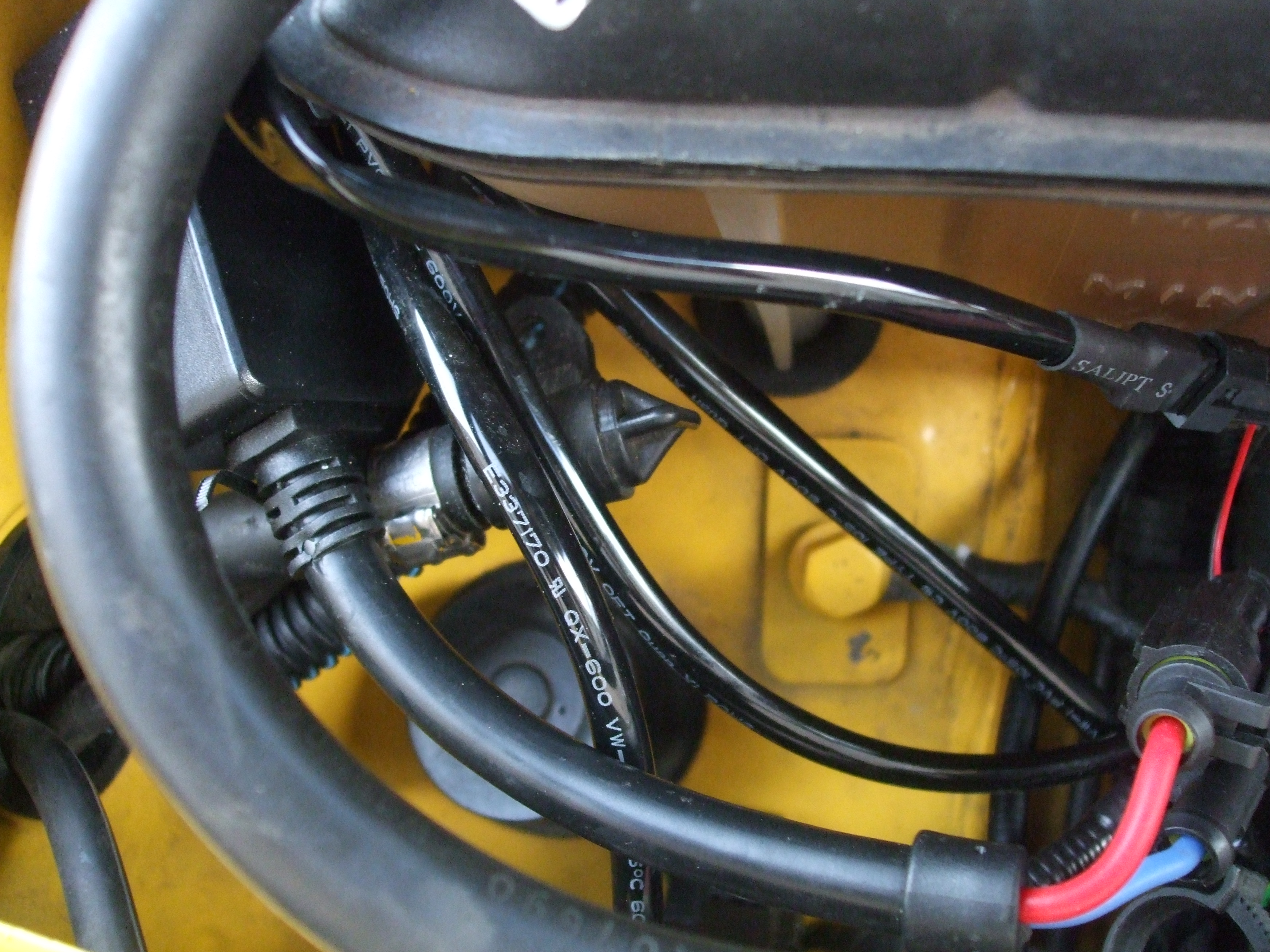

and i put mine on full then locate the bleed screws 2 on the 1108cc engine,
one on the bulkhead and one behind the drivers light.
I've had more success bleeding with the engine running
but thats just my take on it,with engine running open the bulkhead screw
and let the air and bubbles out till you get a steady flow of coolant then
move onto the one behind the drivers headlight and do the same.
