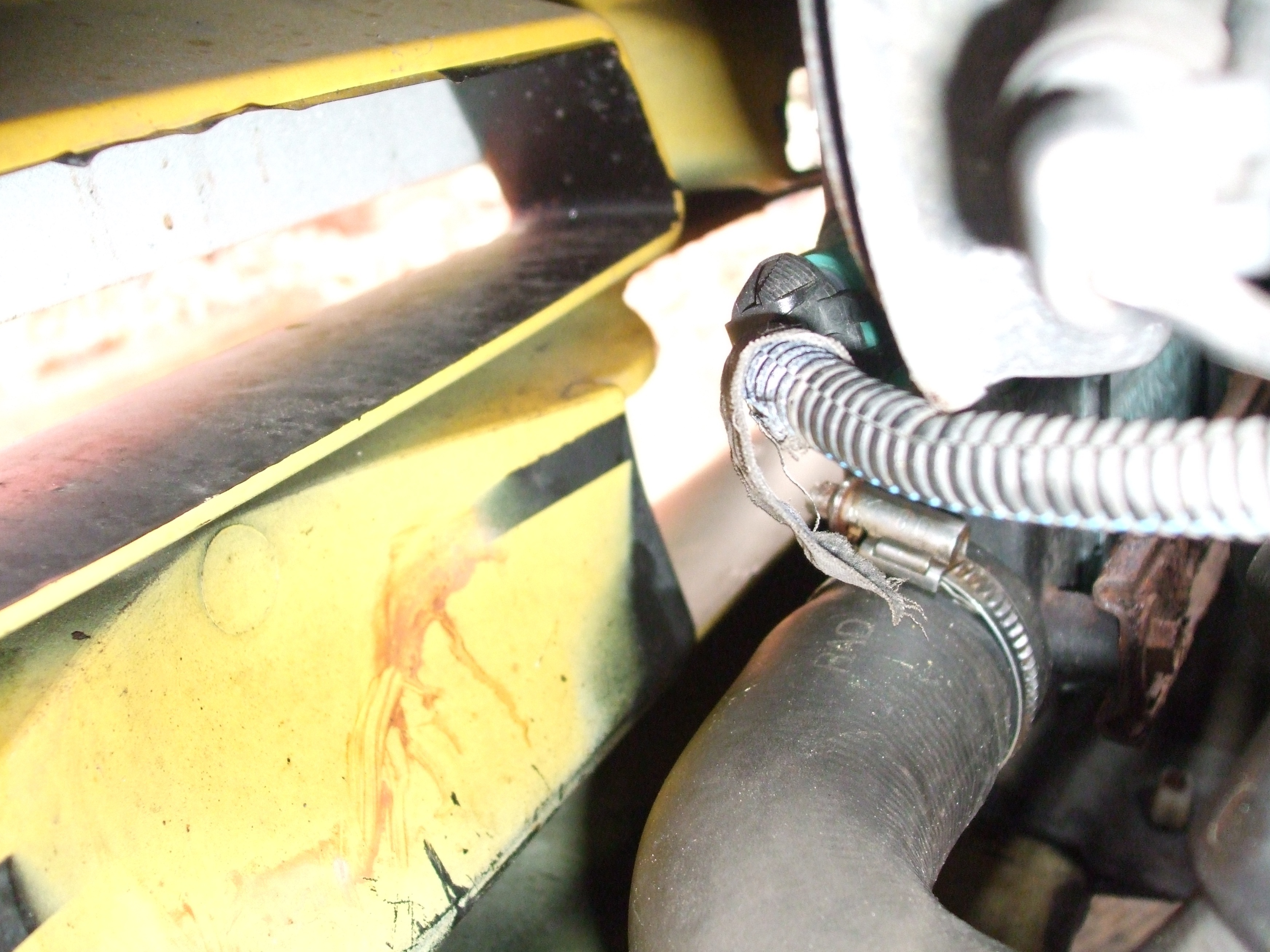

Locate the lower radiator hose on the right hand side, it's a bit fiddly to get at,
Snap off the factory jubilee and replace it with a screwdriver one.
