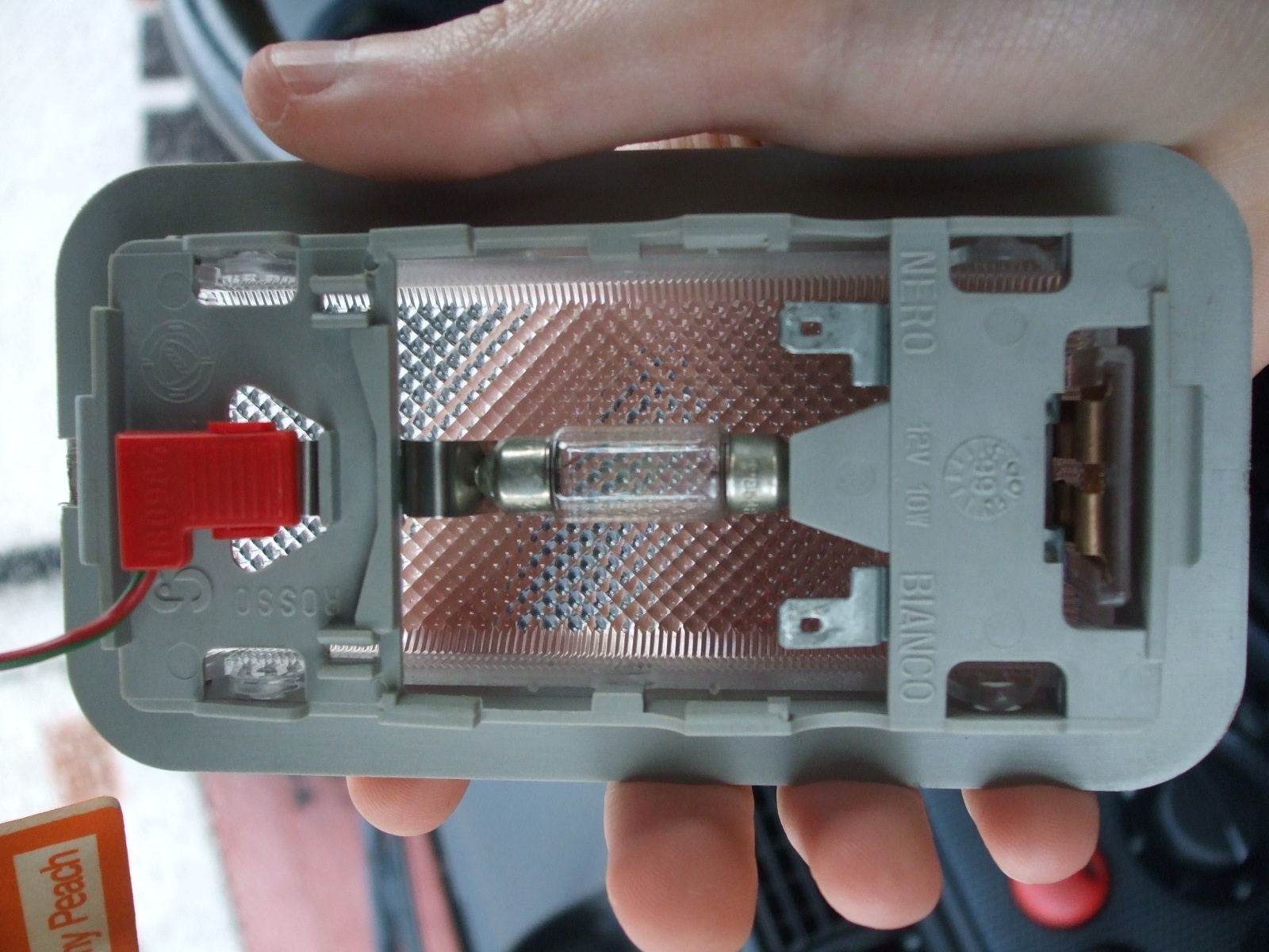

Step 1 :
Locate interior light and on either side there is a small slot.
Insert a flat head screwdriver and prise the light down from the ceiling enough
to get hold of with your fingers,then once you have hold of it
sit screwdriver out the way and with both hands give a fair strength downwards pull and the whole light will pop out with the wires still attached.
Step 2:
Remove the white and black connectors from their spades and you will be left
with a covering plate over the bulb,push one side and it should lift out to reveal
the bulb!
