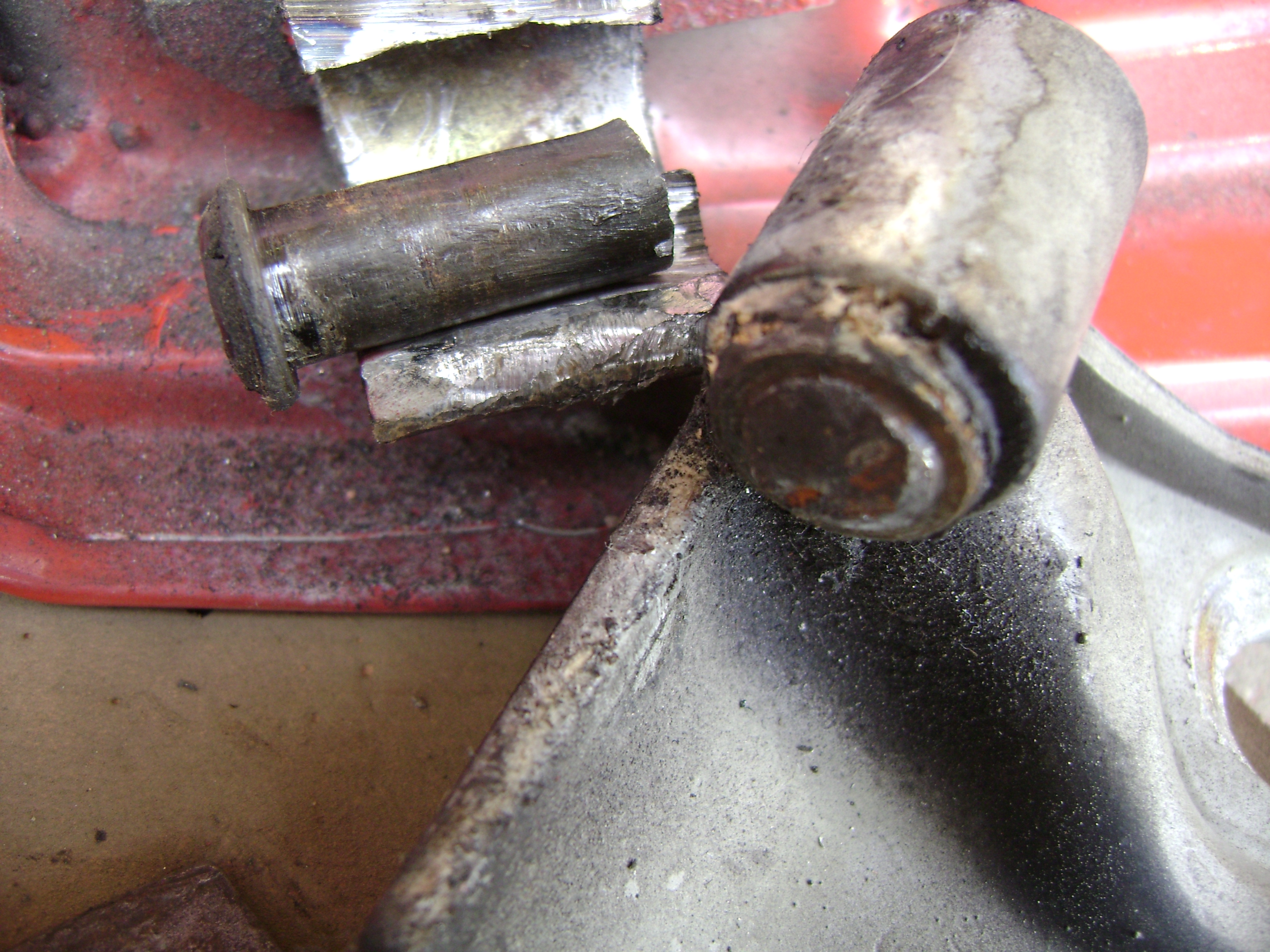

the hinge pin that broke was the top one so it had broke on the door

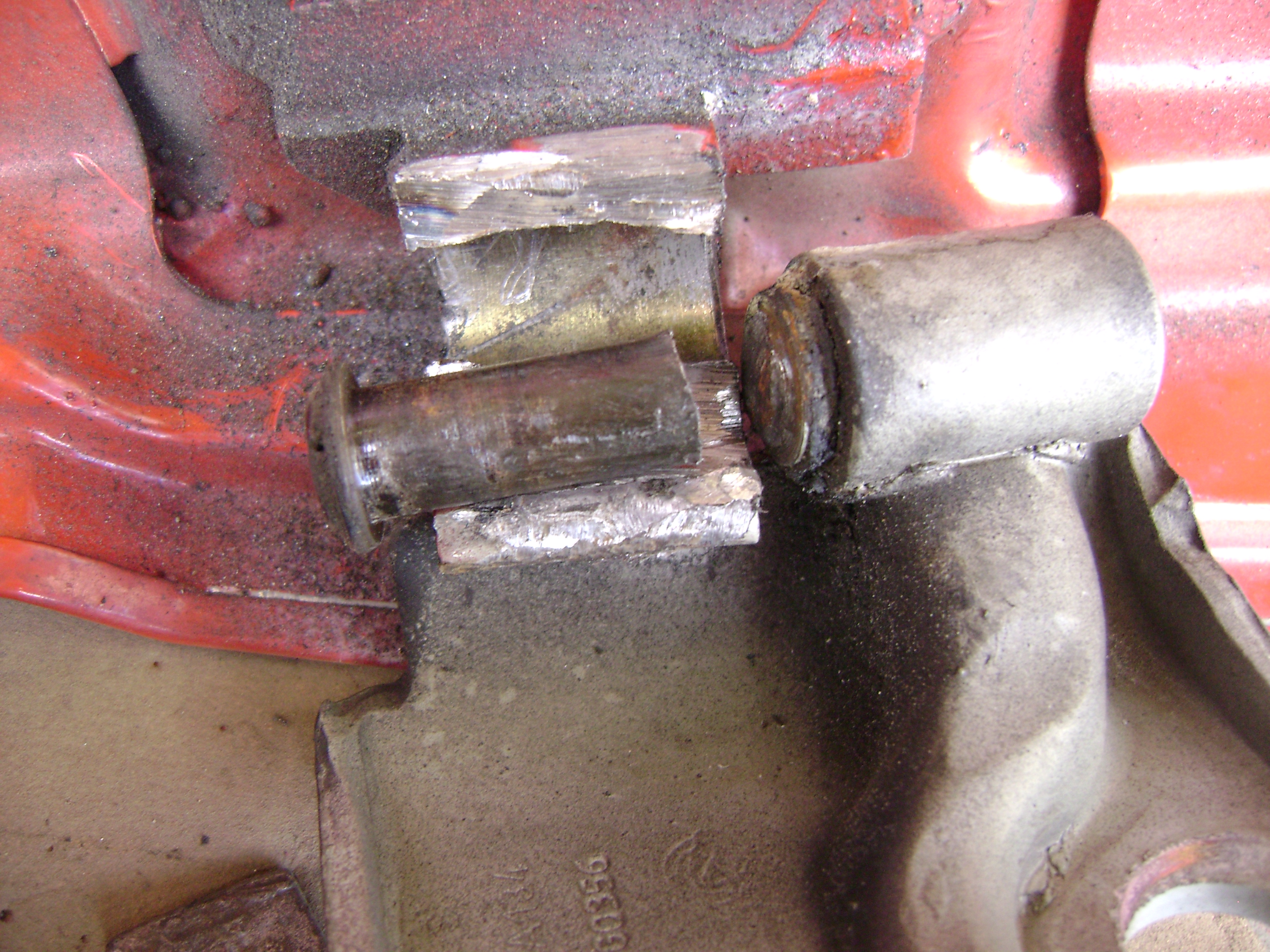

on looking it is fitted into the door (the pin) and then affixed at the factory like a rivet ie the top of the pin is bashed over thus stopping this pin coming out

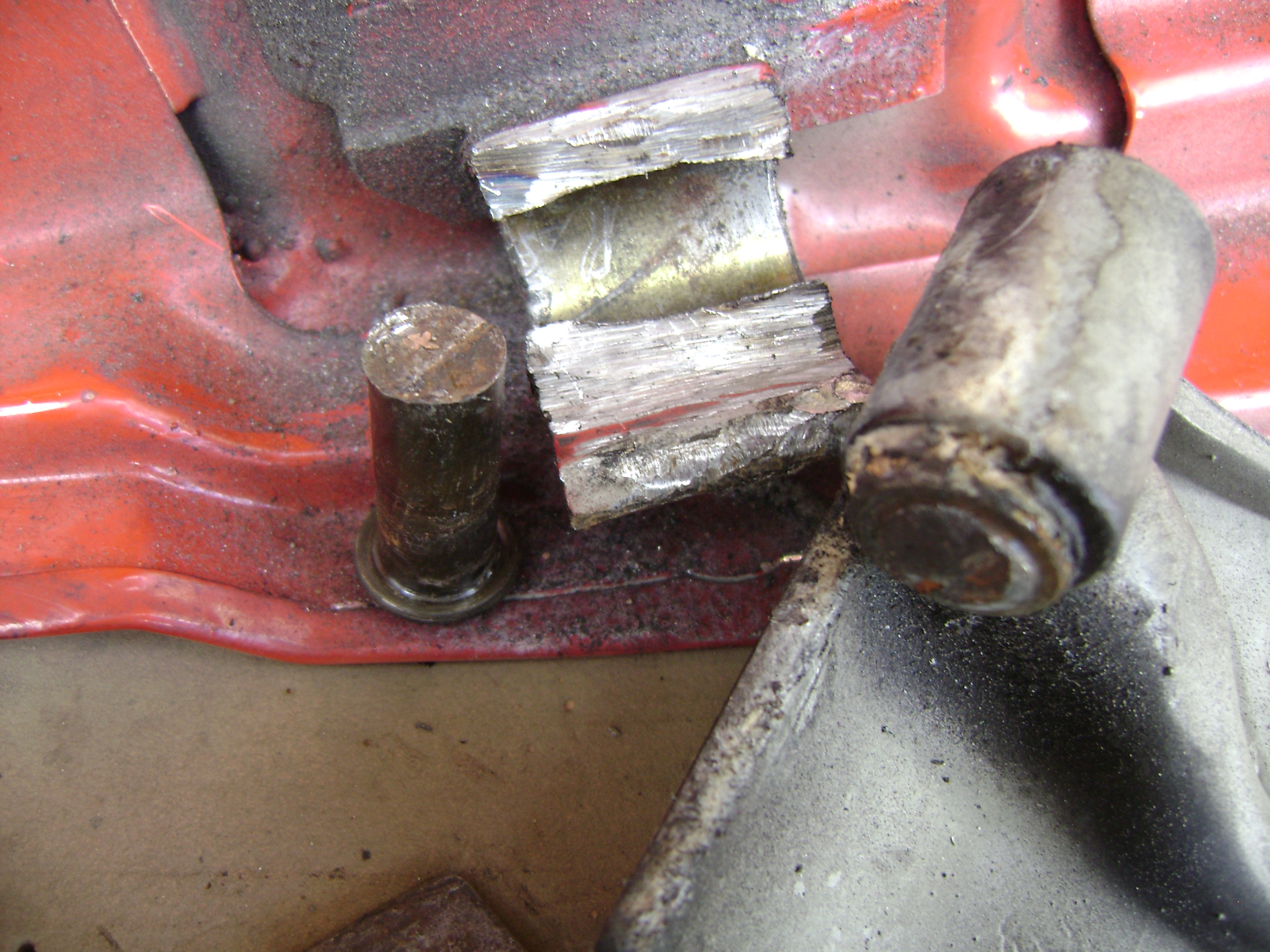

i went and got a scrap door and grinded the hinge so as i could get to the pin then wacked the hinge so the pin would come out

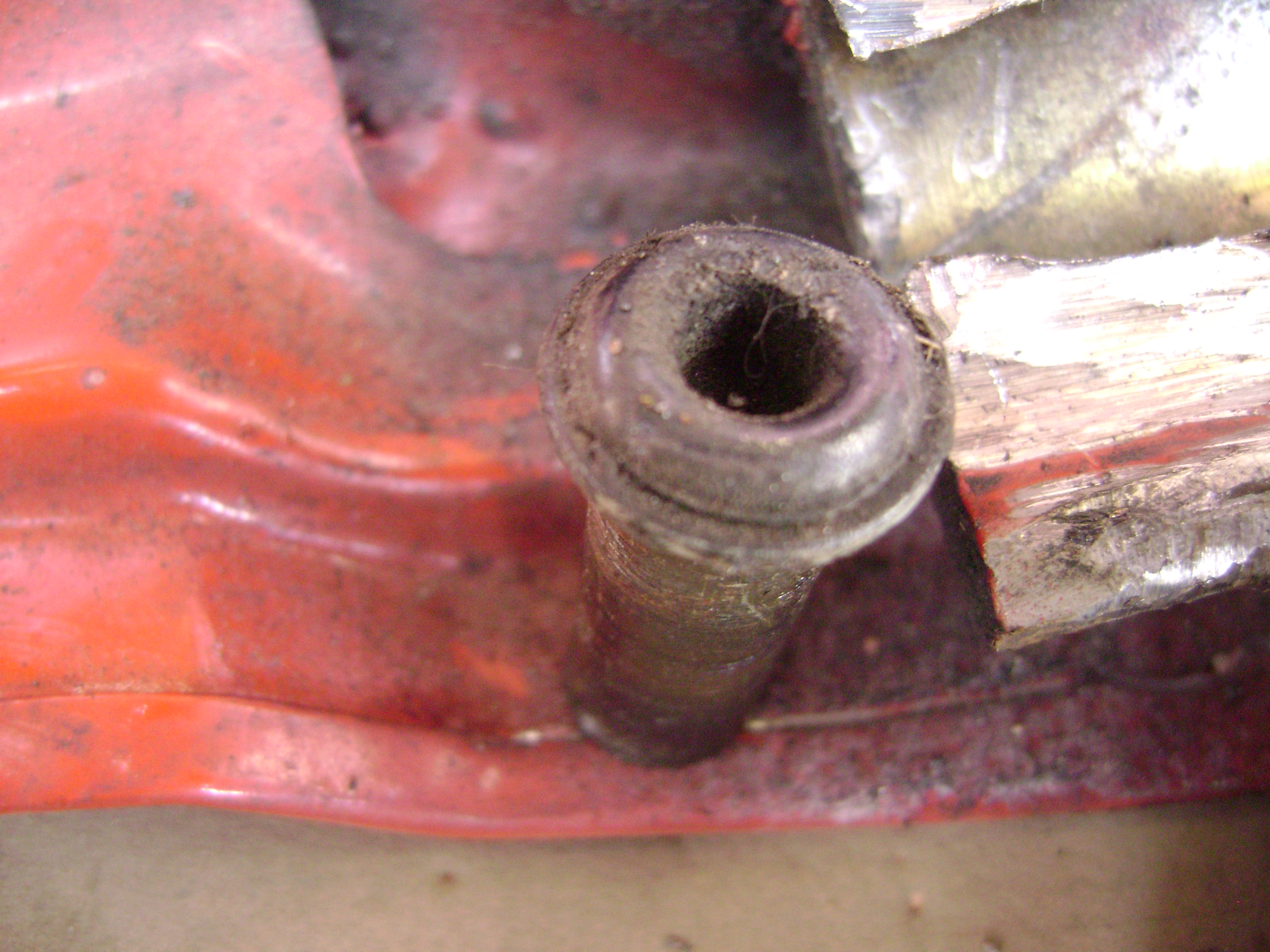

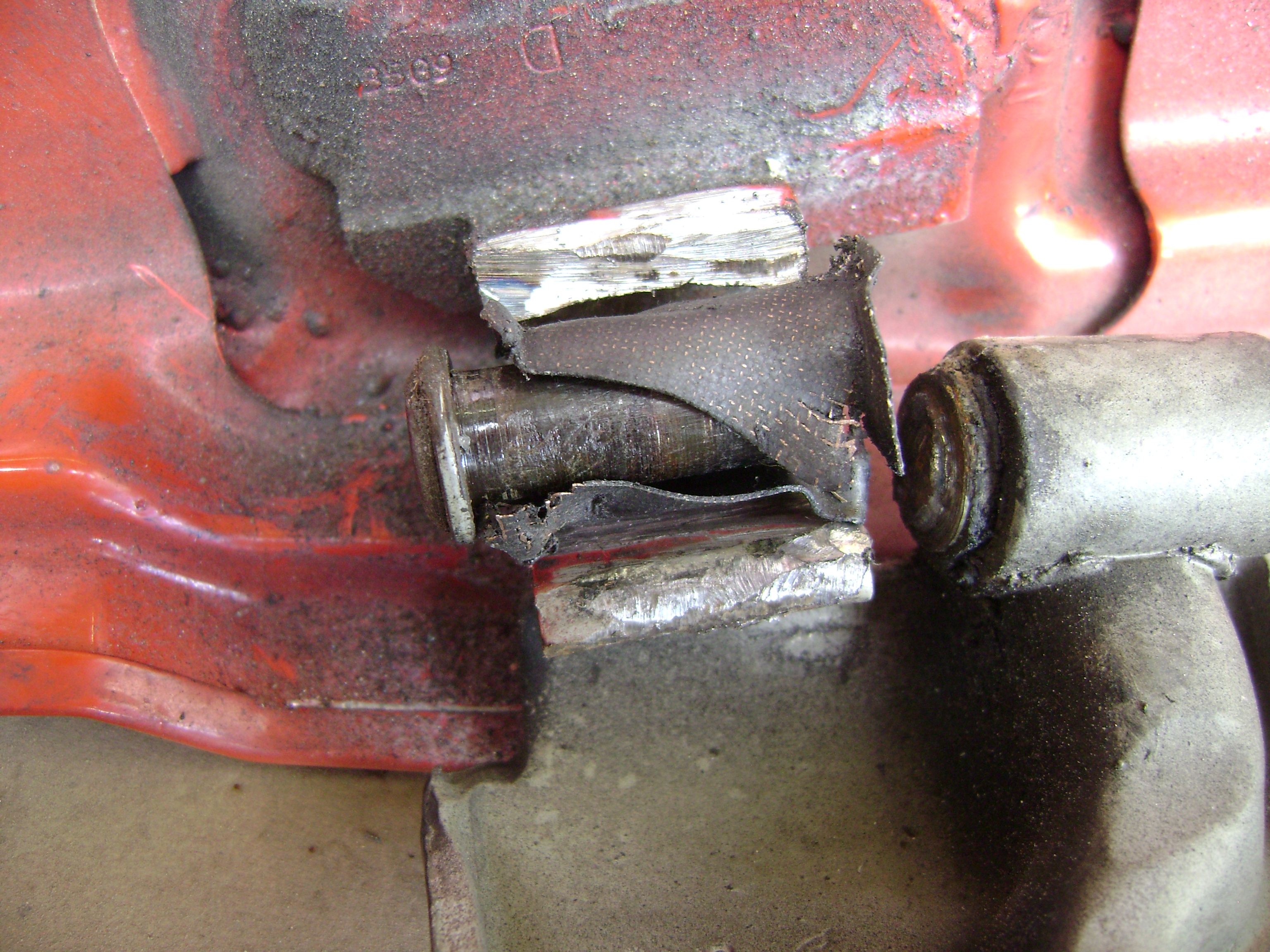

oonce pin out you can see it sits in either a brass gauze sheaf (early doors) or a plastic sheaf (late doors)
i tapped upwards with a punch on my broken door to remove the snapped pin and on my new pin i ground the end off so i could hammer it upwards into my broken door,once in it cant go anywhere
so job done
i used a rear 5 door b post hinge to connect to my a post as this obviously gets less wear in normal useage
