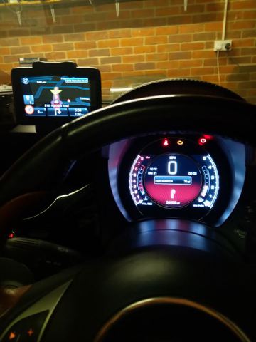

You'll then be able to pair with Bluetooth in the normal way, and when connected you'll be able to see fun things like directions on the speedo, fuel consumption on the satnav, etc:
