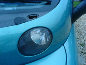

Just above the main beam light you will see a black plastic oval shape.
Remove the black cover with a flat screwdriver.

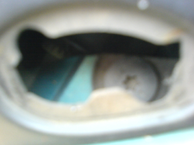

Remove the lamp assembly retention screw (torx bit or 4mm alen key).
as shown below
The main beam assembly will now slide forwards so you can replace the bulb
