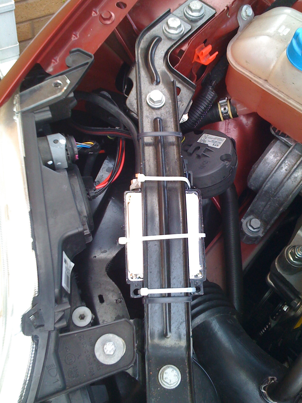

Take one of the supplied Ballasts and connect the dual connector making sure the black is lined up with the negative position on the ballast!!. Now connect the positive and negative to the correct wires to the rear of your headlight, making sure that they are secure.
Attach your ballast with bolts or zip ties to somewhere pretty in your engine bay!
Repeat for the opposite side.
