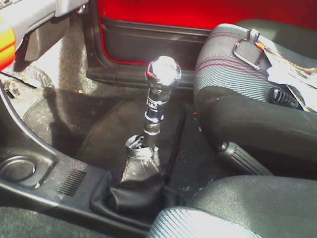

now with the omp adapter fitted you can see how the gearknob will fit
now screw the gearknob on ensured its securely fitted and the shaft nor adapter do not move.
heres a fitted OMP gearknob and adapter
here it is with the gaitor refitted.tidy up the car and ensure you can select all gears including reverse.
make sure the gearknob assembly is secure and wont move.

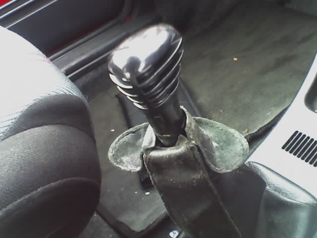

below shows the sparco knob fitted.
i actually shortened the central gearshaft and as you can see fitted a different gear gaitor
