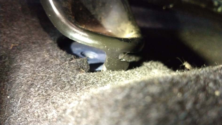

Once all the bolts are out, adjust seat to middle position, and there is just one latch to unhook the seat runner lower frame from the bodywork.
This is underneath the front inner bolt foot on both seats. You need to wiggle the seat, forward and upwards at the same time.
This is the latch with the seat out. Under the foot.
This is where it latches to the car on the passenger seat inner front bolt foot.
When assembled it is under the carpet so it is not so obvious unlike in this photo.

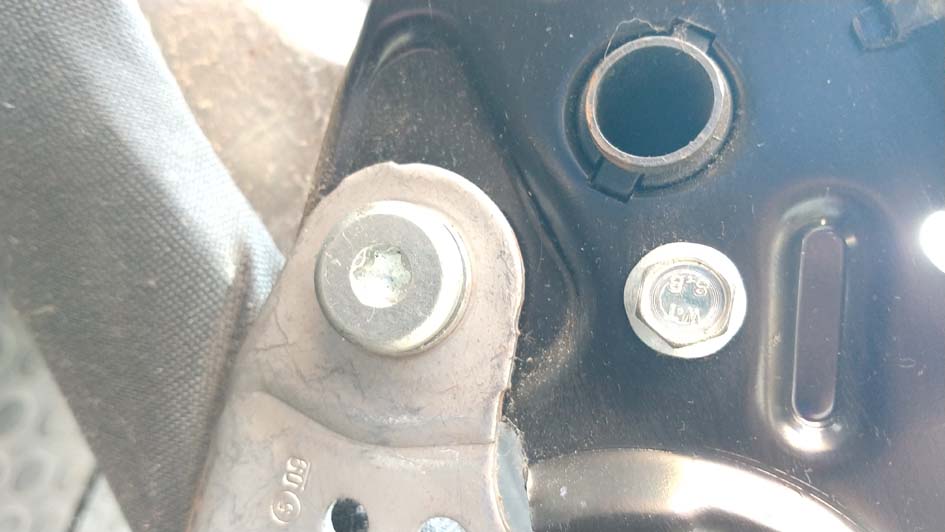

Outer side T50 in centre. Note short backrest adjuster rail sticking out.
T50 to left and and one 13mm seat bolt to the right. Note the hollow tube above the 13 mm bolt is the outer end of the cowhorn parts. See below.
Second 13mm seat bolt at the front end. Note the hollow tube above the 13 mm bolt is the outer end of the cowhorn parts. See below.

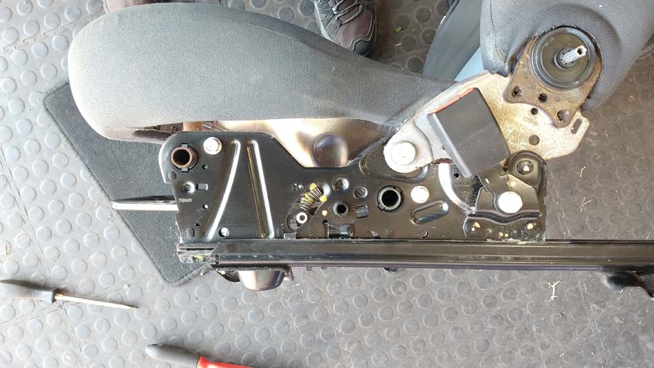

Inner side with seat belt buckle. Note long backrest adjuster rail sticking out.

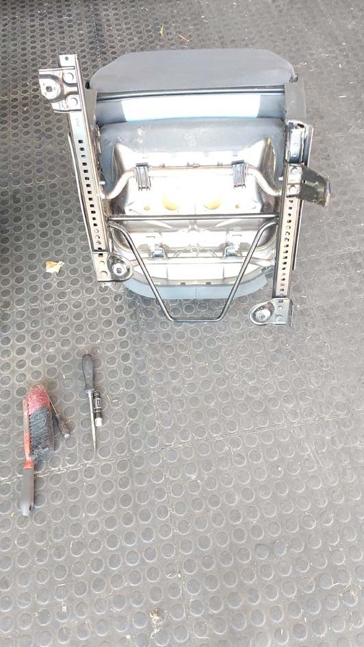

6, Undo the four 13 mm bolt, two each side and then both lower runners can be pulled off the seat.
See photos above in section 4 for their location.
There are both ends of the two silver metal cowhorn bars and the longer thinner black seat adjuster with two parts each side to pull out.
