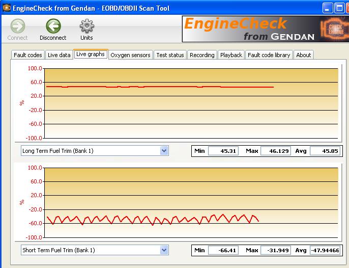

But to make sure I wasn’t fooling myself I looked at the LTFT and STFT now.
![fuel trimsw imm after treatment warmer engine 2.JPG fuel trimsw imm after treatment warmer engine 2.JPG](https://cdn.fiatforum.com/data/attachments/67/67430-cb916a9ddad93682f6e72248b5afa72d.jpg)
Now the STFT was saying “Whoa! Way to much fuel going in now” LTFT is on + 45% and STFT is compensating frantically, pulling it back and going down to -60%
