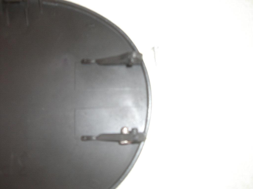

The flap is held on by two pins, one is metal, the other plastic, no prizes to guess which one breaks

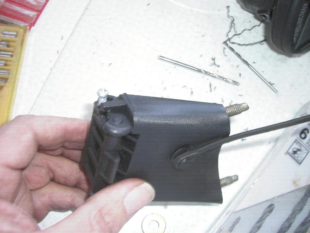

File flat remnants of the old plastic pin then choose a suitable size self tapping screw and carefully drill a small pilot hole and make sure it's going in straight. I found it best to keep drill steady and move the hinge onto it by hand with drill at VERY slow speed. Then with drill of right size so screw will grip well carefuly drill to actual size you want and slightly deeper than the screw depth
Screw the screw in to cut the thread and make sure it threads in straight
Now reassemble everything and remember you want the screw tight in the thread but not tight on the hinge as it is a hinge. Reattach the spring and reinstall
