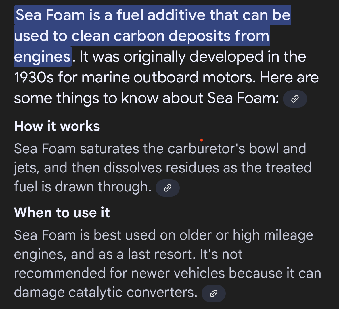

Having never previously heard of Sea Foam, I looked it up. Not recommended for modern engines… here’s the AI search result. It’s not likely ti be the cause of your issue, but also unlikely to help fix it in any way.
To be fair I’ve used it a few times on more modern vehicles and found it very effective. Seems to be anything you put through a car nowadays other than pure fuel can “damage the catalytic converter”
