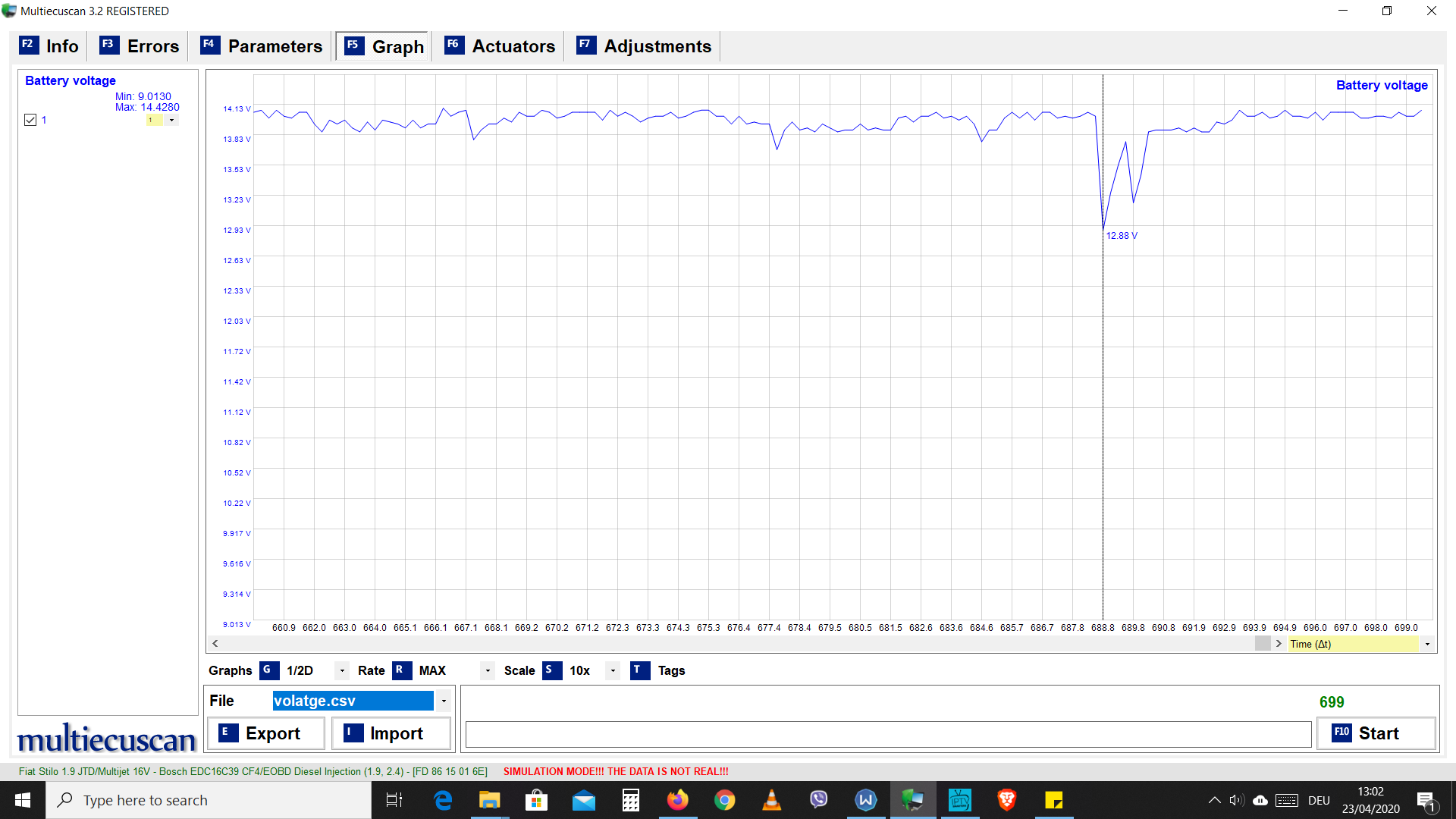

I am getting a regular ASR/ESP Failure warning and the fault code U1601 C-Can Line Error which yesterday was Fatal Light On. So far I have cleaned the Terminals and tested the Battery 12.47 V with the Engine off and 14.03 V with it running, which roughly corresponds with what Multiecuscan says. Tested the earth as well but it was a low reading 0.02 if memory serves me correctly
