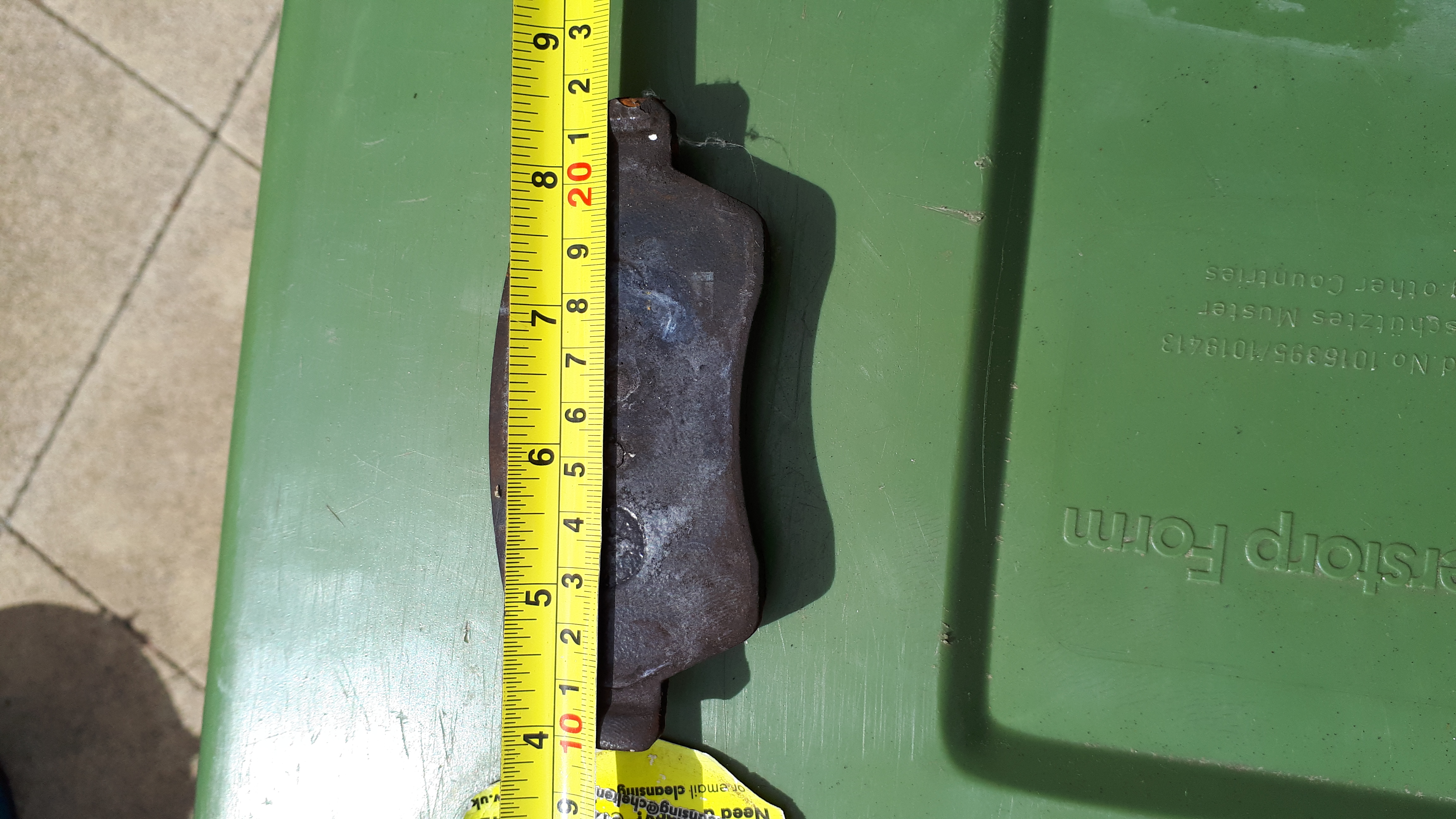

This is an example of what I mean by measuring across the pad ears.

Your pads should be 137mm long
If they are not 137mm then you definitely have wrong pad carriers , if wrong pad carriers likely the wrong calipers also wrong.

From top of the pad clip thingy which was at 10cm to the bottom clip thingy which was around 24cm. In total that does get us to around the 137mm.
Please let me know if this is correct or not!
Good effort on measurement and getting girl friend to help :)
In pic it looks like tape showing 9.5 at clip thingy
And bottom clip thingy looks like 24
So could it be 145mm ? Could easily be camera angle .

I have had chance to take closer look at your photo of measurement of pad width.
It does look like about 137mm.
That's good news as makes next step simple . Order brembo pads p 23 137
When they arrive ask your garage to try to fit them , saying if they can't fit them please can you have photo or drawing of why they don't fit.
