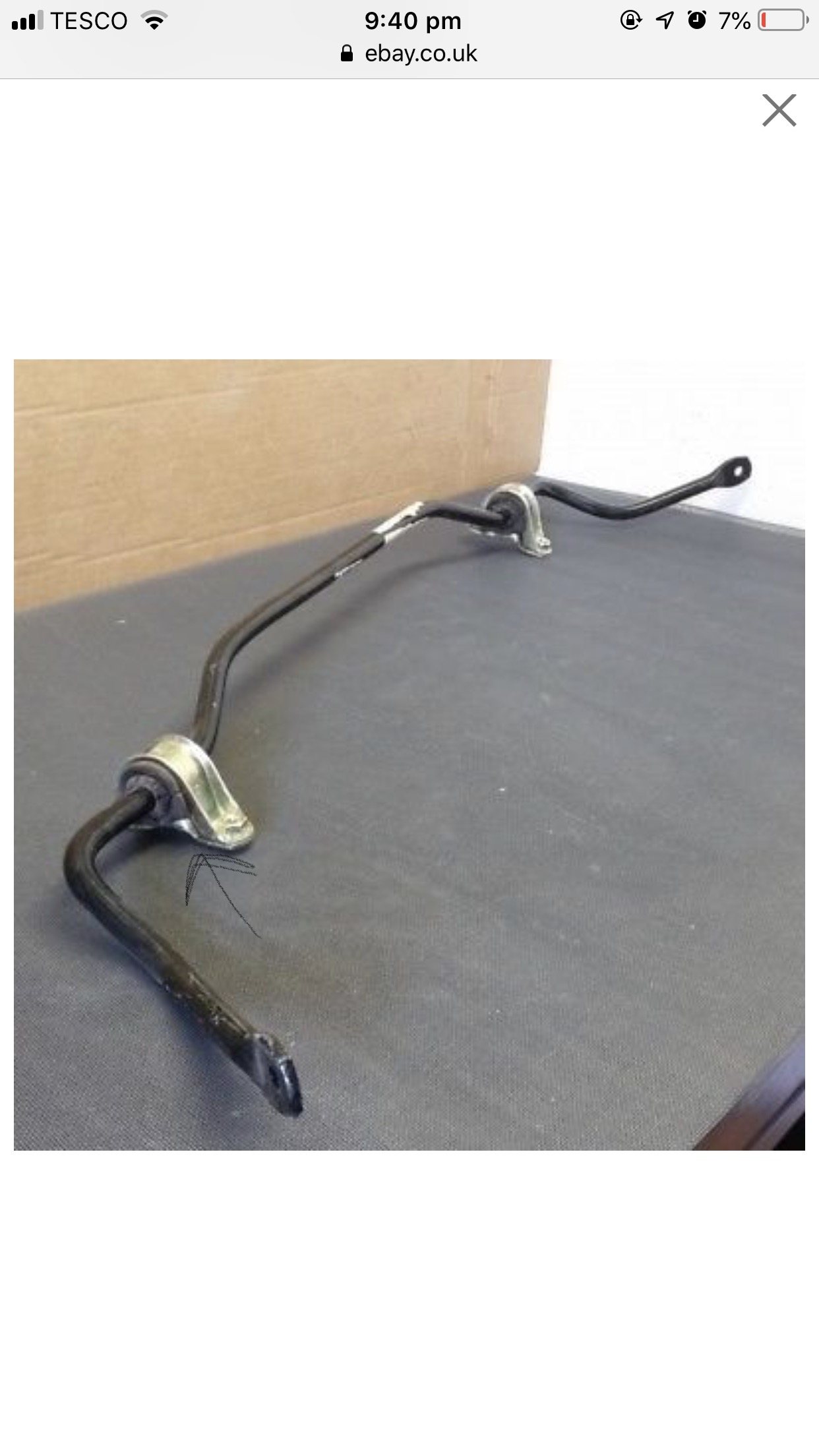

Is it possible to do each side bush of the ARB at a time with removing it completely? Is the spot weld under each bolt hole of the mount holding the bush onto the bar as in this photo? It sounds difficult, may need to get some help but I asume once separated the mounting bolts hold it all back together?

I changed ARB bushes, holder is not spot welded, its pressed around nuts one piece with other
I had one anti roll bar from Delta 2008., so i could dismantle ARB holder by drilling nut seat. Dismantle holder on car id rather difficult, as said, chisle and hammer. Anti roll bar is not round on place where ARB bushes are, it id "side pressed" and dimensions are 16x21
SO you need, 18-19mm center hole bushes
