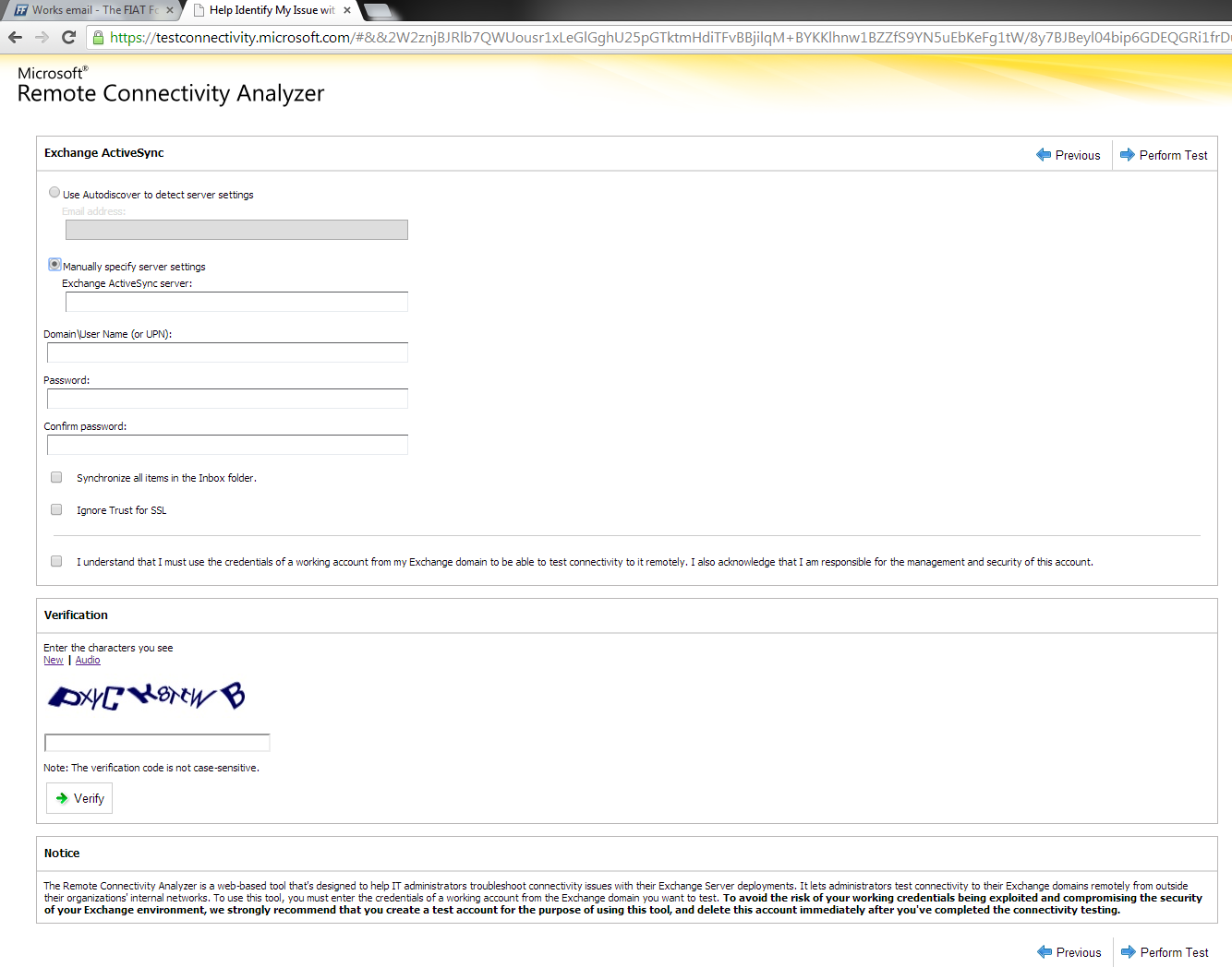

https://testconnectivity.microsoft.com/
Enter your details into that and it will tell you if Activesync etc is enabled and working. You will need to know your works "LAN" domain name. Usually "<domainhere>.local".
If Outlook Web Access is enabled and working over HTTPS / Port 443 I'd bet my bottom dollar ActiveSync is too. Someone would have to go out their way to disable it...
The Microsoft Connectivity Analyzer is testing Exchange ActiveSync. The Exchange ActiveSync test failed.
Additional Details Elapsed Time: 5238 ms.
Test Steps
Attempting the Autodiscover and Exchange ActiveSync test (if requested). Testing of Autodiscover for Exchange ActiveSync failed.
Additional Details Elapsed Time: 5237 ms.
Test Steps
Exchange Web Services synchronization, notification, availability, and Automatic Replies. Not all tests of Exchange Web Services tasks completed.
Additional Details Elapsed Time: 6144 ms.
Test Steps
The Microsoft Connectivity Analyzer is attempting to test Autodiscover for ..... Testing Autodiscover failed.
Additional Details Elapsed Time: 6141 ms.
Test Steps
Additional Details Elapsed Time: 123 ms.
Test Steps
Attempting to resolve the host name ************ in DNS. The host name couldn't be resolved.
Tell me more about this issue and how to resolve it
Additional Details
Guess I need to confirm server details
