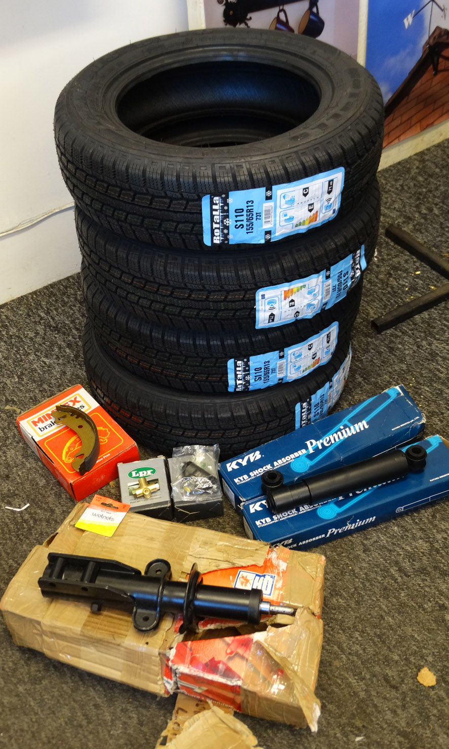

Hello all,
So finally after buying the car in March to allow a year to fix it up and drive it to iron out any faults before our planned road trip I have now spent a day actually working on the car!
A few bits and pieces parts wise have started to arrive, I've got new shocks all round on the way, new tyres, new rear brake cylinders, hand brake cable, brake shoes, rear springs and I' ve spoken with Big Mick regards getting some rear trailing arms sorted, just need to see what else I'll need from him so I can save on postage (same price for anything up to 20kg and I know I'll need some more bits as I head forward).
Apologies if the photos don't work out initially, this is the first time I've uploaded photos on to any forum let alone this one so if it has worked first time then that would be quite a suprise.

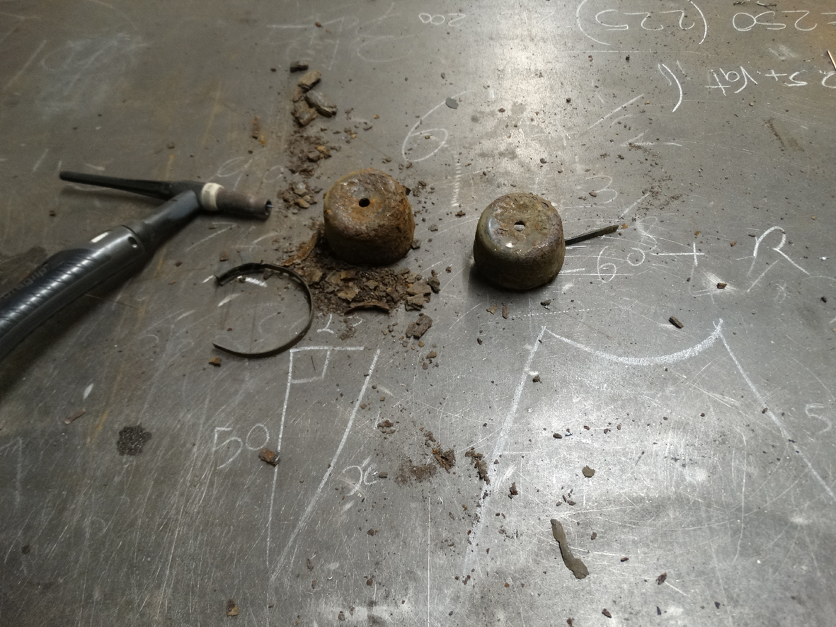

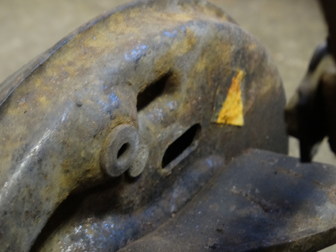

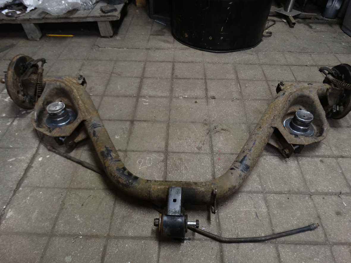

Starting with one of the known faults, having removed the rear axle this is how the spring cups appeared...
showfull.php

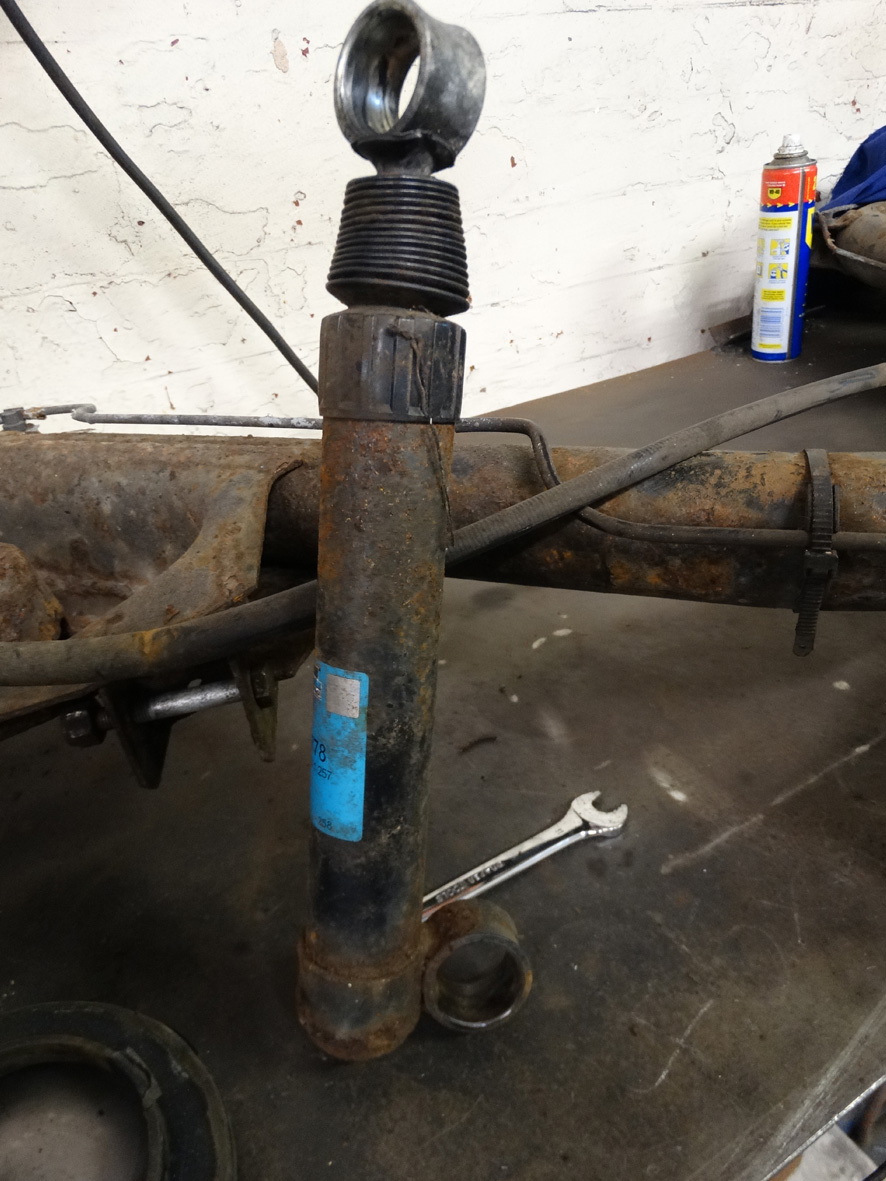

Other repairs required include new shocks & springs, I think to test a damper you press down, it should offer up resistance and then return to it's original length... well the image below is the shock about half an hour after compressing it and leaving it on the bench!
showfull.php

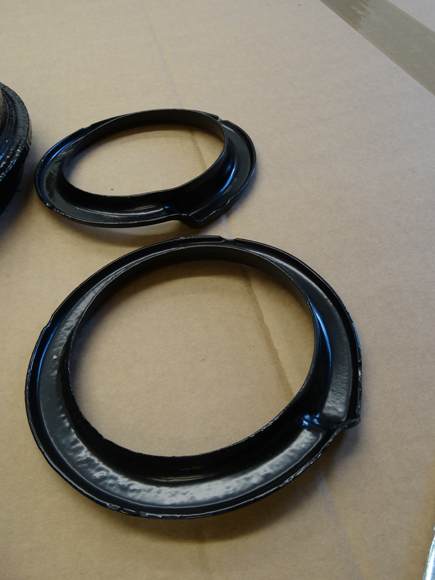

So on to the task for the day, fabricate and fit new spring cups. I had a good look through the forum to see what others had done and got a load of useful info. Looking at what was left of the original spring cups the 'top hat' parts themselves had rusted through, the actual main pressed steel part on the axle was only lightly rusted so I recon they have gone where water has become trapped between the spring mounting rubber and the top hats. Thinking about the best way to avoid this in the future all I could work out was thicker steel and as good a paint job as possible (more on the latter later). I didn't really want to drill the top hat parts themselves as one hole would probably achieve very little, as once the weight of the car is on the spring I doubt water trapped could work it's way around the brim of the hat and many holes would clearly weaken it. I initially planned to fabriacate a cone at the correct angle, then I realised this would be fiddly and seriously limit the thickness of steel I could use. Instead I decided for the bottom part I would just forge a piece of 25x5mm flat bar into a ring the correct diameter (so as to be snug in the rubber spring mount) then fabriacate a little cone on top of that. When I measured the height of the original 'top hat' (or what was left of it) I realised that the cone section would be pretty pointless, so instead just forged another ring slightly smaller to fit on top. Stupidly I forgot my measurements and forged this one out of 20x3mm flat bar so the overall height was 10mm shorter than the original. Unsure as to how critical I angrily forged yet another ring 10x3mm and welded that on too... it soon started to look a bit like a wedding cake rather than a top hat :mad:. Still eventually I was happy the dimensions were correct, welded convex tops on them (with 8mm hole drilled in the centre as per the originals) and plasma cut the polo shaped bases out of 3mm mild steel (again thicker the better for rust I recon).
showfull.php
showfull.php
I was originally going to keep all the bits I'd taken off the car until it was finished as a record of how much has been replaced but I think these bits can probably go straight into the bin, loads more of it all over the workshop floor!
showfull.php
Now clearly at this point I've got masses of work to do but any pointers from the Panda Pro's on here would be great. Two things coming up which I really could do with some help on are:

Just on the dampers, they should offer resistance both ways (stiffer on compression than rebound I think) and feel even both sides. They will only re-extend themselves if they are gas shocks which the Panda ones aren't as standard so staying put after you've compressed them is perfectly normal.
Having said that they're not pricey and freshening them up along with the bushes probably isn't a bad idea anyway while you're on down there.

Ah so maybe the shocks are not so bad! Still it was last MOT'd about 2 years ago and got an advisory on a front shock, I got what I think/hope was a good deal on a set of four and as you say while I'm there might as well get it back to spec :) I've not had a look at the front ones yet but can see over the wheel that one of the rubber bump stops on the front has duck tape around it! Got new springs for the back too as the ones on it are heavily pitted and again not too pricey.

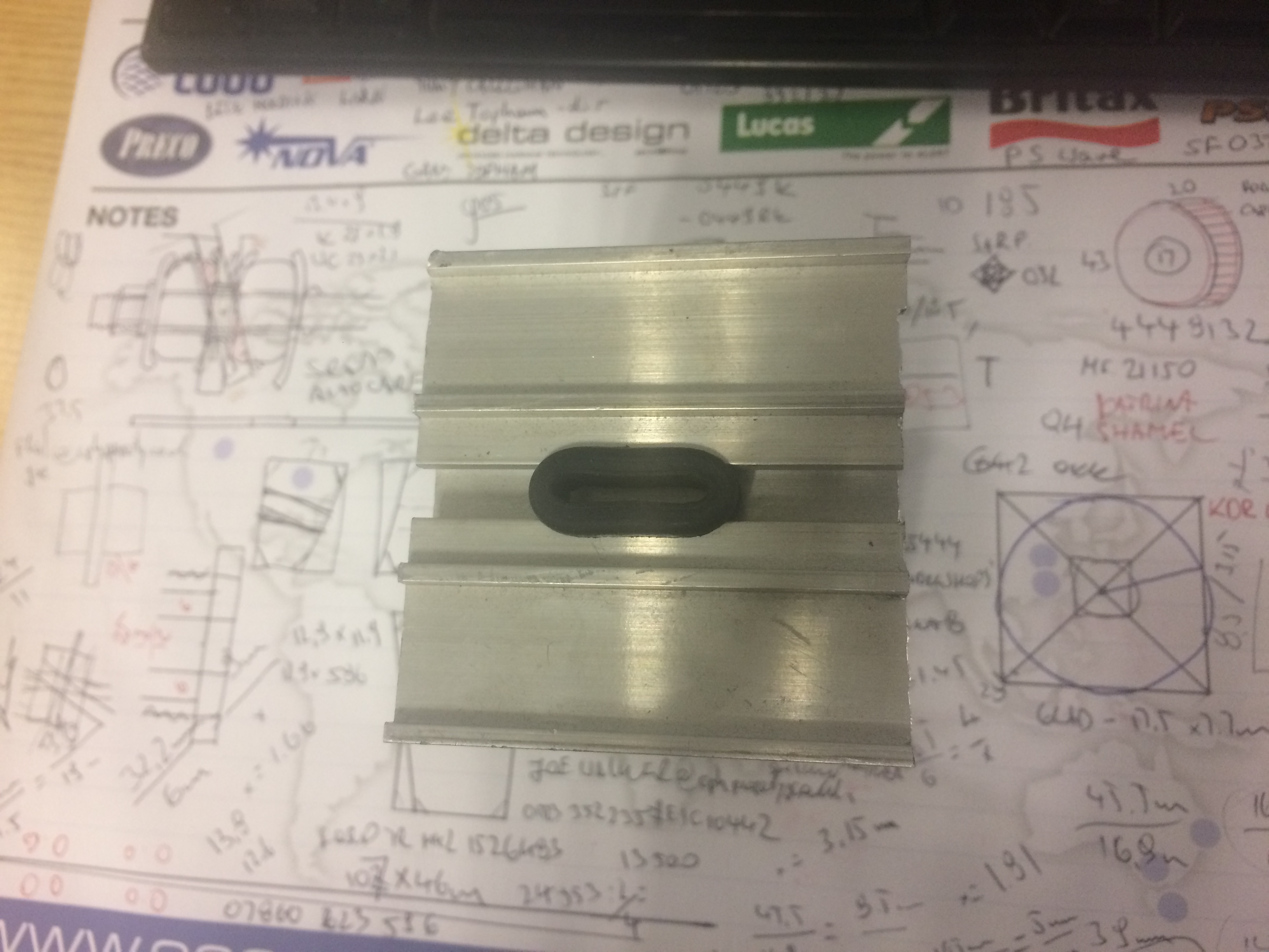

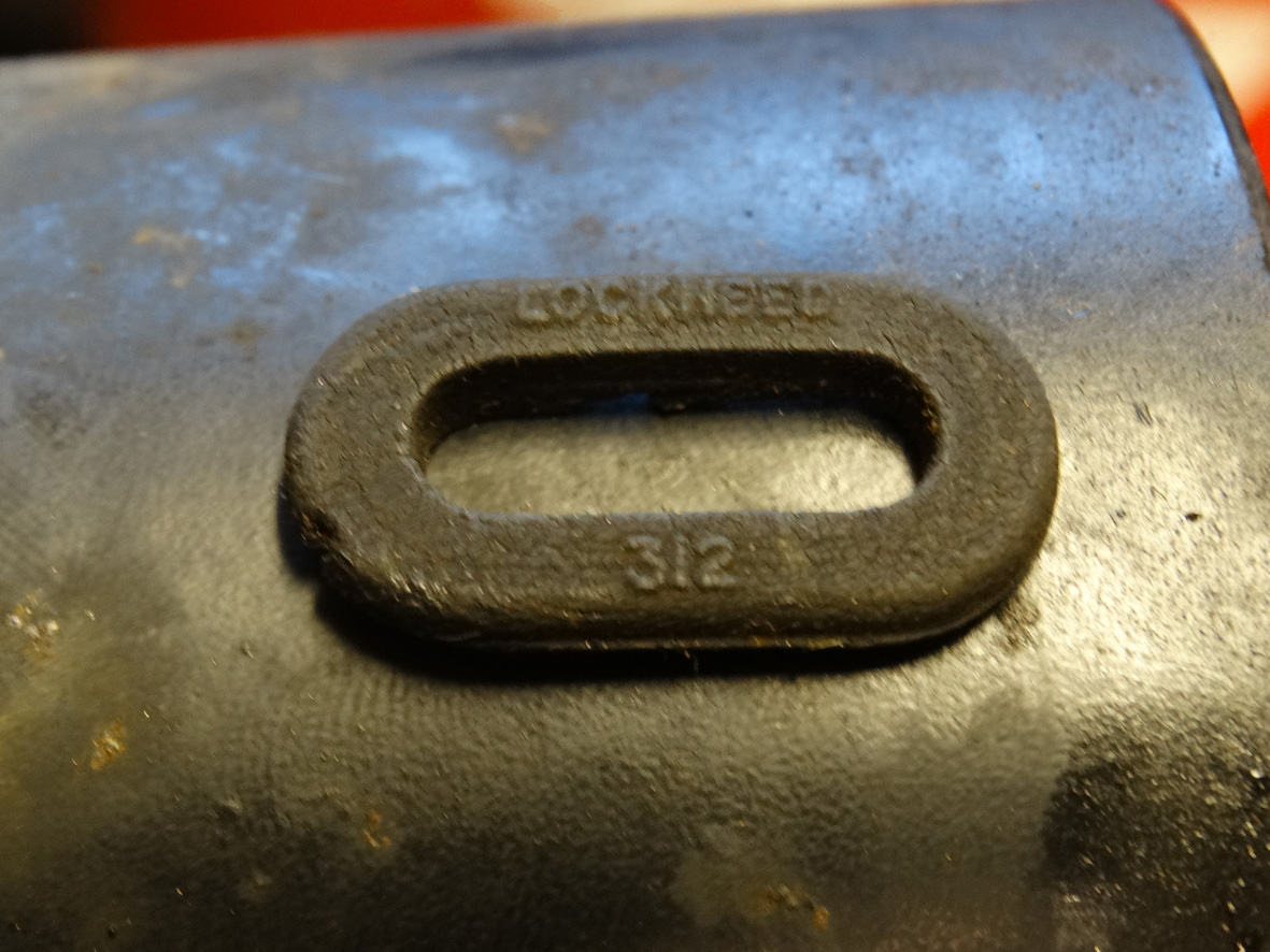

Bit of a strange issue has come up though, there is a small rubber grommet/blanking plate thing on the back of each brake back plate... least there should be. One of them was nearly in one piece, the other one I've only found half of! I spoke to Big Mic at Euro parts and he checked and Fiat only sell them in packs of 5 (despite the car only needing 2) which are about £18 for the pack!
So does anyone know anywhere anything suitable can be purchased (Mini's might have the same thing??)?
Has anyone bought a pack of five and might have a couple to sell on?
Does anyone need any, might want to split a pack?
Finally alternatives to the elusive grommet:
-My mechanic friend said just leave it off, it'll do no harm if a little muck gets in or if I'm really fussed stick some tape over the hole (surely it'll get a bit warm for duck tape there??).
-I could weld it up but then do I need the hole for any reason, plus the paint around there is not that bad so I don't really want to mess it up and have a potential rust spot.
-Fill it with high temp. silicone and effetively make a new blanking plate, to be replaced whenever I next need to remove it.

Thanks Kolza but I've tried googling it and it seems if I wanted a thousand importing from China I'd be sorted or if I was in the USA or Australia they would only be a few pence but I can't find anywhere in the UK that are actually selling them :confused:
Thanks Kolza, the hole is about 10x23mm. I emailed Essentra and they basically said they only sell in bulk so no glory there. I guess I've got a little time to source something as clearly got a bit of work to do before I have to worry about road grit getting in :).

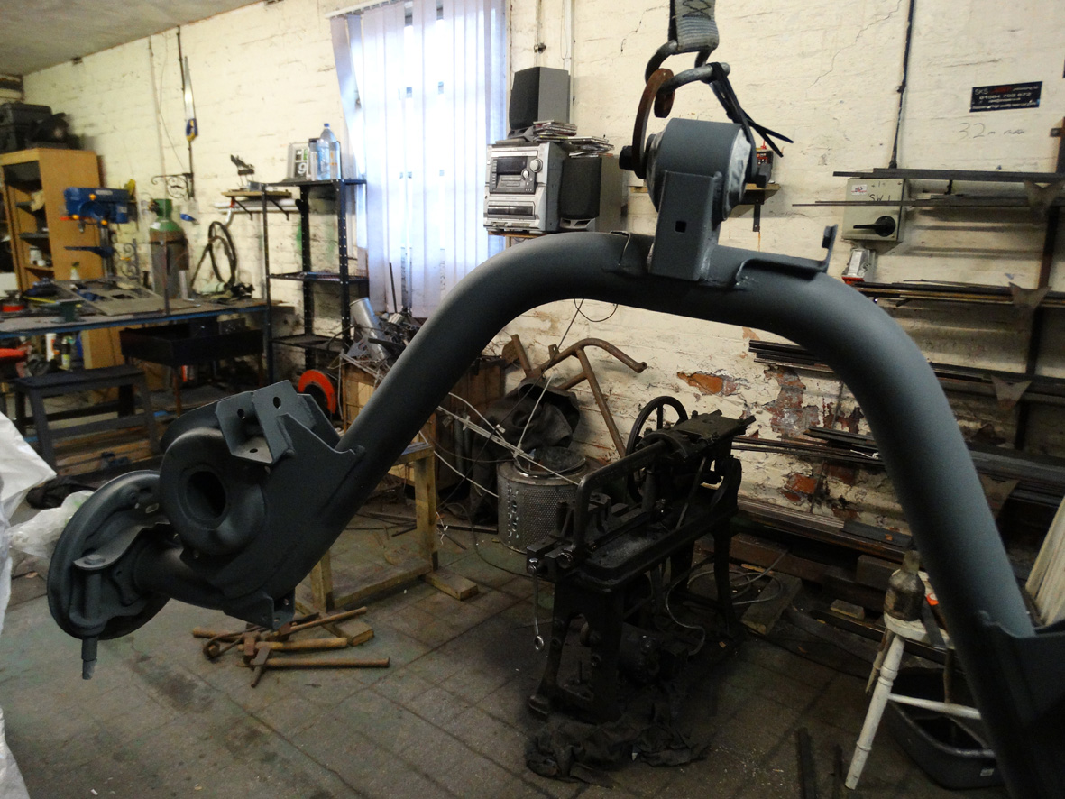

Managed to pick absoutely the worst conditions imaginable for painting, freezing, damp and dusty but think I've done a reasonable job! Got a tip off the web to sit the spray paints in warm water for 30 minutes before using, definitely the way to go, I missed a bit of primer and went to spray a little extra on about half an hour later, by which point the can was cool and it splattered paint all over the place! Not sure anyone will ever notice once it is under the car though! I did manage to get a few photo's and have then left my camera there so sadly nothing to report image wise just yet. We've still got no internet at home but we'll be joining the 20th Century in about a week with fibre broadband etc.
So most of the axle is now painted (left the brakes assembled on one side so I can refer to it while sorting the brakes on the other side) and just started cutting and bending the new brake pipe today.

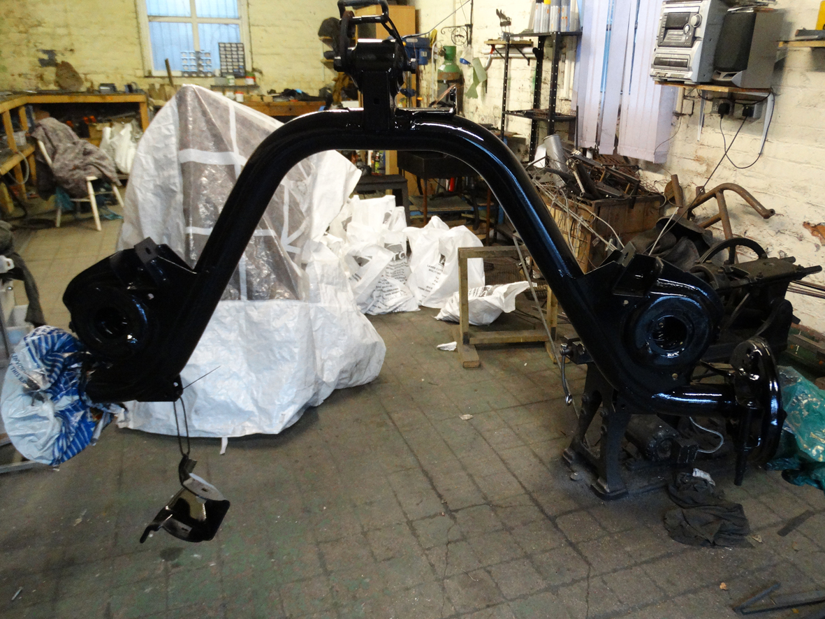

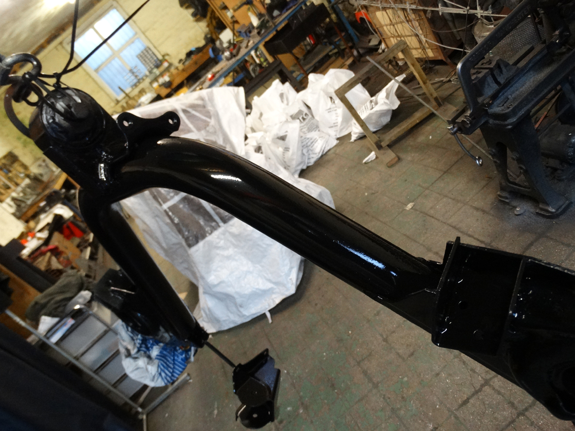

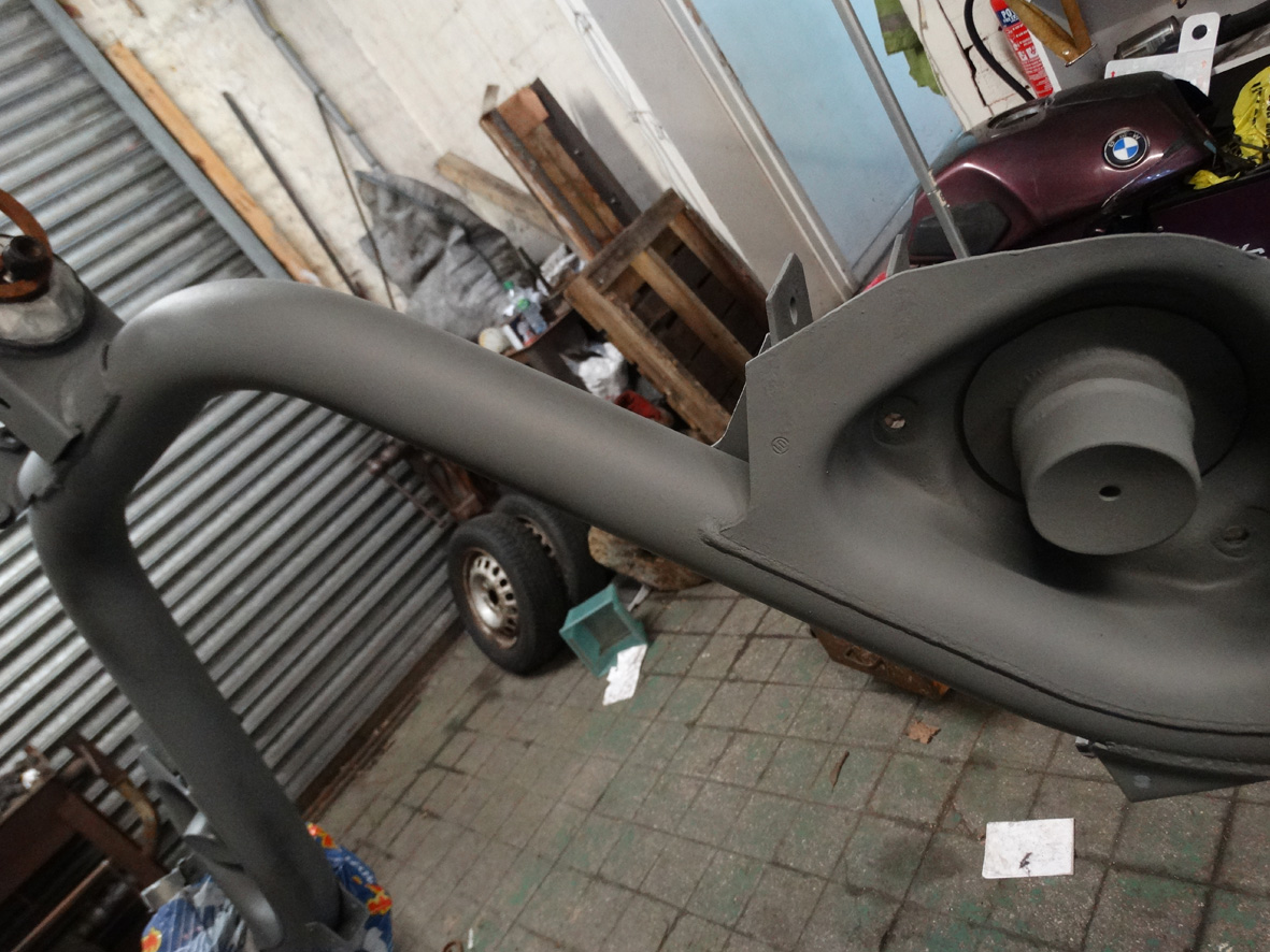

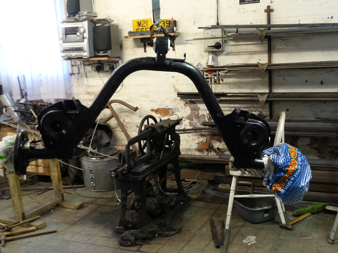

So finally the planets have aligned and I have time, the laptop and internet access all at the same time!
Cannot remember quite where I was up to on this thread but after sanding and scraping all the loose surface rust off the axle and applying a coat of Kurust it took a few days to dry/cure due to the freezing conditions in our workshop! I then hung the axle from the workshop roof and got a good coat of Zinc primer over all of the axle (other than one end where I left the brakes assembled so I could copy them on the other end!) and one of the brake back plates...
I have since applied the top coat in gloss black (did consider bright colours but figure it's a black car I might as well go black all out) to all but the end covered by the farmfoods bag!

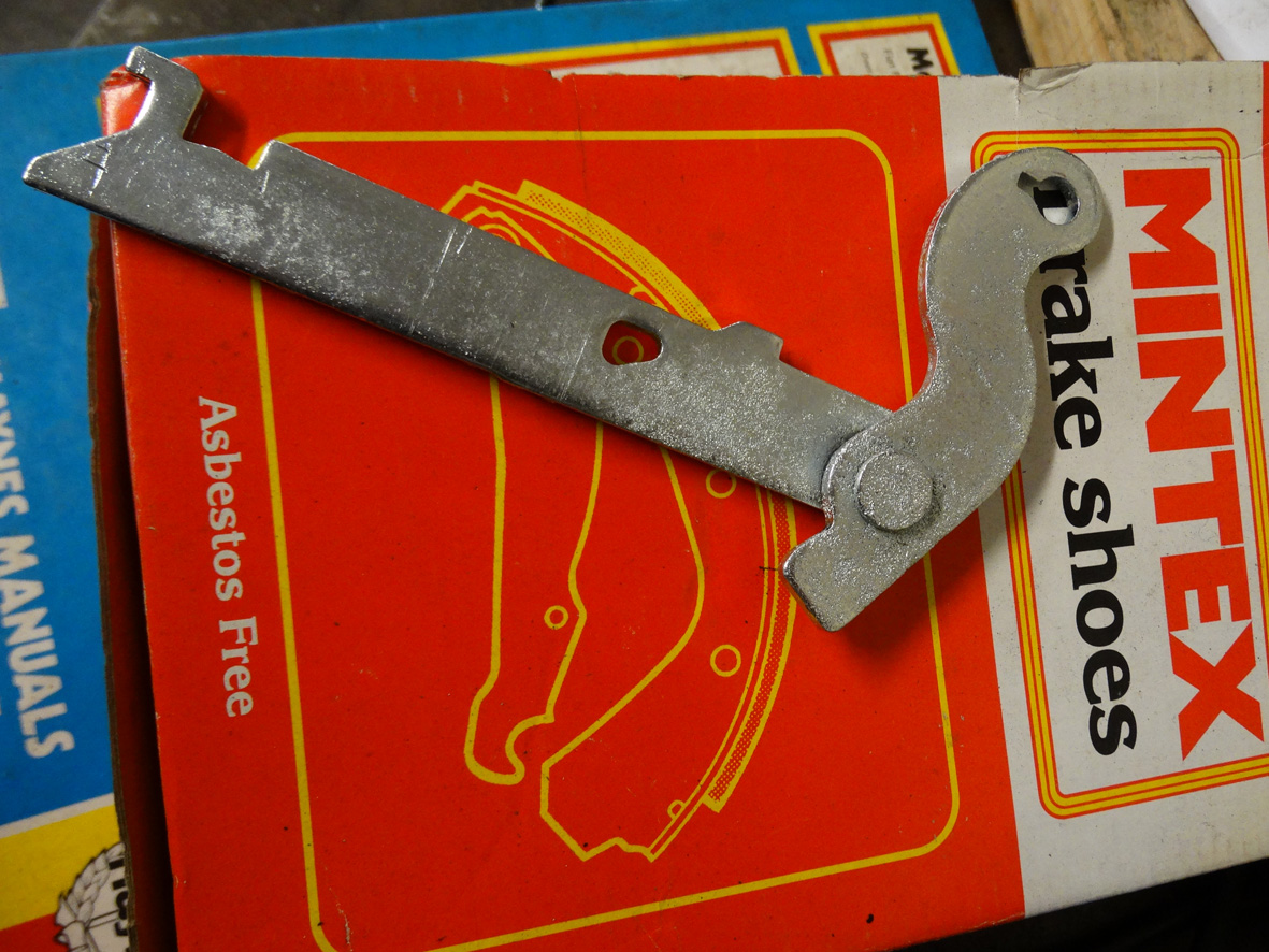

One other thing I did notice when taking the brake apart was that the handbrake release mechanism was pretty stiff. When driving the car to the workshop on the industrial estate with the ramps (to loosen all the bolts) I did notice the brake dragging a little so figured I'd clean it up. After spending a while scrubbing it with a wire brush it freed up nicely, but then I decided to take it to the electroplaters anyway and get it replated!
It was originally done in zinc and yellow (looking at what was left of the original plating) but due to a mix up at the platers it is now just done in Zinc, technically not as hard wearing as the original finish but given there was very little left of it it's definitely an improvement! I greased the pivot as the plating won't have got right in there, but just having it pickled in acid and clearing the rust will have worked wonders.
I finally managed to reassemble the brakes on the side I've repainted (again photo's to follow I'm afraid) with the new shoes and brake cylinder. Struggled for quite a while before finally my mechanic mate revealed the secret, attach the front brake shoe first (fiddly with the handbrake auto adjust cams) then pull the rear shoe into place on the springs. Once I knew this it was a 5 minute job (pity about the 30 minutes prior really!).
I've now stripped the brake on the other side, the handbrake mechanism is a lot looser but I'll get it replated anyway just so both sides are the same.
I'm really happy with the finish I've managed on the axle, my mechanic mate asked if I had got it powdercoated after all! Looking forward to getting to work on the rest of the car really, I recon if their was a concours event where you were judged just on your rear axle I'd be in with a shout, still it's whats underneath that counts, hopefully with some preventitive maintenance this will last many years!
Soon on to the tank straps and then finally the rust in the inner wheel arch and seat belt mounting point. Still can't get the old straps off (or whats left of them), I might just snap them off and put the new ones over the top!
Another point which I need to address is the heat proofing at the back of the engine bay is really wet. Not sure if I need to sort out possible drain holes in case water is gathering or if it is in part due to the rear of the car having been jacked up on axle stands for a few weeks? Either way it's causing the windscreen to get a lot of condensation on the inside and the actual heat proofing is starting to look a little ropey too :(.
Anyhow will hopefully report back soon with photo's of the painted axle and reassembled brakes, might even get some photo's of the remains of the tank straps so I can sort before and after photo's!

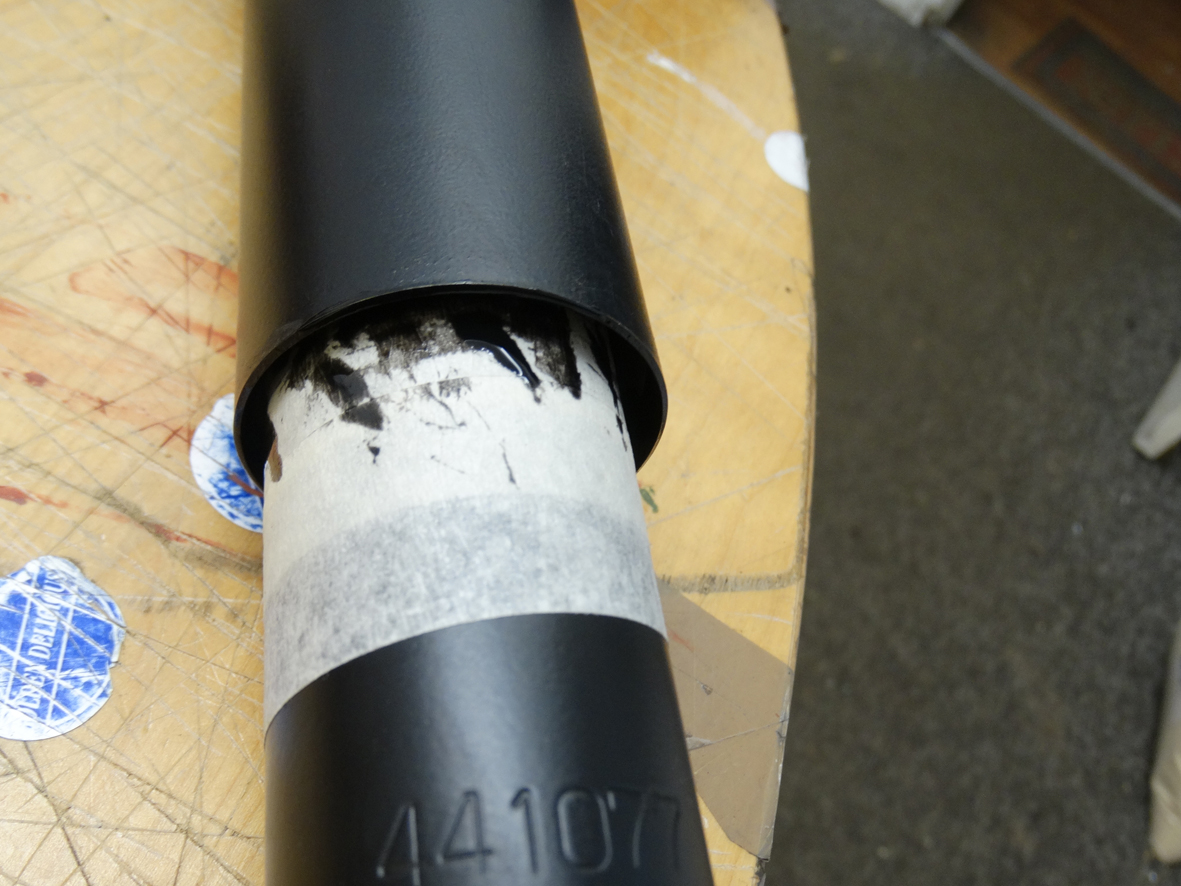

So I've finally got the final coats on the axle! I got a few runs in it now, which is a shame given how smart it was looking but I figured I'd get as much paint on it as possible and might as well use up all the paint, took 2 cans of zinc primer and 2 of gloss black...
It was freezing in the workshop again this weekend (snowing out) so I had to pre warm the cans of paint in a bucket of warm water, not sure how much trouble I would otherwise have had but it seemed to work a treat. Though maybe I should wait to say that in a few days when hopefully the paint will have dried!
While waiting for the paint to warm I had a look for some suitable stainless steel to make the straps for the fuel tank from and came up with this...
circumference of 130cm so fingers crossed I can do a good job with the plasma cutter and get some straight strips cut out! I think the longer tank strap is only around 110cm so should be ok. I've not got the old straps off yet, seems at least the one going across is attached to the tank?

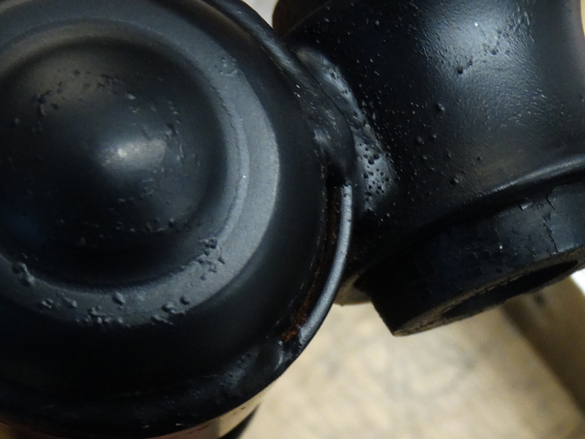

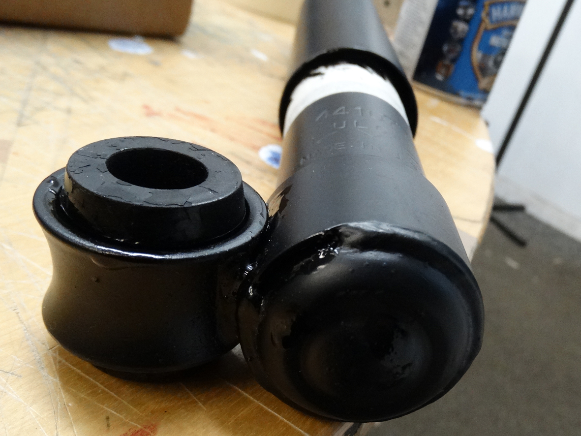

I also spotted some surface rust on the new shocks! I realise they're a pretty cheap consumable part for these but does seem a shame, looking at the old shocks seems they work fine but were very rusty. I've gone over the areas on the new shocks where the paint seems to be lacking. One thing I did notice was rust on the inside of the shroud part so I got some paint up there, all brush painted hammerite on these...
Not sure if you can quite make out the rust?

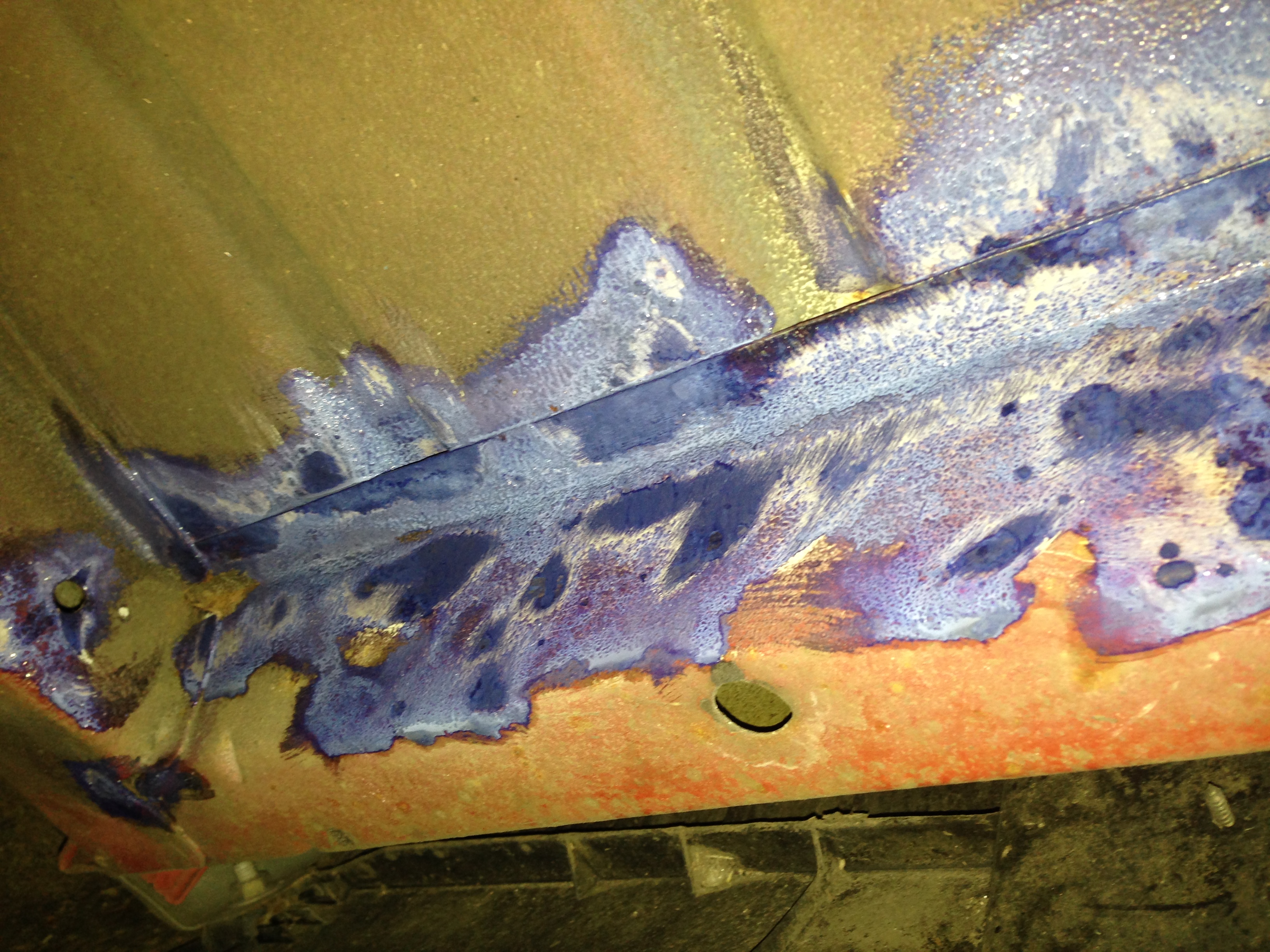

-Underseal/Waxoil, I realise there are probably a million opinions and methods on this. There is a fair bit of surface rust around the seems under the car, I take it remove what I can, kurust, primer then paint then waxoil or similar? Anyone have any views on best way to stop the rust in it's tracks? Also am I best leaving it until summer when the underside of the car can be cleaned and dried properly before applying the underseal or get it done now while the axle and possibly tank are removed??
As always welcome your thoughts and opinions, just feeling my way through this one at the minute, if I'm making a hash of something let me know. :)

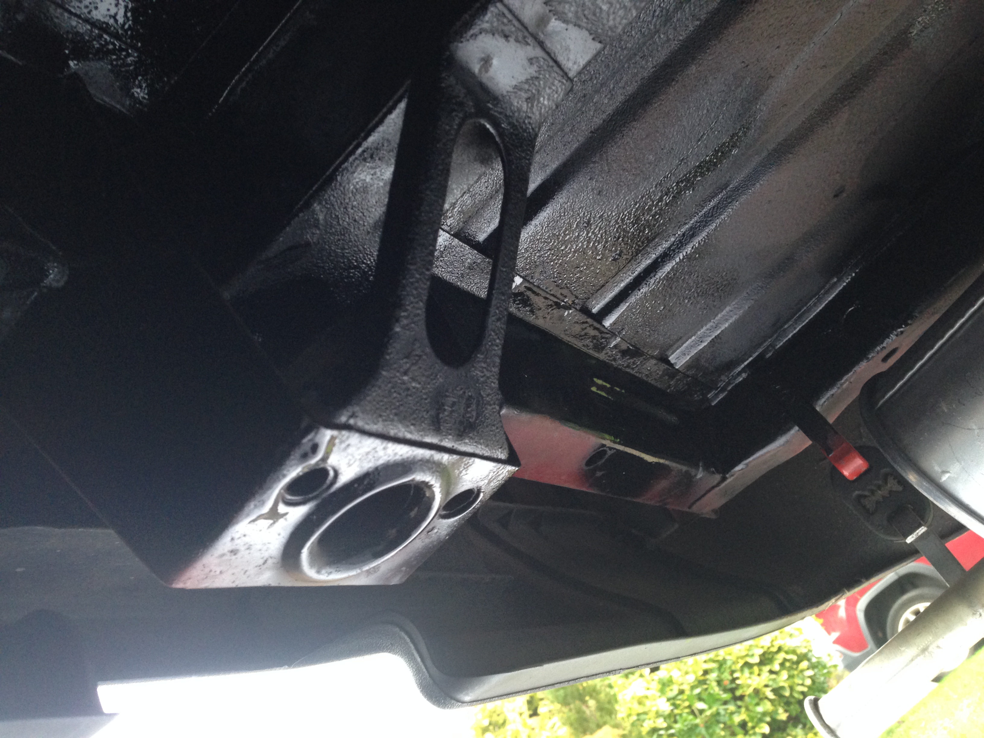

There certainly are millions of different opinions/methods to deal with surface rust. I had some on the underneath, right at the back of the car. Picture are attached of what I did.
Firstly, I removed what I could - depends on where it is on what you will use. Sandpaper, wire brush, or one of those wired discs that you can use in a drill. I used one of the wired discs to remove the most of it and used a wire brush to get into the bits I missed, then I went over with kurust. I didn't have primer but I went over in some good coats of stone chip shield and black paint, then waxoyl over the entire underbody when dry.
I heard you mentioned the seams underneath the car, be careful with those, there's not much of them, very thin! My other Panda is lacking the seam in places, and definitely needs some welding done...
I waxoyl'd in December I think, best just to get it on there. If it's on there then at least it can start protecting! I made sure it was clean and dry when I did mine, and it's still on there now so that's all good, but I do need to put some more in to the sills at some point.
Silver or white wheels, I'd say. My black car has black wheels and it just blends in a bit too much, so I'm getting them done either white, silver or a gold type colour. Though I am putting those particular wheels on my red car. Might go white, as I thought gold might be a bit too flashy? :cool: We'll have to see about that one, but there's some ideas (y)

Nice work FDNY21, I'd guess the rust I've got is similar to what you started off with, nothing that looks too serious now (other than where I know I need to weld up) but really want to get rid of it properly as I guess the next couple of years could be the tipping point on it! How long ago did you waxoyl it? Have heard horror stories about rust developing underneath that can't be seen but I guess it's all in the prep.
I realised after I put up the last post that I can't sort all the rust under the car while the axle is off as I need to put it back on in order to get the car in the workshop to weld up :bang: .

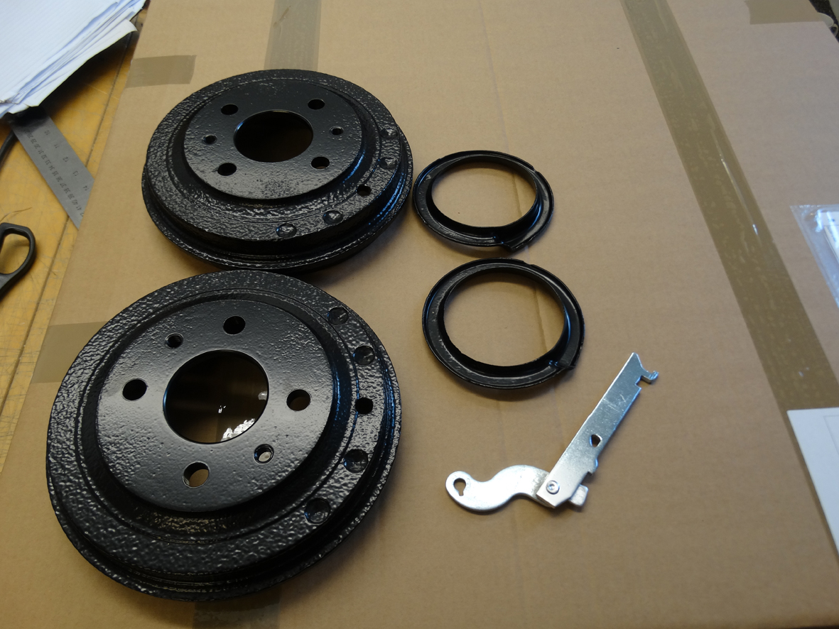

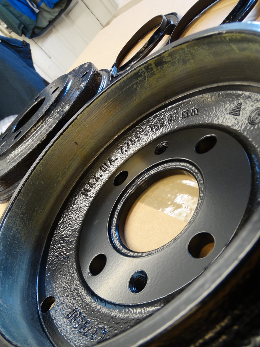

I picked up some bits from the electro-platers today.
The drums were a bit of a state (sorry no before photo but google rusty drum brakes and you'll get the idea). I was going to scrub them back and buy in some high temp. paint but took them with me to the elecroplaters to see if there was an easier way:cool:, turns out there is! There were some brake drums in there being done, turns out my local plater has been sorting drums for a local classic car guy for about 15 years. Effectively he pickles them in acid to shift all the loose rust, then gives them a long stint in the plating tank as the surface is normally too porous to take the powder without gassing off. Then he tapes off the braking surface and powder coats. The powder coat cures at about 180 degrees, hopefully that'll do for these drums? I guess I'll know in a year or so!
Hopefully just clean off the muck from the tape and they're ready to go. The zinc on the braking surface should burn off pretty immediately, hopefully before the MOT test station.
I also had the other hand brake component for the other side plated. Plus the metal parts for the top of the springs, which were originally zinc plated were pretty badly rusted, same process pickled, plated and powder coated, so hopefully marginally better protected than factory spec.

It's best to stop what you can rust-wise in its tracks to stop it from getting worse. I've done the underneath of mine and I'm currently working on one of the arches, luckily it's only very lightly gone by the looks of it. After that, I need to paint my seams and make sure they're all tidy, though I was thinking of leaving my door corners alone for now. Very light bubbling so I don't want to make it worse by bringing the paint away and possibly allowing it to go unnoticed under more paint.
If you prep well then you shouldn't have to worry too much about waxoyl making the rust go unnoticed. I left my arches for now because I need to treat one of them before the waxoyl goes on, but the doors and underneath have been coated. I hear that you're meant to re-apply every two years, maybe even less, something like that. So when you're underneath again, just keep an eye on the problem areas and if any rust does come out then you should hopefully see it. Make sure the waxoyl is room temperature (or even warmer if you're not using aerosol) and it should be thinner so you won't have such a thick coat to block your view when you need to inspect it. Remember that waxoyl may make it harder to work under the car though, just because it'll get on you, so maybe you'd want to finish up most of your work before you apply.
